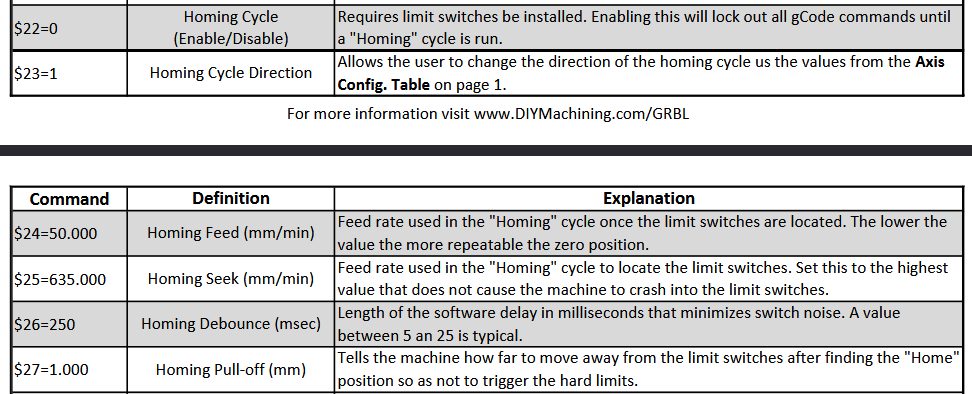

Have you increased the pull off distance to make sure your limit has enough space to disengage?
$27=xx , increase this value a couple mm at a time until it clears.

Well, I tried. I tested it with several numbers from 10 to 100. The greater the number the further the y axis moves (towards the front, where the on/off button is), but I still get Alarm 8. All the wires are connected. I’m guessing I might have to return the machine, right?

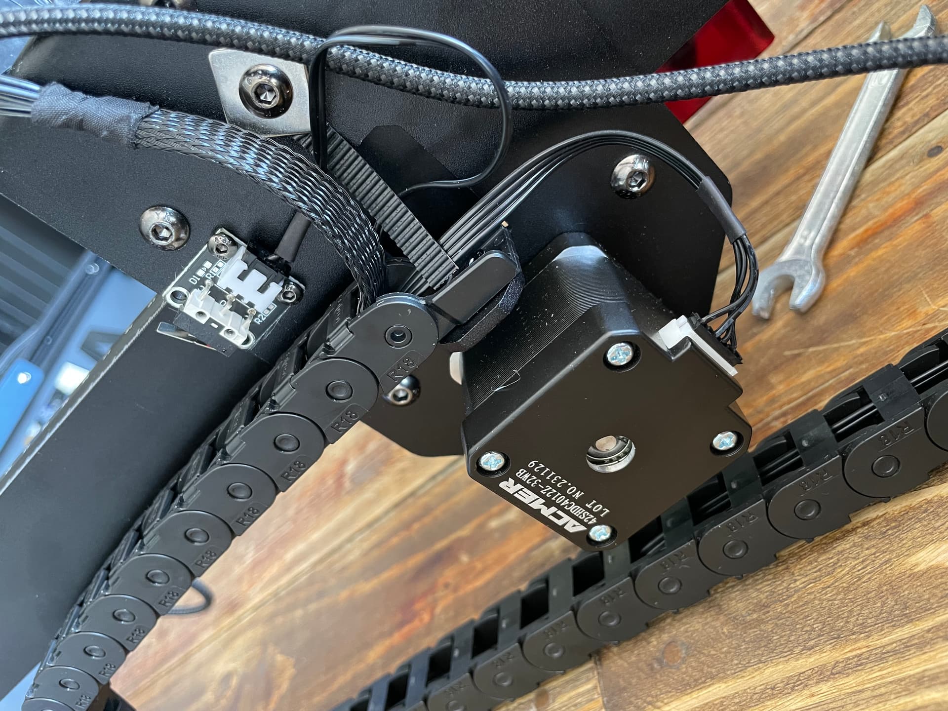

No, what happens is this: the trolley moves towards the switch, but the gantry, that’s when it gets weird: it moves only a little, away from the switch. It never hits the switch
here’s a link to what happens when I press Home on LB https://drive.google.com/file/d/1FwAhrR8PSQJ8dwR_eWUkQQCUWsHJuCXv/view?usp=sharing
OK, this goes back to what Melvin said about your switch being in the closed position. It thinks it’s already in contact with that switch, so it performs the pull off, but it never opens. Since you rechecked the wiring, I believe it’s time to contact the manufacturer.
Access denied on the video.
Thank you, @thelmuth and @misken for all your help ! I’ll be contacting the manufacturer (the video should be visible now, in case you’re curious)
I watched the video and I do believe what I described is what’s happening.
This looks like the switch is directly screwed to the frame. This can create a short circuit which activates the switch logically. Loosen the screws, put a piece of tape /plastic/cardboard behind it to prevent contact between frame and switch and fasten it again.
