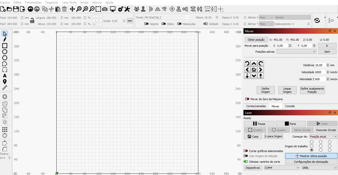

toda vez que começo a usar o lightburn a minha maquina atomstack a5 pro vai para o canto e começa a patinar, a configuração do lighburn no mover e obter posição estar com os numeros negativos. me ajude por favor
every time i start using lightburn my atomstack a5 pro machine goes to the corner and starts skating, the lighburn configuration in move and get position is with negative numbers.help me please

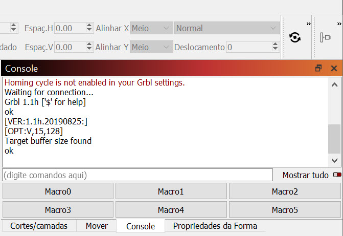

I would like to know more about what is happening.
Please copy and paste the information from the Console window into a reply here.

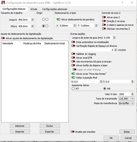

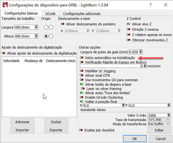

Your Atomstack may not have limit switches and if so, it should not be requested to home on start up. Please turn off Auto-homing on start up and retest at your convenience.

Console window:
2022-10-25_09-46-50 Console window (portuguese)

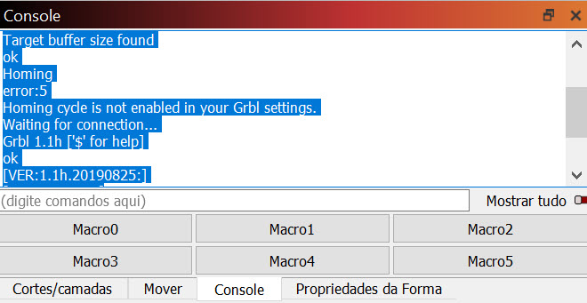

Select text from Console window. Scroll back from the error message to capture more context and understanding.
2022-10-25_09-48-51 select text to copy
Paste text in a reply. :slight_smile:
Target buffer size found
ok
Homing
error:5
Homing cycle is not enabled in your Grbl settings.
Waiting for connection…
Grbl 1.1h [‘$’ for help]
ok

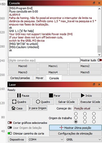

$H
ALARM:9
Falha de homing. Não foi possível encontrar o interruptor de limite na distância de pesquisa. Definido como 1,5 * max_travel na pesquisa e 5 * empuxo nas fases de localização.
ok
Grbl 1.1 [‘$’ for help]
[MSG:‘$H’|‘$X’ to unlock]
$X
[MSG:Caution: Unlocked]
