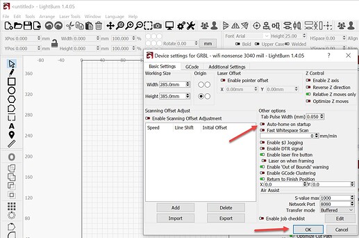

ALARM:9
Homing fail. Could not find limit switch within search distance. Defined as 1.5 * max_travel on search and 5 * pulloff on locate phases.
error is slightly self splanatory
Did you check your switches and homing cycle?
The OPT is the Build options for your Laser Engraver.
V is for Variable Spindle (laser)
Z is For Homing - Force Origin Enabled
The Build Options are listed here:
The laser engraver is supposed to find ‘home’ by homing when it’s first powered up.
It has settings to control homing behavior.
One of the settings is an internal command to travel 1.5 times farther than the allowed travel in all directions toward limit switches at home. This is to ensure that the engraver goes far enough.
This is what is meant by : “…search distance. Defined as 1.5 * max_travel on search”
When the engraver arrives at home, to ‘Locate’ Home properly the engraver touches the switch and pulls back. It attempts this 5 times. Most often one time is sufficient.
This is what is meant by : “5 * pulloff on locate phases”
The Engraver Needs to complete both steps to complete the homing Cycle.
The Alarm 9 means that didn’t complete the homing cycle.
"Homing
ALARM:9
Homing fail. "
From your engraver output, I can not determine if the head of the engraver moved in the wrong direction, did not move enough, did not move at all or if, or moved correctly and the switches were not activated or were activated and not pull off.
Please describe the homing behavior of your laser engraver.
The homing behavior you observed before turning off ‘homing’.
If you’d like to proceed with turning off Auto Homing on startup as a diagnostic step, you can do so in LightBurn by selecting Edit in the top row, then Device Settings, then click the switch next to Auto-home on startup.
Be sure to click OK to accept the change.

I just had this problem after adding extension rails to mine, tested switch, worked fine, installed, Error 9, removed and tested, worked fine, found when I installed it the pins on the back of the board were making contact with the rail causing Fail, added small thin nylon washers to space it so no contact was made, Problem Resolved.
