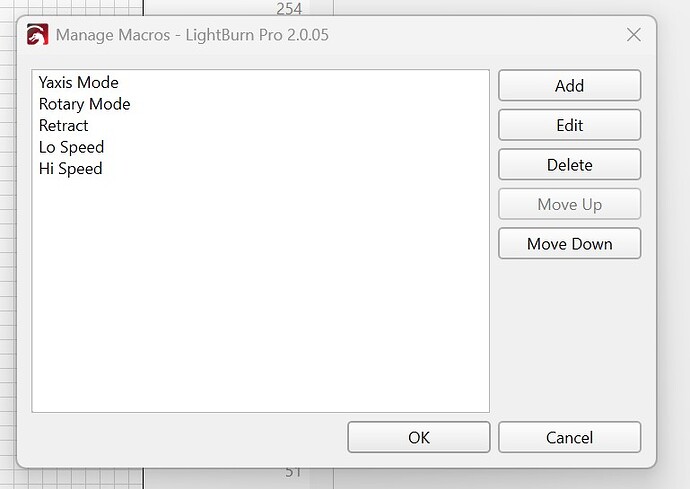

I have auto home turned off. How to I edit the values to enable home and soft limits and or create a macro so that I can turn it in and off is there an edit option in the machine setting. To use the laser bed I’m still learning as well but was able to figure alot of that by trial and error..the rotary totally sends my head spinning lol
Macro = A series of text commands you can send direct to the controller.
In the Macros window, click on Manage. The bold text below is the name of the Macro. Use your own names if you want. Be sure to click the Ok button when finished.
Rotary Enable
$20=0
$22=0
Yaxis Enable
$20=1
$22=1
My Macros for my SF-A9 laser. “Retract” moves the laser out of the way to a back corner for loading and unloading stuff.
Let us know when you get it calibrated and ready to burn stuff. :grin:
So I type in the values in that window like u showed above the photo you sent or do I type in the same as photo shown
Photo does not show the code assigned to the Macro. Create 2 separate Macros as shown in the yellow boxes.
