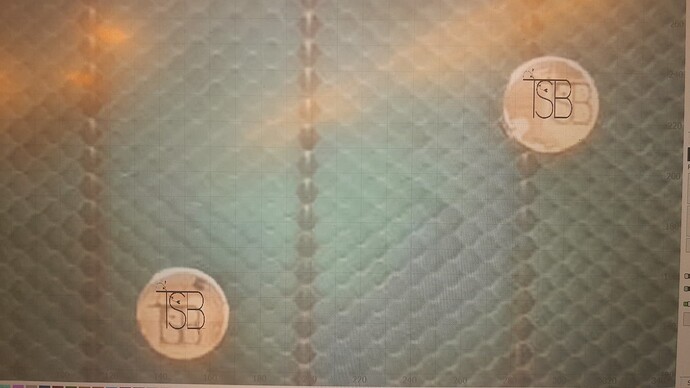

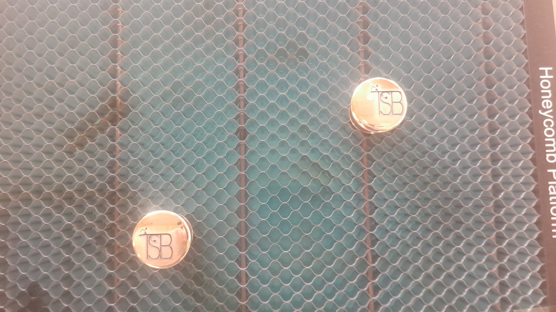

I purchase the Algolaser smart camera to use with my Algolaser DIY KIT MK2, i am going through the tutorial video on their Youtube channel exactly, and having no problems with the calibration process, but when testing the engraved pattern is always away from the one created on the software screen, as you can see in the attached Photos, any help please or tips?
It looks like the objects you put in are very high. Be aware that the camera calibration is ONLY valid at the height you did the calibration on. If you did the calibration using a 3 or 4 mm thick cardboard / plywood sheet, you only can use 3 or 4 mm material. If you want to use thicker ones, you need to re-do the calibration at that height again.
