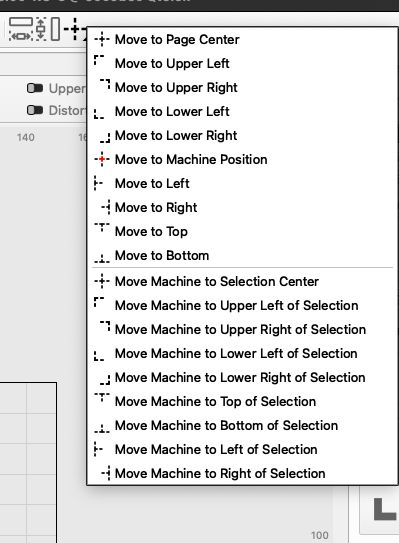

I use the alignment tools quite a lot. I’m often aligning the initial or outside shape to the center of the workpiece. The only way I’ve found to align to the center is to draw another shape (often on the T1 or T2 layer) around the edge of the workpiece and then aligning to that.
Am I missing an align-to-workpiece option somewhere (I didn’t find it in the docs)?
If you have Arrange Long turned on its the 3rd last icon
Highlight the shape and press P on the key board
in the Arrange Menu → Move Selected Objects → Move to Page Center
Theres a couple ways to do it :slight_smile:

In Millmage I have drawn a square, I have tryed the methods mentioned above and a few of my own, but the machine does not move to center of the material.
When I jog, all directions are right. the move machine selection under the arrang tab, is wrong…
Ok Joe Spanier I got my machine to line up with the material, But, The movements in the list as shown above are revered. If I want to go to upper left, the machine moves to lower right.
The jogging movements are correct.

The move to selection under the arrange tab is broken. We confirmed that. Thank you for pointing it out.
