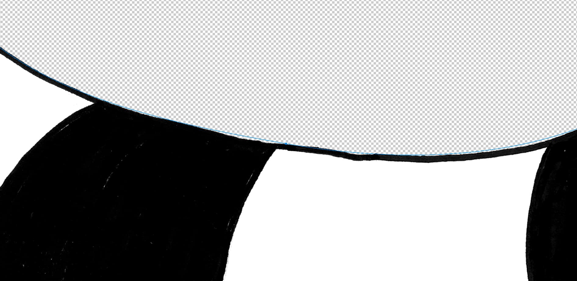

Okay here’s a screenshot. I’ve been given a Sandworm sketch to construct into a prop for a production of Beetlejuice my daughter is in. Here’s the shape I need, with all the black etched into the wood and then the shape cut out.
To be clear, I want the border outline as a visible etch on the edge of the finished shape.
When you vectorize the raster sketch, it makes small adjustments to smooth out the shapes as a natural consequence of the process. So in the following screenshot, you can see that the path is close, but not an exact match for where the cut would go if I proceeded as directed, leaving unetched gaps at the edge of the finished product.
Does that help? At this point I assume I’m just being too picky, but as I mentioned in the beginning, it just seems like there should be a solution here.

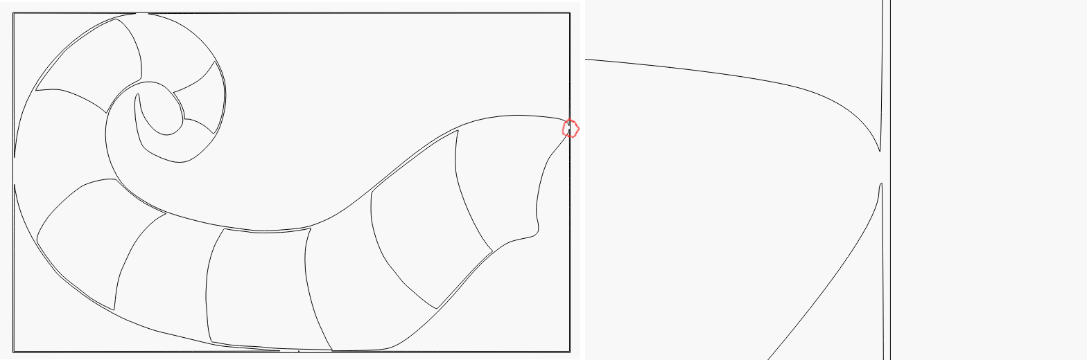

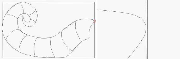

I’d suggest converting into a vector. I did this just using the default settings in trace image. Most of this separates and allows you to fill most of the items.
Where I circled this, zoomed in on the right and you’d have to a little node editing to fix where it makes contact with the outline.
Usually vectors are a bit more easy to deal with and re-produce. Changing the interval will change it’s grayscale appearance level.
That’s controlled by the Optimize value in the Trace window: more optimize = fewer nodes.
Comparing the first image:
With the second:
Something else seems to be going on, because the first curve is smooth, albeit pixelated, and the second is crisp, albeit wiggly. The background transparency checkerboard suggests they have vastly different sizes.
If you can upload the original image, that will help everybody see what’s going on.
