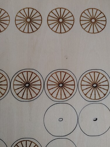

Hi all, I am running into a very frustrating issue with multiple layers and alignments.
I have a 10W Vevor A7 and keep having the same issue. I am trying to create wheels for a project and have tried many different ways of creating the file.

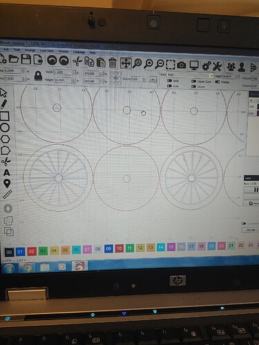

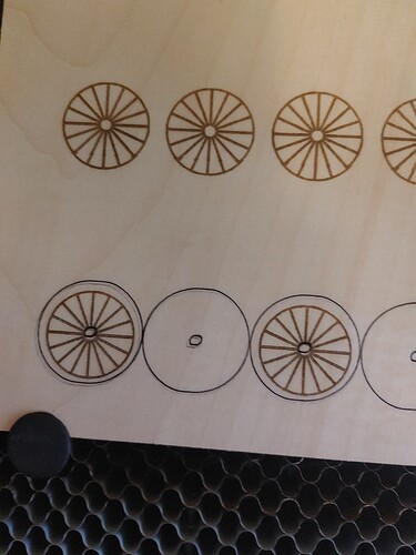

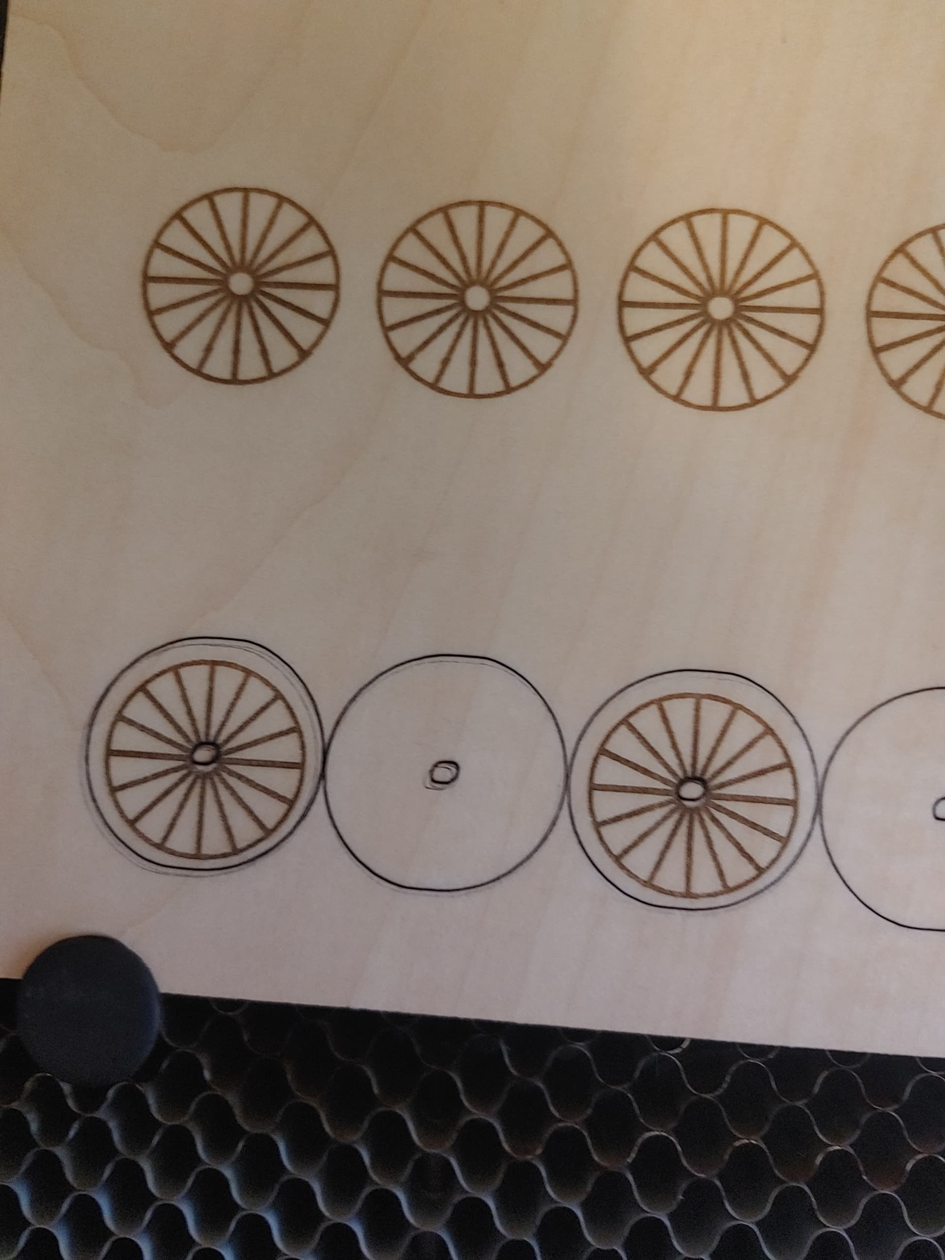

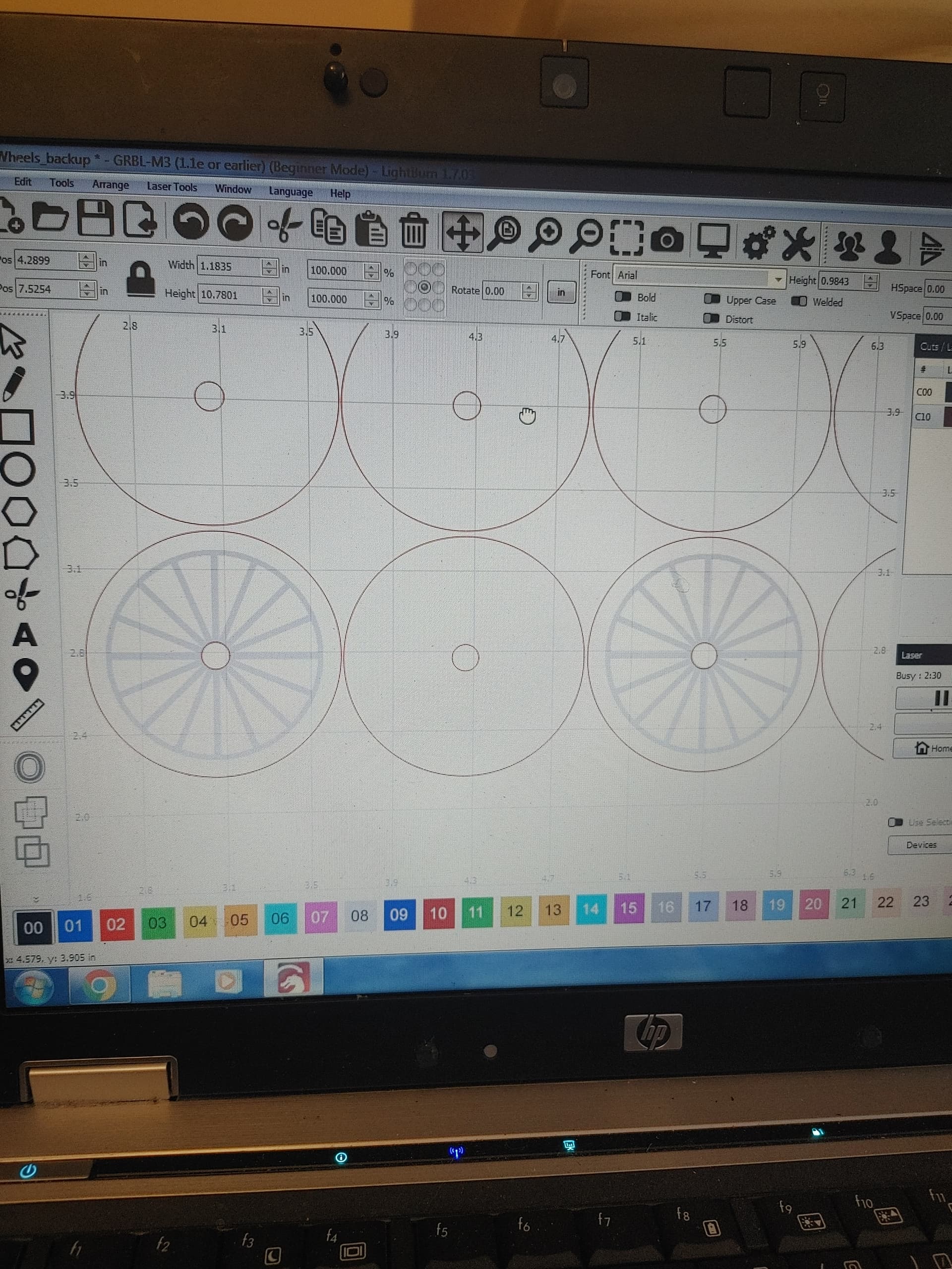

The file looks perfect on screen, but the results are far from that. It seems that I isn’t even cutting the circles properly.
Can there be something wrong with the engraver?
Any assistance would be greatly appreciated. Thank you Elli
Check everything on your machine. Belt tension, rollers, pulleys, all mechanical connections. Something is loose somewhere. Or your running your speeds way too fast.
Hi there. Thanks for the advice. I just tried tighten the belts and I doubt that is is running too fast as the cut speed is set to 100 mm/m at 90% with 2 passes on 3mm basswood.
After the tightening, I ran a quick test and it seemed to be circular. Trying the file again and keeping my fingers crossed.
