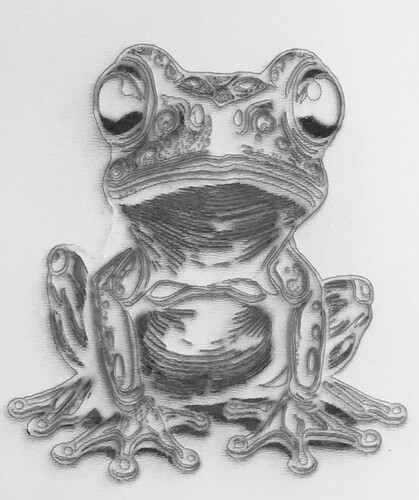

I’ve figured out the “start from” fairly quickly. I bought a sheet of euclyptus with a white side paneling at Home Depot yesterday for $12. I cut a few pieces this afternoon to play with. This is line drawing with a power at 80%, 70% was too light. There is a stray node or two that I need to correct in Inkscape and try it again. Again, thank you for your assistance and patience.

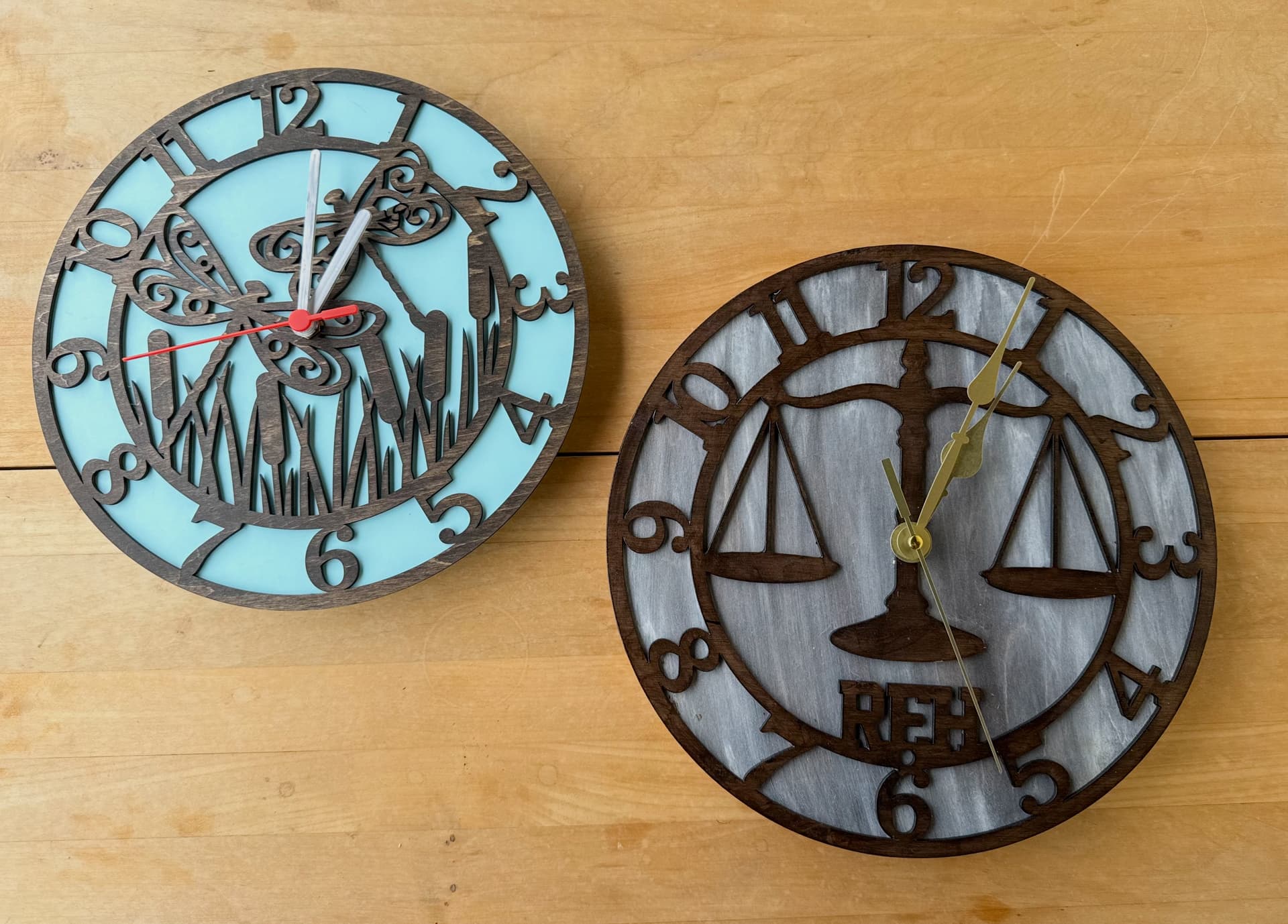

I did these in the Falcon Design Space. The Scales of Justice was for my daughter’s birthday and the Dragonfly was for my neighbor. The dragonfly one has a paper backing and the Scales have a basswood backing. The clock faces are done in walnut plywood.

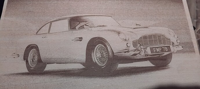

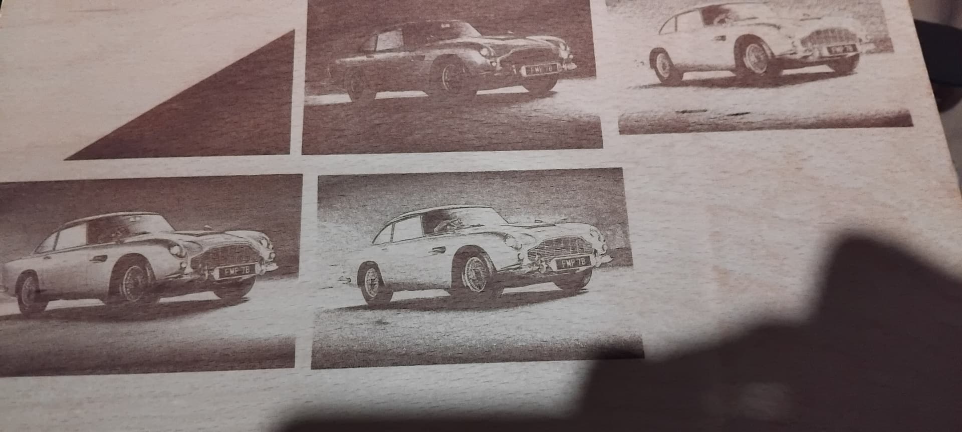

Did this today. I thought I had it dialled in pretty good in the smaller tryouts.. the bottom left gave a great overall effect and had some depth and luster to it but I had lost the detail on the wire wheels so I brightened it a bit…but too much and lost it on the rear and headlight area.
Its about 290mm wide x 180mm and took a whopping 4.5hr…I’ll be getting the tweeks bang on next time.
Handy to do the tryouts small on the back and go for it on best quality side. Its the biggest Ive done so far and I totally doing images for the next couple of weeks until I’m well acquainted.

Its an Astin Martin, think its the james bond car.
Its quite a bit off the quality it should be given the time involved.
I usually cut the background to save time but some pictures will need context.
I can crop a bit and maybe go a little faster than 2400 but the image adjustments will have to be bang on to put any kind of value on it.
The notes are most important as I was doing the tryouts I think I forgot to note one setting change and that cost me hours.
