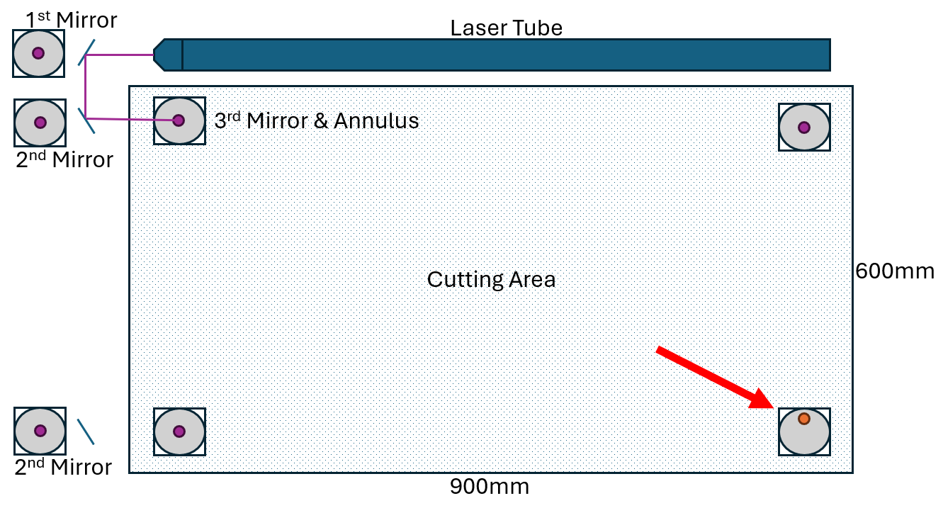

Not 100% sure where to ask for assistance, but have a persistent alignment issue I cannot seem to overcome.
I have a 100w chinese laser, and am having alignment issues on the 3rd mirror at the position farthest away from the tube. 3rd hand machine that’s taken a lot of work to get semi working. Diagram below.
I seem to be able to get Mirror 1, Mirror 2, and three corners over the cutting bed with mirror 3 to hit the mirror / annulus at dead pretty much dead centre. The position furthest away from the tube (diagonal across the bed from mirror 1) always hits high. Frustratingly, if I adjust mirror 2 down slightly, then it mucks up the other corner on the same side of the machine.
I’ve tried shimming the gantry on that corner of the machine, but that does not seem to be the answer, and just results in further alignment issues.
The gantry is square, and properly set in place - in fact I’ve probably had it in/out about 20 times now trying to solve this issue over many many months. Persistently I get to this same corner and have the same issue.
If anyone has seen this before, I’d love to hear your ideas on how to solve. I’m wondering whether tube alignment could be an issue - though my tube mounts don’t seem to be adjustable, and being a cheap chinese machine they’re not so easily replaced with off the shelf part from cloudray etc.

Reasonable people differ on the solution, but my take is that we all align Mirror 1 on targets at Mirror 2 and declare victory. The problem is that a slight misalignment at Mirror 2 turns into a big misalignment at Mirror 3 with another meter of path length to amplify the error.
So you get everything lined up “perfectly” as you have done for the other three corners, move the head to the front right corner, and adjust Mirror 1 very very very slightly to tweak the position at Mirror 3. This won’t change anything at Mirror 2 because the path length is so small, but it fixes the problem at Mirror 3.
The gotcha is that everybody cranks in too much adjustment at Mirror 1, thus wrecking the alignment at Mirror 2, and concludes what I just said is totally wrong.

Jump point: you don’t have a problem with M1, M2, or offset. Your XY plane is not a plane, it’s warped because the 4 corners of the left and right linear rails are not on the same plane so these rails aren’t actually parallel. The gantry twists as it jogs down the Y.

What you have, sir, is a warped XY plane. It cannot be corrected with M1/M2/tube offset/rear linkage rod.

OK, my case isn’t transparent, what can I actually see? You could align M1/M2 to hit M3 center on top left, top right, bottom left, but with the washer under the bottom of the right Y-rail, that corner rises up and it will hit M3 LOW in that corner alone.

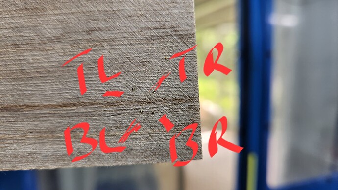

Well all, excuse the poor language, but holy excrement, the 1st mirror advice worked.
My alignment is not dead centre of the annulus in front of the third mirror, but the spot location is generally very consistent - within 2-3 mm - at all 4 corners. And it only took about 15 - 20 minutes of careful bit by bit stuffing around.
I still think there is a small amount of frame warp, but its survivable.
This image is markup of Top Left, Bottom right eyc, using the pulse setting on 10% on 1.5mm balsa. The pinhole is absolutely tiny, pehaps 1/4 mm or less. Nor sure what that is in inches, but its very small. The total spot size is perhaps 1/2 mm.
