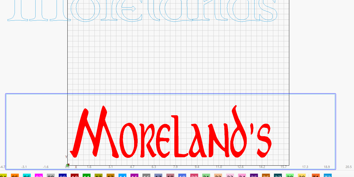

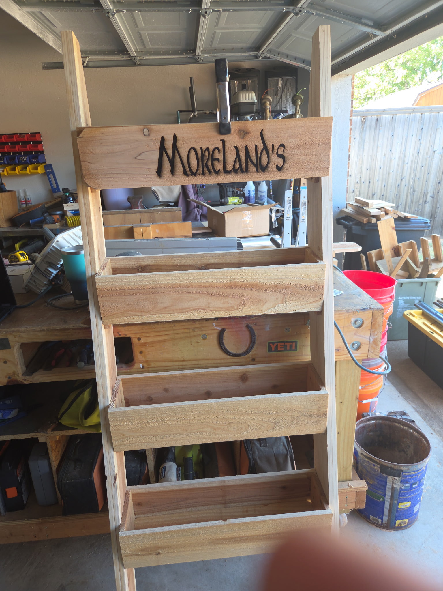

I am having an alignment issue. I made a tool path 24"X5.5" (bigger than my laser bed) to represent my work piece. I centered that to my grid on the X axis. I then centered the text to the tool path. During framing the laser went too far to the right and caused an error. I checked to make sure the tool path was not being output. framed again, same issue. I moved the text to lower left of grid and framed again. No issues this time. I ran the file and noticed it was off center by 2.5", I let it finish to see the laser power and speed results. I could not figure out why if I have the job centered it burns off center. I made a 2nd attempt by moving the board 1.25" to the right and got the text centered. But want to find the reason why I cannot get it right through Lightburn. Attached is a screen shot of the text and the location and a pic of how it was off center by 2.5"

Your image does not show this. I downloaded the image, put in Lightburn, and took some measurements. The Tool layer is not centered over your grid and the lettering is not centered in the Tool layer.
Do you have a trailing space in the text that caused the shift?
