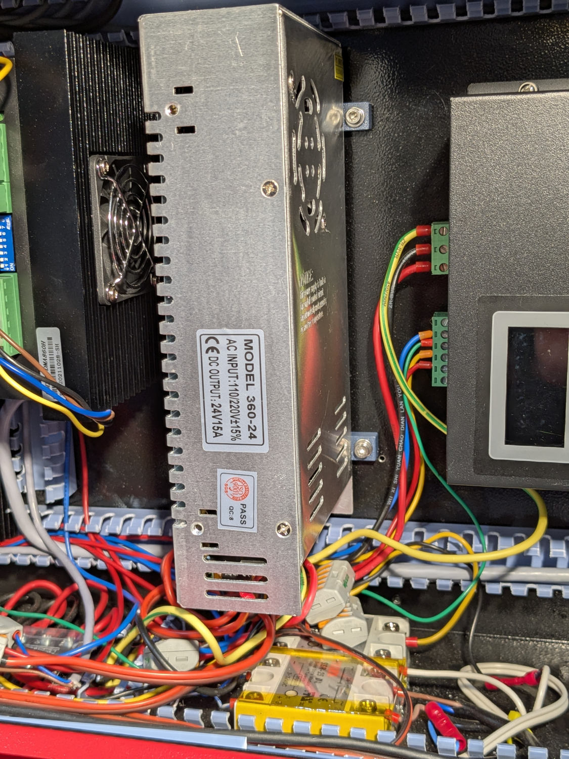

All axis drivers are failing to power properly, I have flashin green lights on all three and a simultaneous flasing red light on my Z driver. Everything was fine when I powered down after use, now I have a problem at powerup, have tried restarting, no change, have disconnected individual drives, no change, asvthe green light pulse, so too does the fan on the Z drive, I am not technical but suspect a lack of sufficient power at start up? Or a software issue?
Assuming it’s that machine, then the 24 V supply has probably failed.
They seem to be under-specified for their task and fail far more often than you’d expect. If it’s under warranty, then you can likely get a replacement.
If it’s out of warranty, then get a replacement with a higher output current rating, although fitting the new supply in the space left by the old one may be difficult.
It’s likely a ventilated aluminum box in the electronics bay, similar to the one I just shoehorned into my machine:
Worst case, they’re available from Amazon, but look for a seller with a pronounceable name that doesn’t also carry inflatable holiday decorations and beach attire. :grin:
In general, abrupt failures are due to electrical or mechanical issues: if you didn’t change anything and something changed, then it’s not a software problem.

That would be unusual; the one in my machine is an ordinary 5 V module.
Oddly, OMTech installed a dual-output 24 / 5 V power supply with the 5 V output used only for the red-dot pointer. They could have used a 5 V output from the Ruida controller, but … who knows?
Assuming the pointer runs from the 24 V supply, then it will probably light up just about the same way from 20 V, 15 V, maybe even 10 V. However, the stepper drivers will choke on low voltages.
A cheap multimeter will let you measure the actual output voltage to see what’s going on.
It’s possible, but if the stepper drivers are the typical black bricks, they use DIP switches for configuration.
