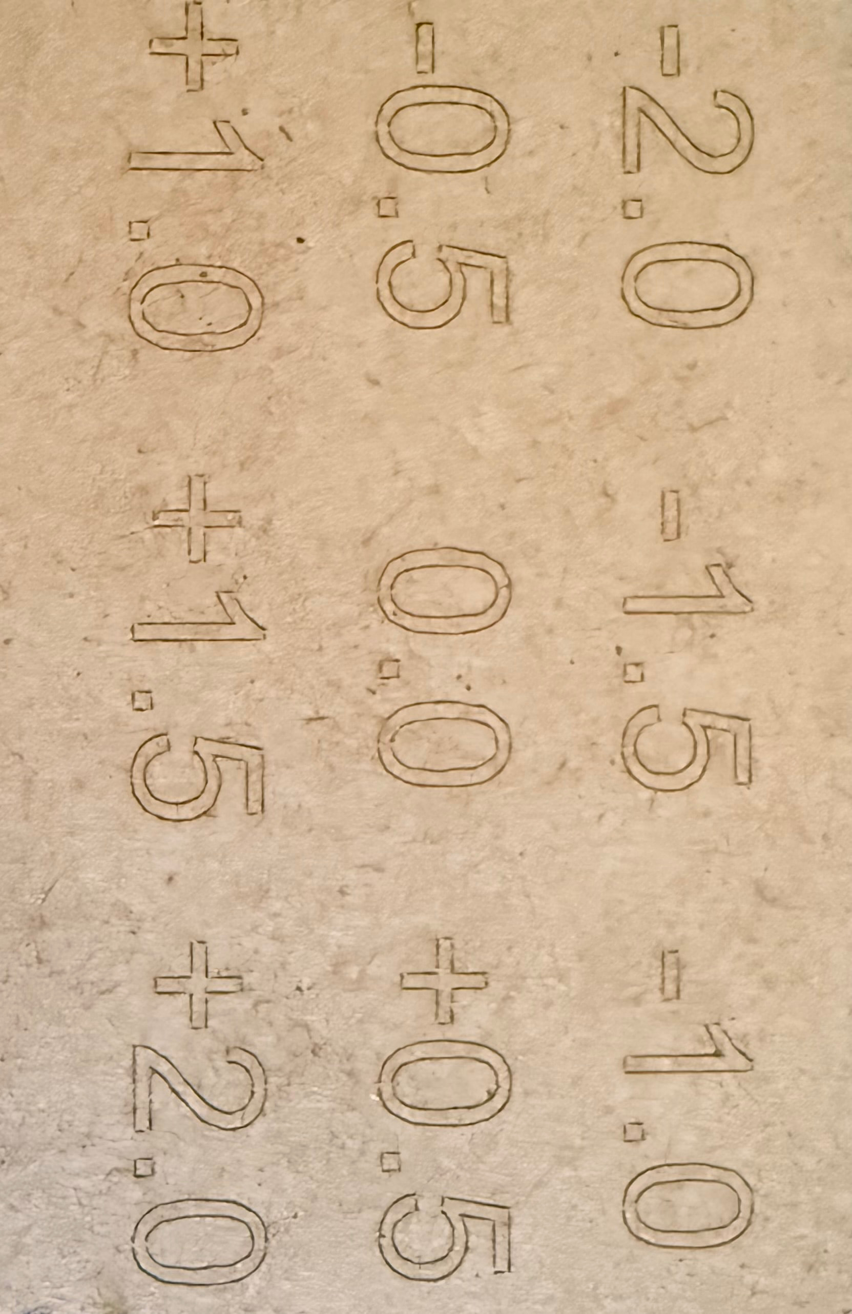

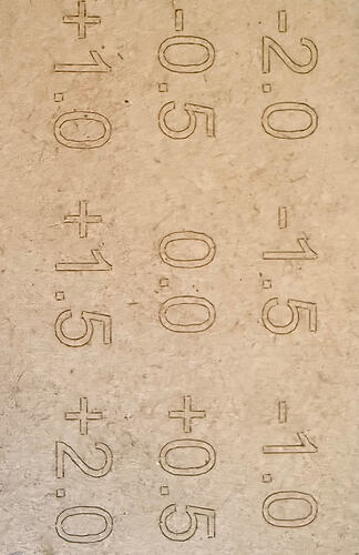

So I ran the tests, and I actually can’t see what they were intended to do. Sent the photos off to Creality so will see what they say. I did the test on MDF as this is what I have been working or at least trying to work on most lately.
When I ran the macro, the laser moved up and down. I guess this might have been a very vital part in the focusing which it was not doing prior to them sending me the file. Why they do not include that file on the memory card to begin with, I do not understand. On top of that, I had to basically pull teeth for them to send me the file…. Why was it so hard?

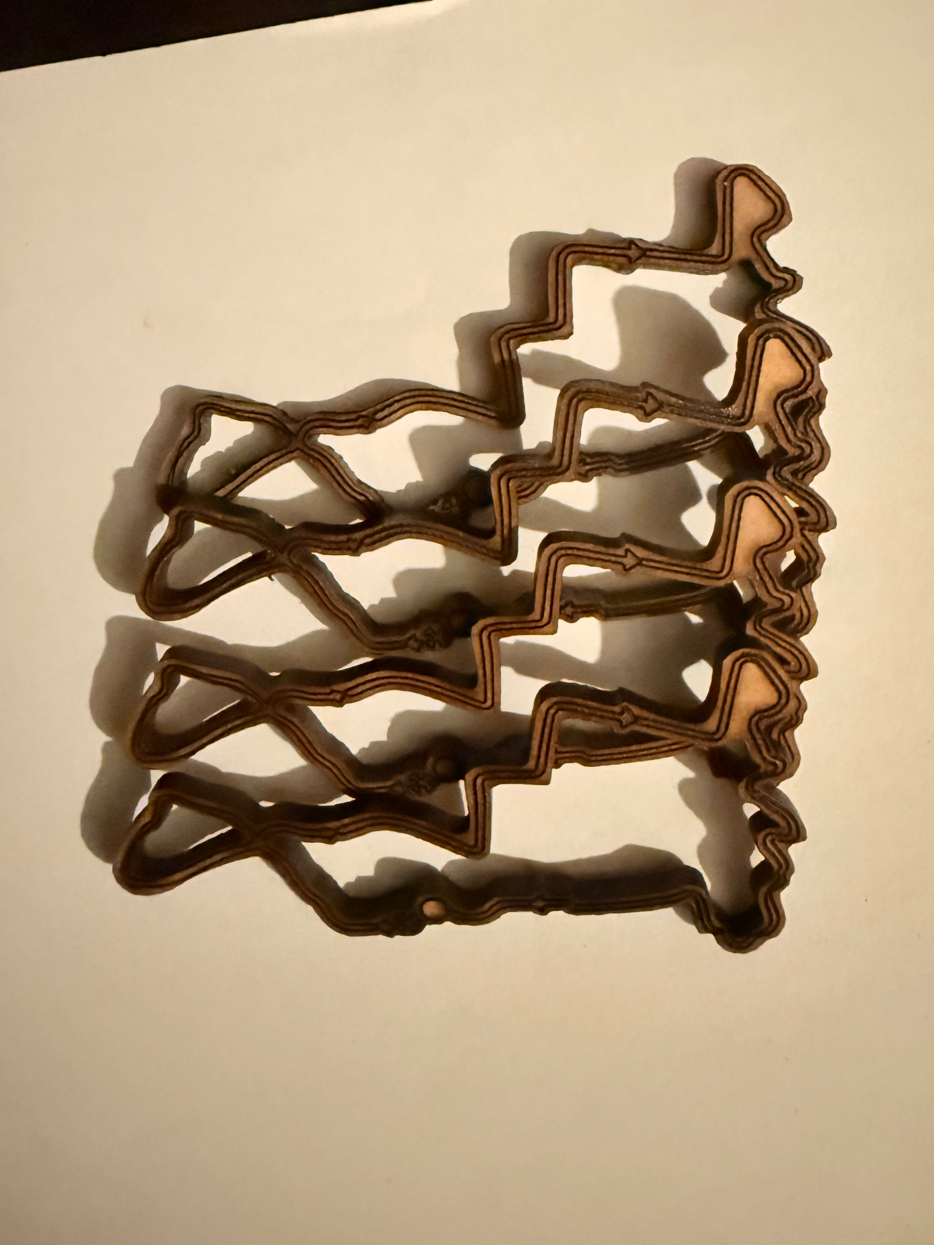

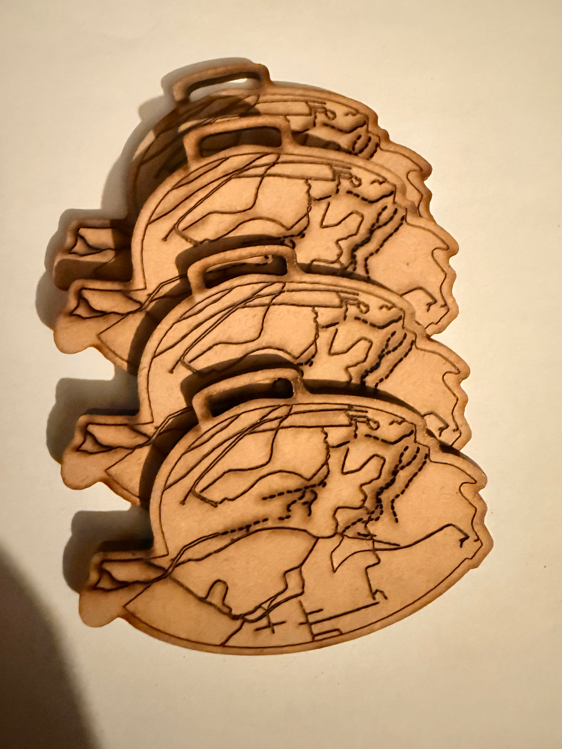

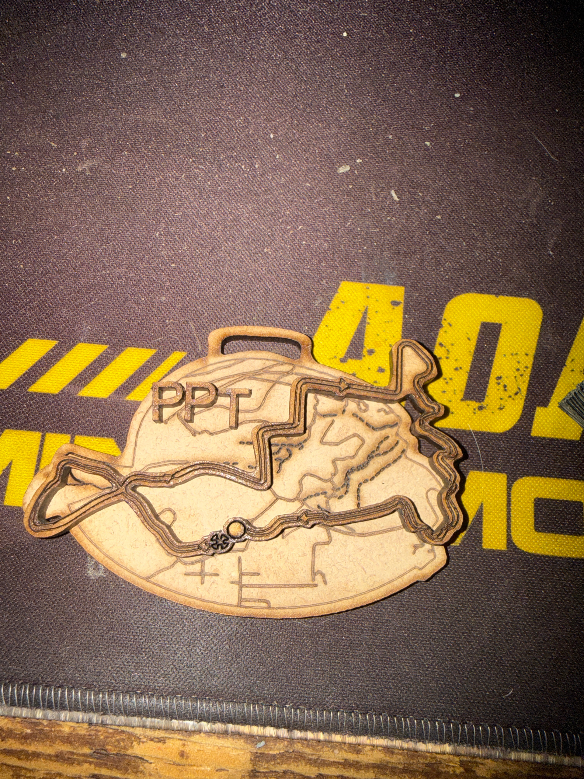

The next few images are just to show the ‘medals’ I have designed and cut out.
Is there any mention of what material the test should be done on?
I would do the test precisely on the material I intend to work with.
If I understood correctly, the test should show, for example, -2.0 in thick, blurred lines, improving until 0.0, which would be the most perfect, and then degrading again to 2.0.
In this specific case, I don’t notice a significant difference in focus. What I do notice is the imperfection of the numbers, the cause of which should be investigated.
Besides, the cuts you can make in MDF make me envious. :wink:

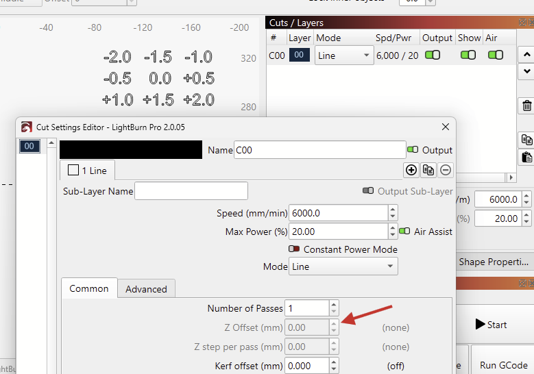

Obviously, they intended to do a focus test. But as mentioned previously, their text in the .lbrn2 file consists of only one shape, running at the same focal height.
Even if they had a Z-Offset configured in the Cut Settings, it would only run at the same height, not at the -2.0 to +2.0 mm as the text suggests.
Additionally, the device profile they sent you doesn’t even have the Z-Axis enabled, so I really don’t know where they were going with this.
Note, that you can still execute their “Auto Focus” macro even if this option is disabled, because the $HZ1 is handled by the machine.
LightBurn just won’t send the machine any direct Z-Move commands.

Your recent results look way better than the initial ones. The outlines are sharper, and it looks like you are at the correct focal height.
Which speed and power settings did you use?
To get less charred edges, try decreasing power and doing multiple (3-4) passes.

Thank so much for your reply again. Yes I am a lot happier now with where I was a week or two ago. At least I’m cutting MDF. I have been trying various speeds and power settings and looks like I can get a decent enough cut on 1 pass at 900 speed. At least on the one stock of MDF. The other seems somewhat harder to cut, and I haven’t quite found the max speed I can cut it in a single pass.

Today I cut 170 “medals” and everything went smooth. I got to test different speeds, and power setting on both the cuts and engraves and have now nailed it down for this project. I’m glad to get my first mini project and will likely finish the cutting tomorrow.
