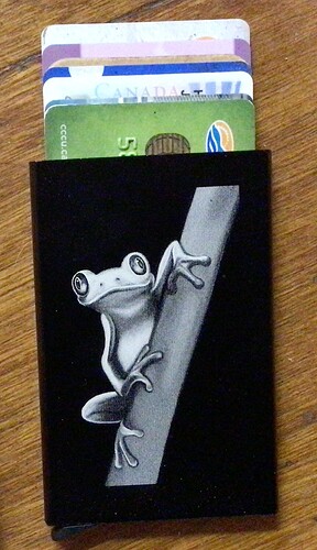

An aluminum RFID protective card case done with my 60w Mopa fiber laser. 1100 speed, 508 dpi, 25 khz and 200 Q pulse. One minute 30 seconds burn time

Best work I have seen yet !!! Man that looks really good !!!
