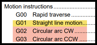

Be aware that LB does not do circular interpolation. There are no G02 or G03 in LB GCode. Only G01.
Amada supports all three.
If you are only engraving, and not cutting, all G01 is probably OK
no, all G01 is not ok. the laser needs G00 to turn the etching off when positioning otherwise it etches all travel movements

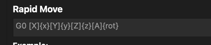

If you go to ‘Edit > Device Settings’ and change the rapid movement settings, does that result in an improvement for your use case? This is what a LinuxCNC Custom GCode device has:
Enabling ‘fast whitespeed scan’ may also work: Lightburn Setting G0 Feedrate to 0
But outside of that, I don’t believe we currently have a user-configurable way to force G0 between all cuts. Still looking.

LB does G00 and G01 - it doesn’t do G02 or G03. Amada supports G02 and G03

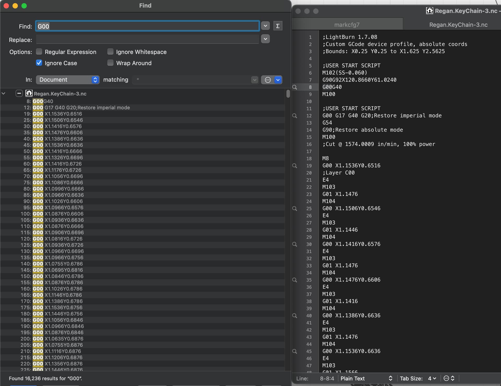

Unfortunately changing the rapid movement settings did not work as LB is not implimenting those movements into the code. the same is with the whitespace scan. i did however discover a work around that should work out, once i get an opportunity to test.
when i go to “Help” in the tool bar and select “Convert to cut (Debug)” the gcode does use the g00 rapid in between the cuts. so i changed the custom gcode settings for “Cut Move” to use the “Raster Move” code instead. this did export the correct gcode rapid position and linear movement commands.
i tried the switch to LinuxCNC and it did not fix the issue of LB not using the g00 command between etches. but i did end up finding a work around that i can use in LinxCNC (not tested with Marlin yet)

So a test output on my end does show the G00 moves, which appears correct:
No difference in output between having Debug on/off

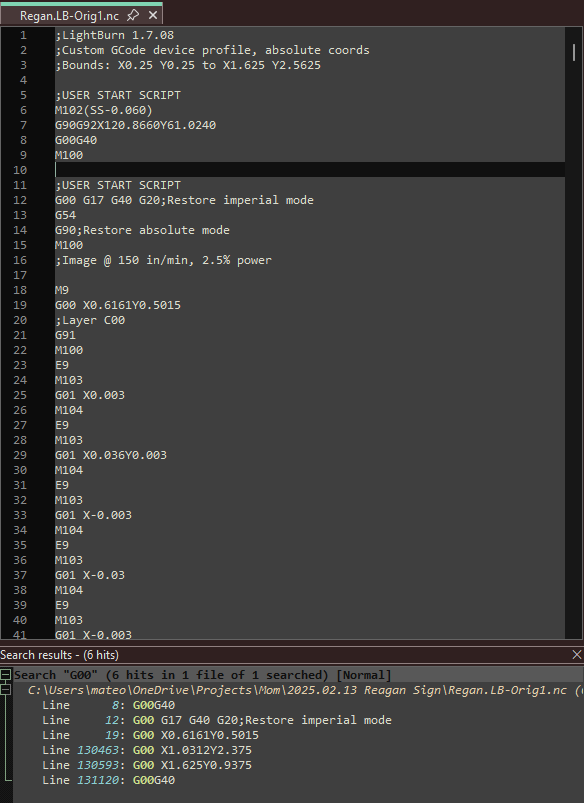

i made a mistake with the file that was sent. i had already used my work around on that project and it was giving you the “E4” Cut Command and not the “E9” Raster (Etch) Command.
Regan.LB-Orig1.nc (788.2 KB)

@Oetam91 I’m a bit confused - I downloaded your device profile and file. It’s outputting E9 for raster (image) moves and E4 for regular cut moves, as you have configured.
