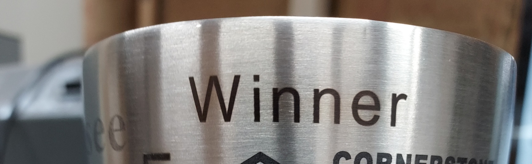

Hello all. Happy Fall.
I can anneal my Stainless Steel Tumb, but it is slowwwwwwwwwwwwwwwwwwww
Does anyone have any settings I can start with to “mark” / anneal? I’m doing what Laser Everything has done, but it took 40 minutes to mark that tumbler with the customer’s logo. I sent him one with his order to see if they like it.
This guy is using 50 for speed, and I was at 100, and it still took forever. I wouldn’t be able to do production work at that pace.

Annealing metal takes a lot of heat input, and unfortunately for power-restricted setups, that takes time.

I had the same gripe and mine is a M60. @Colin is correct, you are not blasting pieces out of it, just heating it…
Did you de-focus a bit?
You can try higher power along with a faster scan and/or lower frequency, maybe you can improve on it?

I swapped out my 100 to the 200 so it wouldn’t have to be so precise.
Current Settings
50w JPT
2000 speed
38 pwr
600 freq
1 layer +45 scan angle
LPI 0.0254
Defocused as well
Real closeup, some of the letters show a wiggle kind of, but not noticeable just viewing it in your hand.
