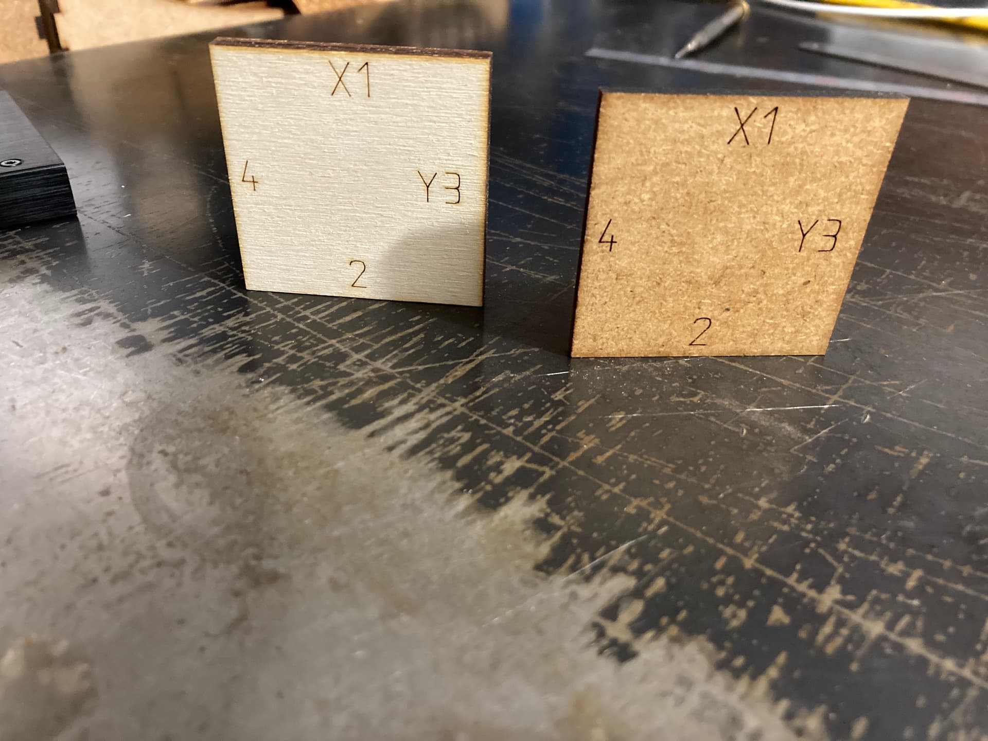

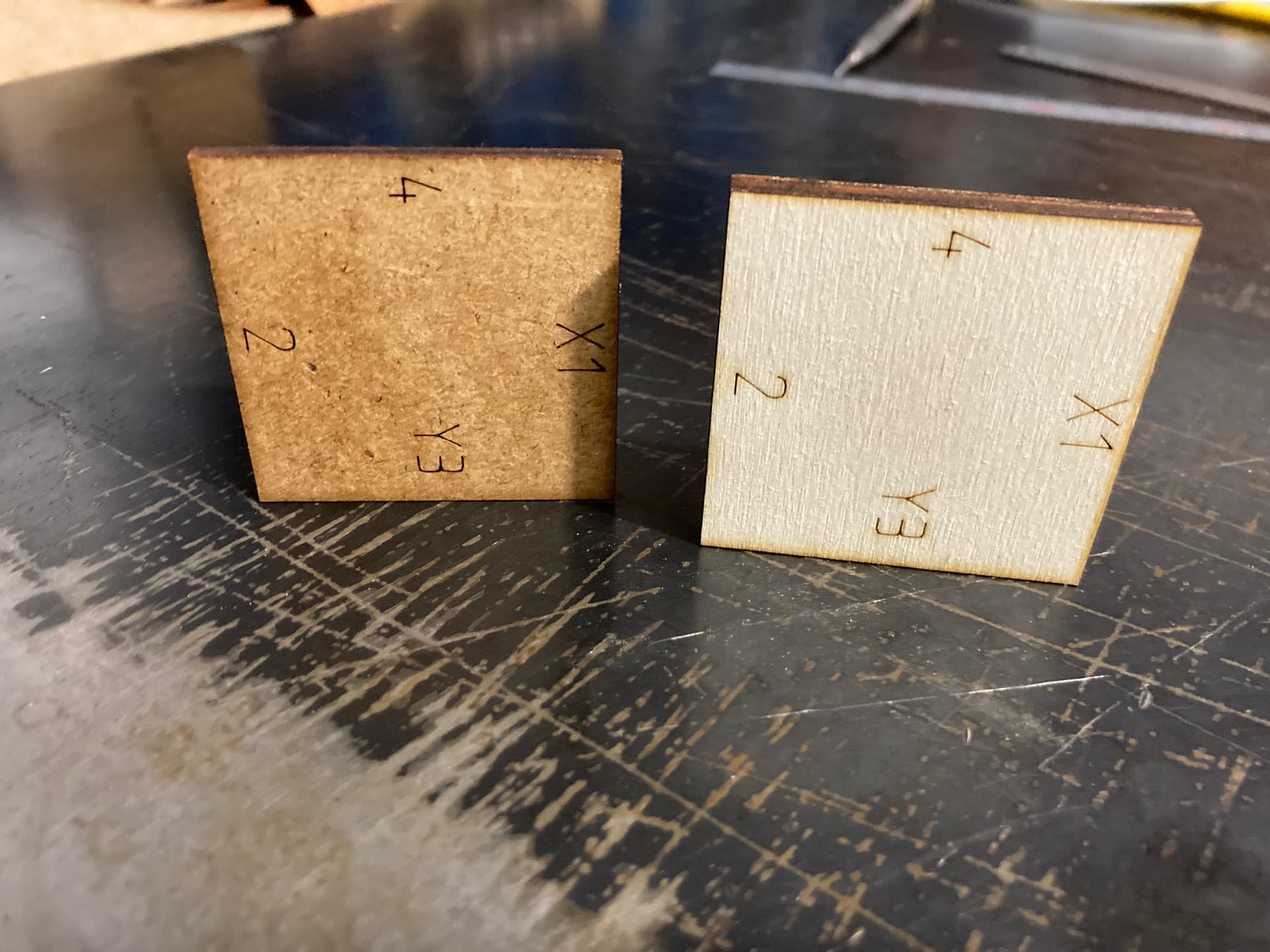

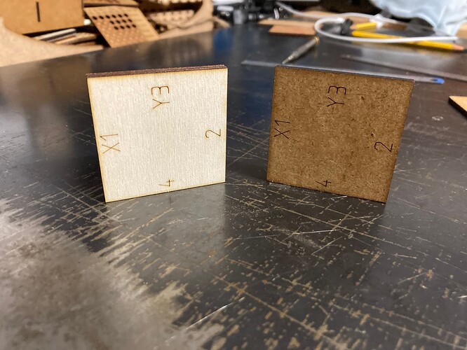

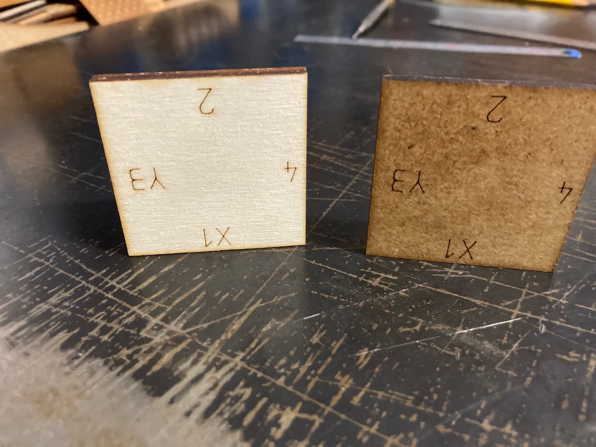

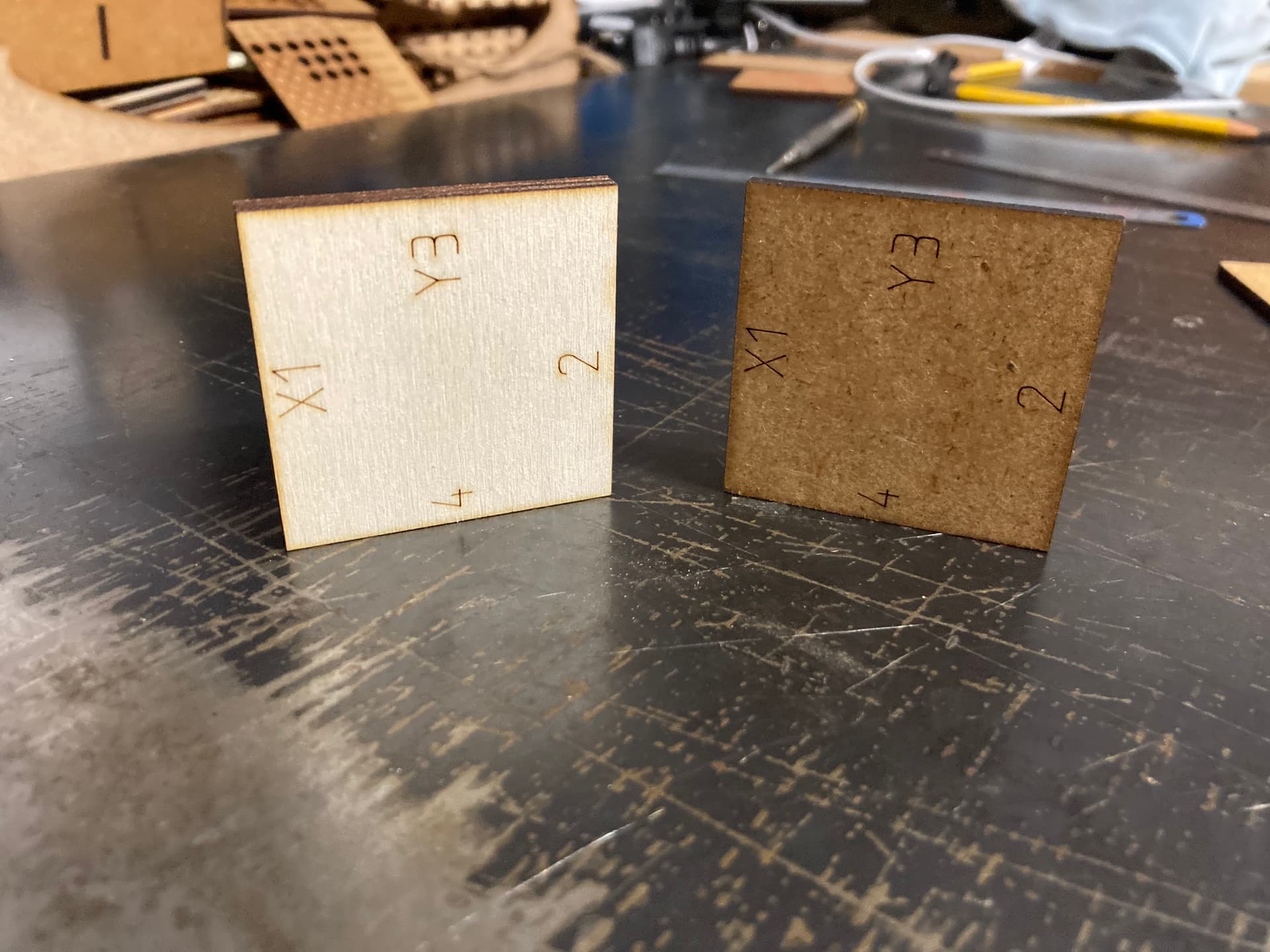

Another way to check the perpendicularity of your laser beam
Also an opportunity to test whether your nozzle is perpendicularly mounted, i.e. the laser beam has a straight cut in its nominal area. This obviously assumes that the focus is set correctly.
The light material is 4.8mm poplar plywood and the dark is 3mm MDF.
(the meaning is to check whether the subjects can stand on all sides or not)

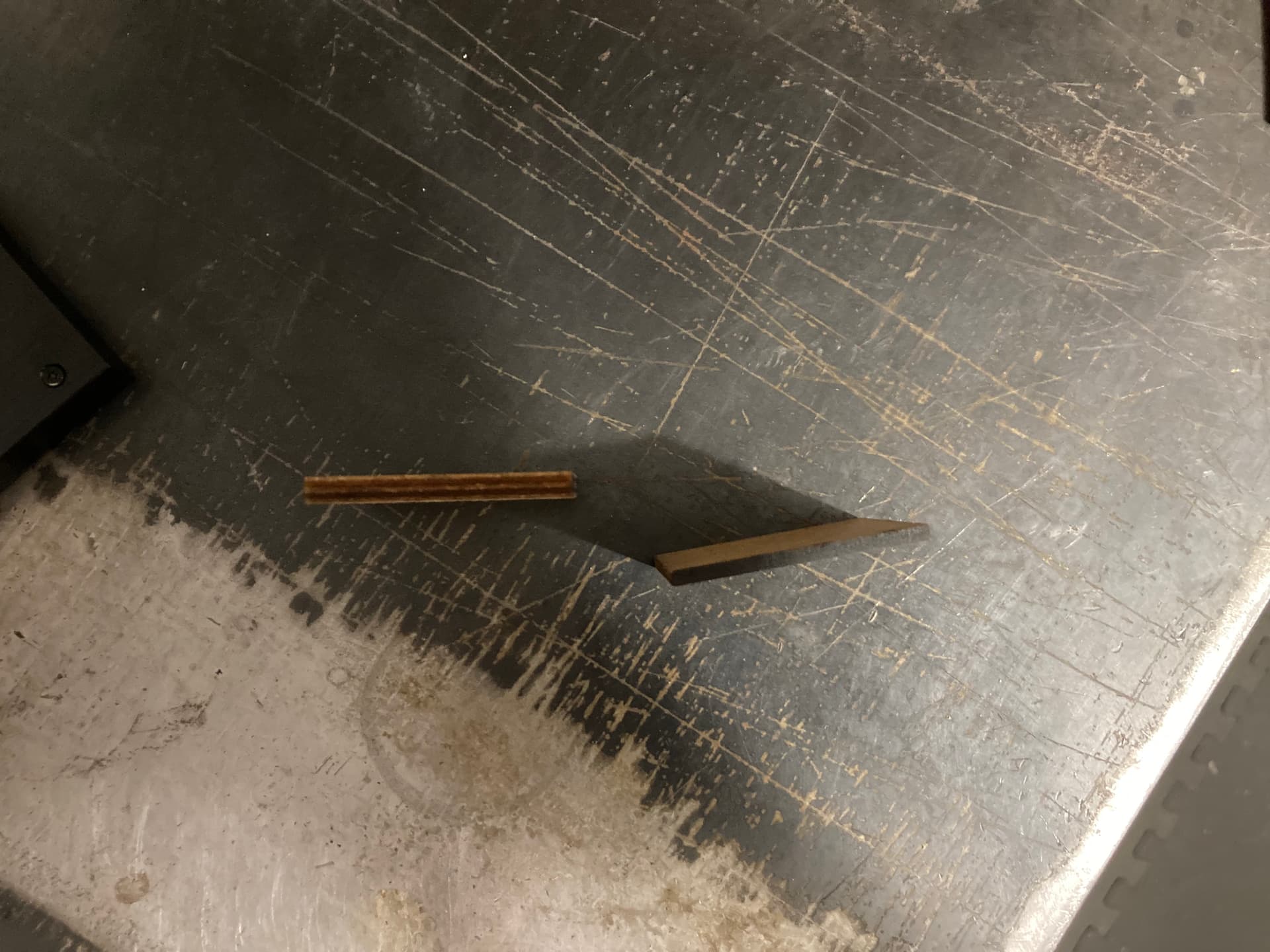

It seems that the squareness of a boards edge is more a result of type of lens and where the focal point is placed. There must be more to the method you propose.
I used a normal 2 in (50.8mm) lens. I think people will be surprised how crooked the edges can be sometimes. Try it yourself with 3mm 50x50mm placing the small plate on each of the 4 sides.
