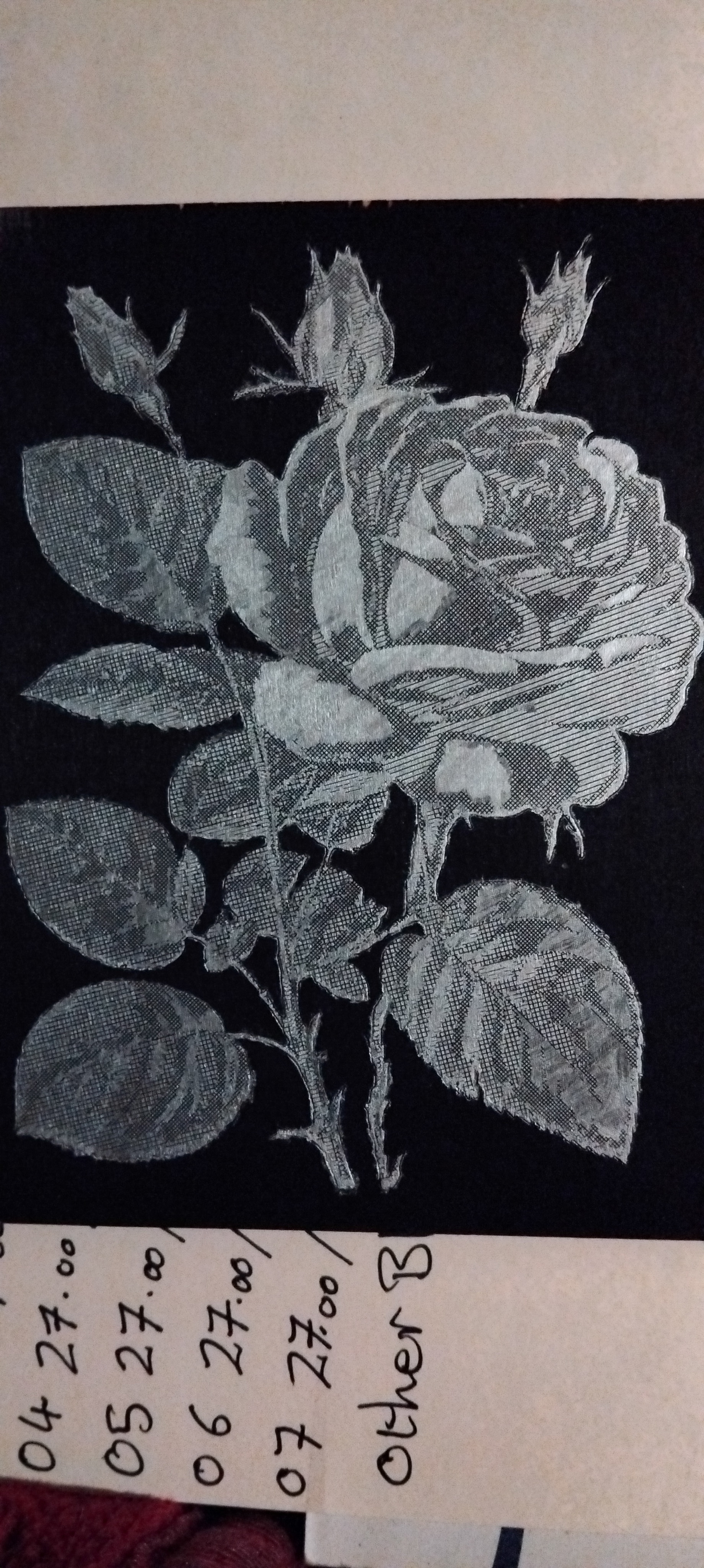

Combining paint into the process. Some way to overlay multiple layers with depth between. Applying “stucco” to laser over for texture/depth. I have to believe that there are MANY techniques that have yet to see the light of day.

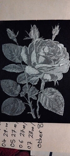

Here’s something I’ve been working on for a couple of weeks. Most of the time was spent learning to use software tools which is the primary objective and to design a workflow that is most effective.
I just got done with the basics tryout today and still have a way’s to go with the finer details.
The paint is applied as one layer after cutting the outer boundary and the Hatch/CrossHatch per layer 1 to 7 gives the appearance of different tones/shading for each layer.
The more layers used..the more tones and shades can be included for realism.
