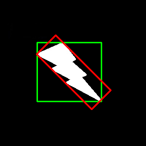

That’s a good catch, but I still think that a better fitted rectangle would help in most cases. I don’t know the behind-the-scenes of LB, but in my opinion, using something like the cv.minAreaRect() in OpenCV would provide better results in most cases.
boundingrect
Though, you would need to translate this to the original coordinate system orientation, which will result in the green rectangle again. So might not help that much. Or use a convex hull and translate that to the next fitting minimal rectangular shape.
What might help would be to select the smallest fitting rectangle that has 0° orientation, that would solve the 45° problem case of this thread, at least :slight_smile:
I understand the reason you didn’t do it that way yet, it might get complex and have many corner cases.
