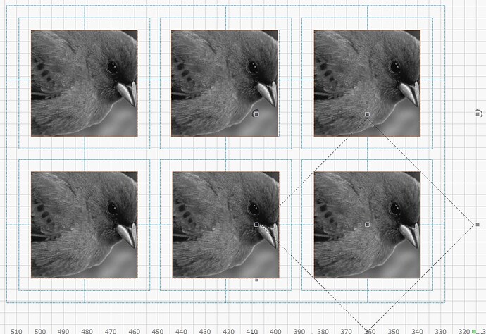

I have a place holder I use for the Laser cutter for holding that I use to place up to 24 Coasters. I have a Lightburn project that I have setup using tools as guides, so I can place my graphics and everything is all aligned for my coasters. Ive run into an issue thought.
Suddenly when I send to the laser, everything is off by about a 3rd of an inch. It took me forever to realize the obvious issue. I was using an image, but I had to rotate it. Even though I used a layer to mask and apply, the image bounding box is still the original dimensions, poking way being the template. So the start point is thus a 3rd of an inch from the template corner.
Is there a way to tell Lightburn to reset the bounding box (like in Adobe Illustrator) so that the project recognizes the images new dimensions, rather than the images original dimensions/orientation. I use Illustrator and Photo shop, so making adjustment would normally be… relatively easy. But I use Imag-R too… so everytime Im using an Imag-R processed image, Id have to go through Imag-R to reprocess it, which is someone of a pain, time wise. I cannot (so far as I understand) run an Imag-R image through Photoshop/Illustrator as they don’t have the Algorithms needed.

Ive already cropped image. The circumstances Im having issue with is when you have to rotate image.
I have a guide/template.
I import image, but need to rotate it. Image goes outside guide/template, so I need to crop everything outside of it…
I crop image by creating shape as T1, Apply mask to image, then flatten.
No more excess outside of guide/template, but the bound box for retains original rotating position, exceeding guide/template.
The issue is that the work area(?) is no longer defined by template, but is effected by bounding box, throwing everything off.

I do on not want to move the image. When I create a shape that extends to the outter dimensions of the bounding box, I am still left with a shape the same size as the outter edges of the bounding bax, whether its a shape or a tool.
My needs are to eliminate anything beyond the post flattened visible image.
1st) My physical place holder
2nd) My Lightburn Template
3rd) Sample Image Rotated
4th) Mask applied to fit inner square
skipped image as its results are still conveyed in image 5
5th) Mask flatted. Following your suggestion: Created shape that covers the full dimensions of bounding box. Included shape and image into group. Moved. Just to be sure: I also made a shape the size of the image just like I did for making the initial mask. Neith option reduces the bounding box. All I have is another shape the same size as the outer points of the bounding box.

Its not that it won’t let me send it to the laser. Its that its including the excess of the image, what Ive been referring to as a Bounding Box, as part of the project (Bounding Box is the term used in Adobe Illustrator), throwing the alignment of the project off.
  • I made a template (Guide? Work area?) in light burn that represents my physical coaster template place holder.
  • The most outer blue line in lightburn represents the outer edges of the place holder
  • The large inner squares represent the slots for the coasters.
  • The smaller inner squares represent where my designs go if Im working with slate.
  • The grid-like intersect lines represent guides for centering.
    Everything is set to T2 (Blue) because I have T1 (Orange) reserved for something else.
I broke all that down because I feel there might still be confusion despite all the photos. If this didn’t help, I guess I’ll wait for the patch. @misken seems to have understood the issue pretty quick, so maybe I just confused things more. idk. Either way, @misken identified the problem, and hopefully a solution will be in the works soon.
In any case… hopefully you understand now, that I need the work area to be limited to the most outer blue line. It doesn’t represent the max cutting are of my laser, just of my template/place-holder. So when I clip an image using a mask (apply mask > Flatten) and the outer dotted line is still beyond the template work area, it throws the whole alignment off when I go to laser it. Again, @misken identified this as a lightburn issue. Lightburn is recognizing the excess space of the image as actual image or a shape. Its including the excess, which should no longer exist, as part of the project.
I had hoped there was a setting/method/tool that could force the project to be cut off at the most outer blue line. Probably wouldn’t help in most other projects, but it’d be helpful in this specific instance.

This issue isn’t with how to move an image with a mask. You are correct, you need to group them to move them. The issue is how the bounding box of a flattened image is having an negative effect on the dimensions/alignment of the project. The project bounds, work area, and start point is becoming determined by the bounding box, rather than the desired template/guide.

I replicated what you saw and attempted to apply a square mask at 45 degrees and then flatten and rotate that result. I couldn’t get it either.
I asked the Dev team if there was a way through. Oz explained that there’s no way within LightBurn at present.
  • It does reduce, but the problem is the rotation. The crop is rendered into the original bitmap in its original orientation. The user has cropped a rotated image, and the result, in the space of the original image, is a diamond shape, so it keeps “out to the tips” of that diamond.
If you use Absolute Coordinates for your project, the origin remains in bounds as needed because no cutting/engraving moves are outside the workspace.
This isn’t technically a bug - the mask is applied to the original image, in the orientation of that original image.
What you’re looking for is the masking process to also rotate the image into an arbitrary new orientation. If you had used a different shape, what would the correct orientation be? For example, this one?
