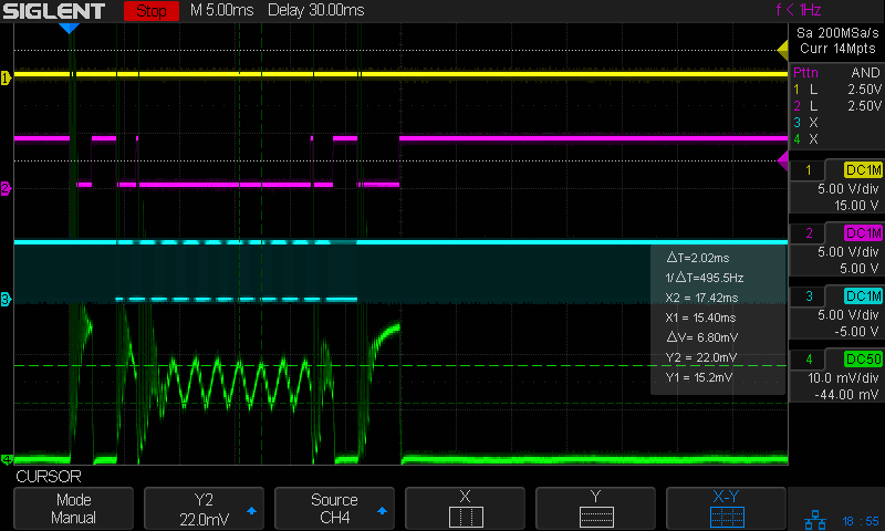

I measured some of that a while ago
Start with a sine-wave test pattern:
That’s contrived so each bar is 1 mm wide with 0.1 mm pixels at 254 DPI. Engraving it in Grayscale mode lets each pixel value directly set the output power and scanning the pattern at different speeds changes the frequency of the sine wave signal going into the HV power supply at 1 mm/s = 1 Hz.
Scanning at 50 mm/s shows the current does reach full scale, although it’s obviously not linear:
The traces:
  • 1 X axis DIR, low = left-to-right (yellow)
  • 2 L-ON laser enable, low active (magenta)
  • 3 PWM digital signal (cyan)
  • 4 tube current – 10 mA/div (green)
Speeding up to 200 mm/s = 200 Hz shows that the current no longer reaches the extremes, so the tube never fully turns on nor shuts off:
And at 500 mm/s = 500 Hz, there’s not much signal left:
So the “3 dB bandwidth” into the IN terminal is around 200 Hz, more or less, kinda-sorta, which implies a step response on the order of 2 ms to PWM (or analog) changes.
The response to the digital enable signal on the L terminal is more complicated: the turn-on current oscillates for a few milliseconds and the turn-off is nearly instant.
AFAICT, the controller turns the L-ON signal off when the power output set by the PWM output should be zero, which means that oscillation will blur the off-to-on transition: at 500 mm/s, a 2 ms oscillation will be 1 mm wide. This means the faster you try to scan binary dithered images, the worse each pixel will look.
So, although a higher voltage power supply might improve the response, I’m reasonably sure you’d never notice the difference.
