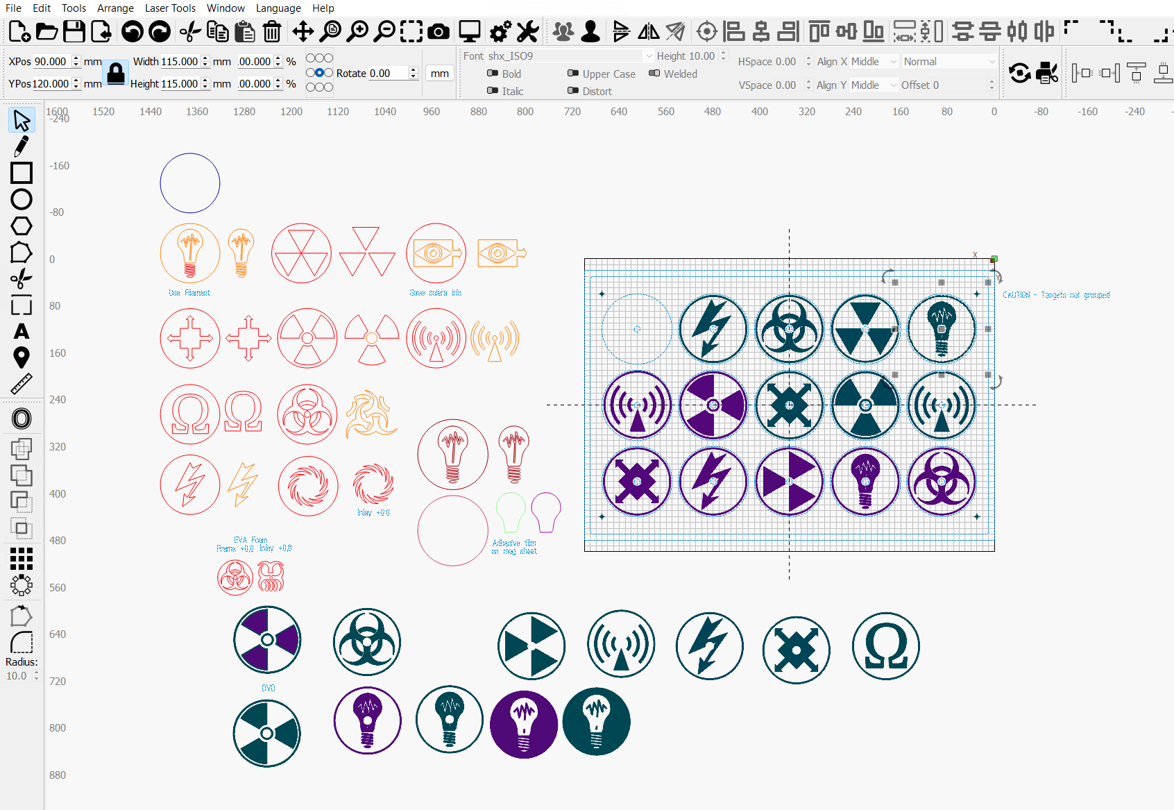

I’m a new Mira owner, coming from 4 years with Glowforge. With GF, a user can import a file and move off of the “working area” what they’d like cut at a time. Leaving the other components to the side (usually b/c they’re needing other materials to be loaded). I know with Lightburn you can change the “output” and the “show” but that’s not quite what I’m looking for. I’d rather not create 3 separate files for one job if I can help it. Does this make sense? Thanks.
In LightBurn, it is "cut selected graphics” that does what you are asking for, if I understood you correctly.
How is this used?
Sure, like this:
The red-orange patterns on the left are for chipboard / plywood / MDF / cork.
The green-purple ones along the bottom engrave into scrap CD/DVD discs.
The blue grid is the laser’s 700×500 platform & LightBurn’s workspace, with a template for 15 discs locked in position. Targets in the corners of the template let Print and Cut align the template to the fixture on the platform.
Drag-n-drop patterns into the template, select the ones to process, and Fire The Laser: everything not on the platform and not selected just sits there and does nothing.
Works for me …
OMG, so simple. I had no idea you could zoom out that far… It’s as simple as GF in that way. DUH. LOL. Thanks!
