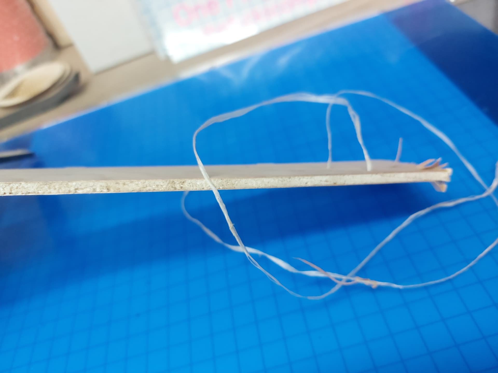

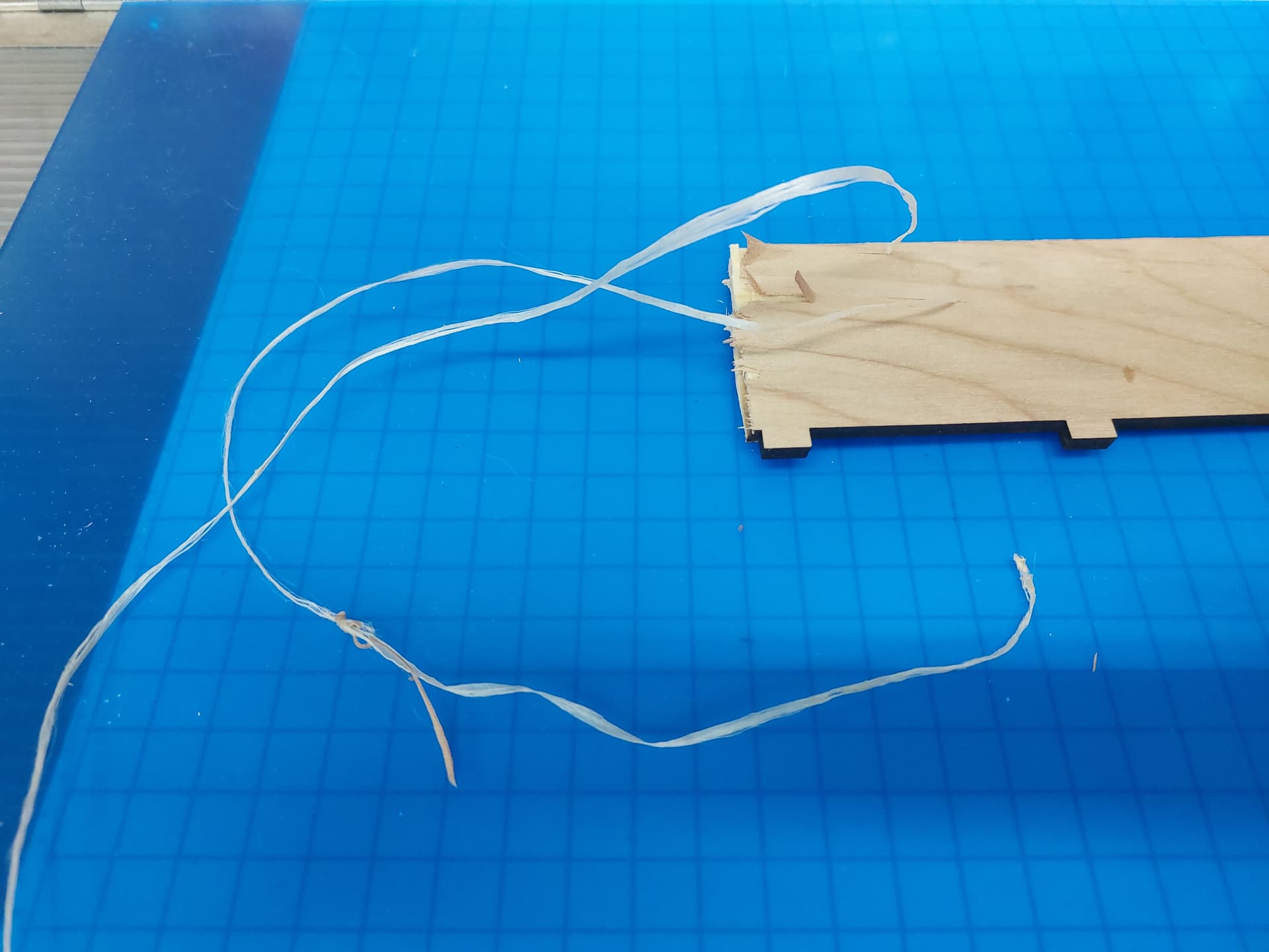

New sheet of the birch ply from the Home Depot down the street. I was having a mega problem cutting certain parts, lots of char, no cut through at 50% (100w OMTECH) in certain areas. Others, right through like it was paper. Some areas though…yeah, no.
I was disposing of the scraps, and came across what can only be described as strings within the ply itself. Pretty much the entire sheet is the same. While bending up the pieces of scrap, it actually folded and bent like plastic, and didn’t snap like normal ply did. 2 passes at 15ips and 65% finally did the cut, but the black spray was a real PITA to sand off.
Fortunately, baltic is cheaper in the same thickness than the birch, so we’re off another HD product and back to an 80mi drive to get baltic.
To me, this appears to be a foam-core veneered with a thin skin of Birch. I have seen this stringy material in ‘plys’ like this before. I believe this is added during production of the center, or core, for rigidity and strength. Laser cutting this material does cause it own unique issues. I gave up, but that was more about not wanting to use this material for the task at hand.

It certainly bends like foam when trying to snap the scraps. When cutting it for flexible joints, it really bends nicely. However, it’s not what I got from the last sheet earlier this year.
