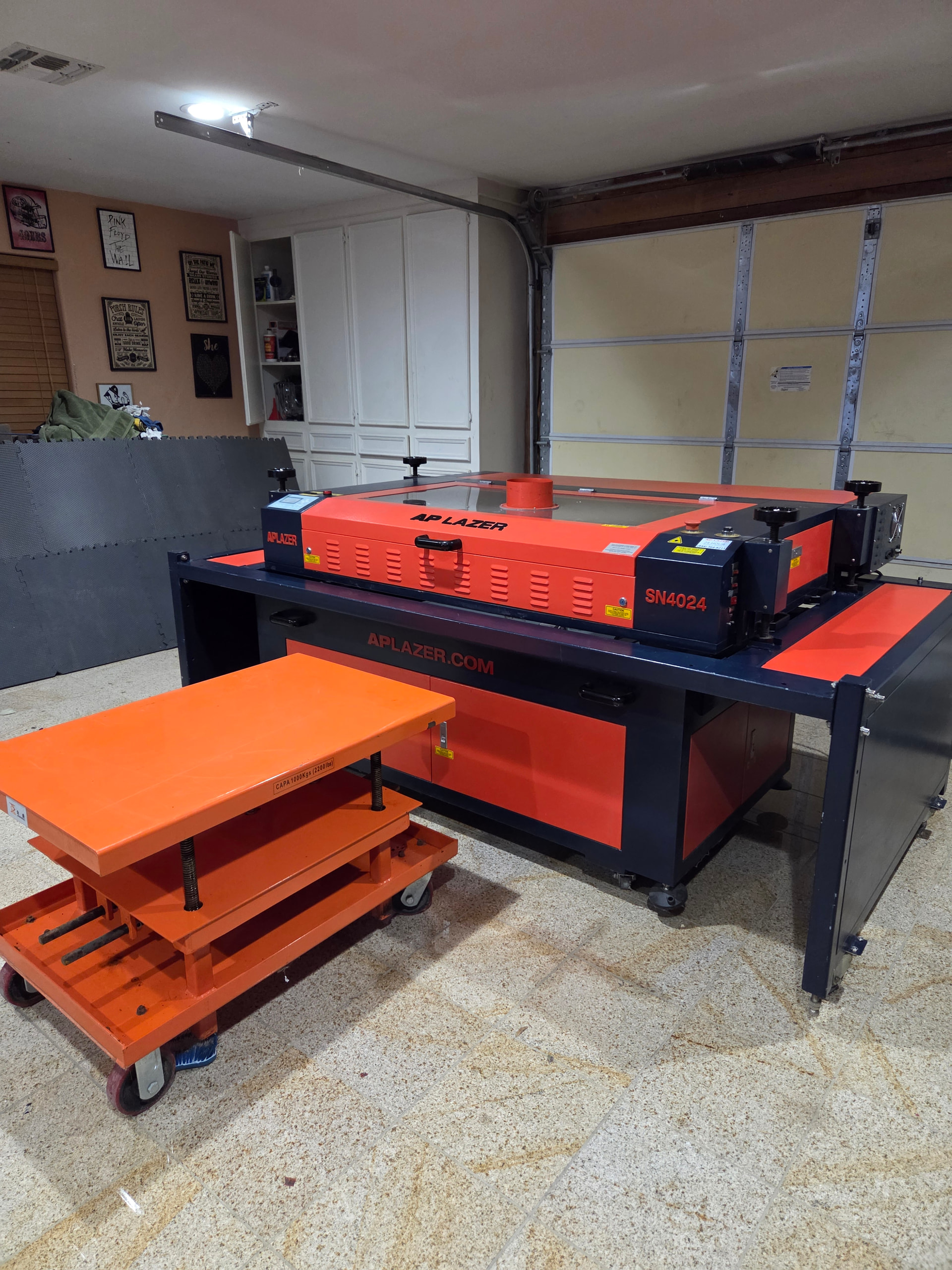

AP LAZER SN4024 leetro mpc6565 would like to upgrade to Ruida controller which one is best for this ap laser?

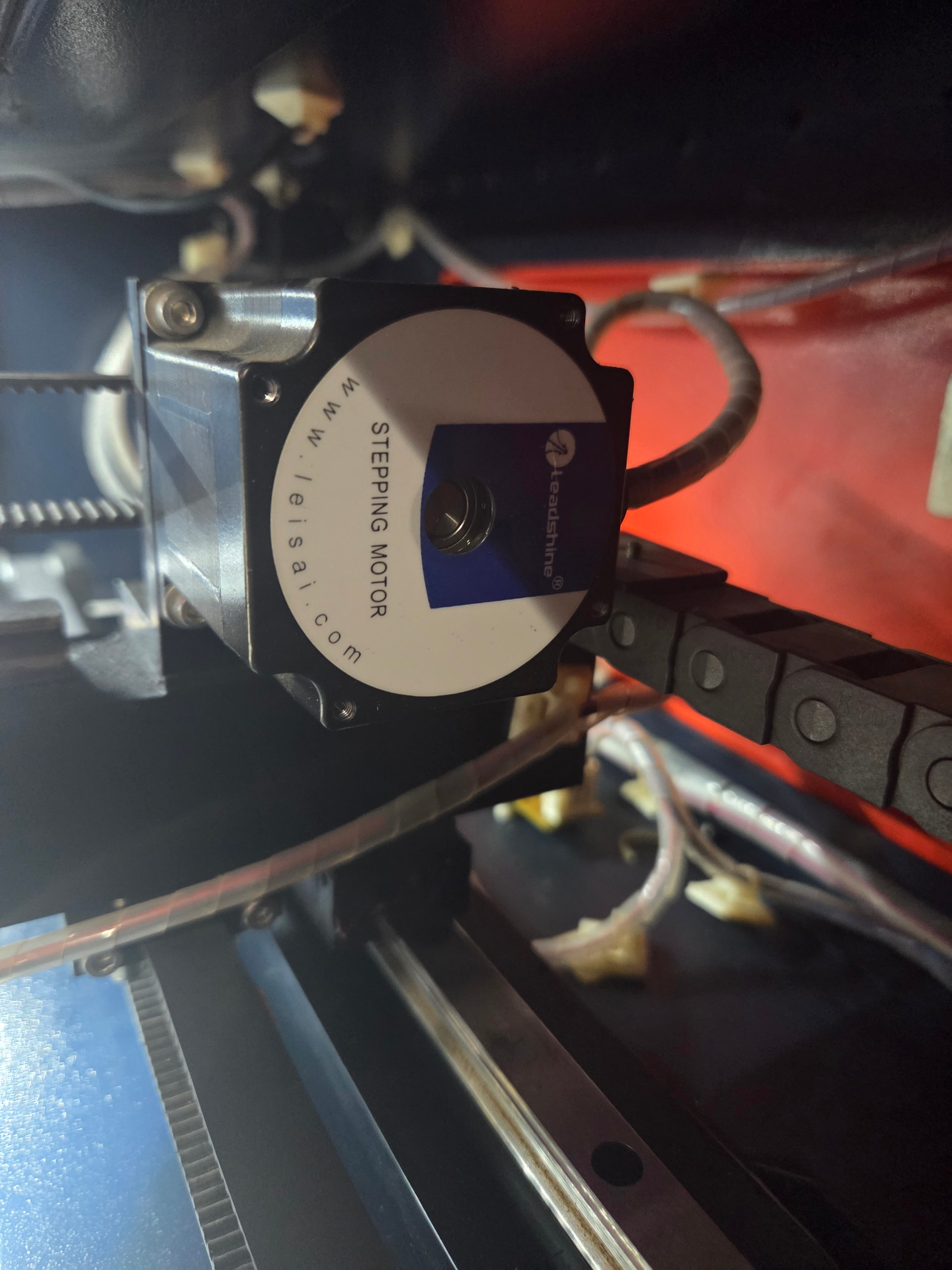

If it uses standard stepper motors and has a standard glass-tube laser, then any Ruida controller should work. If it has dual-laser MOPA heads or fancy camera handling, then standard Ruida controllers won’t work.

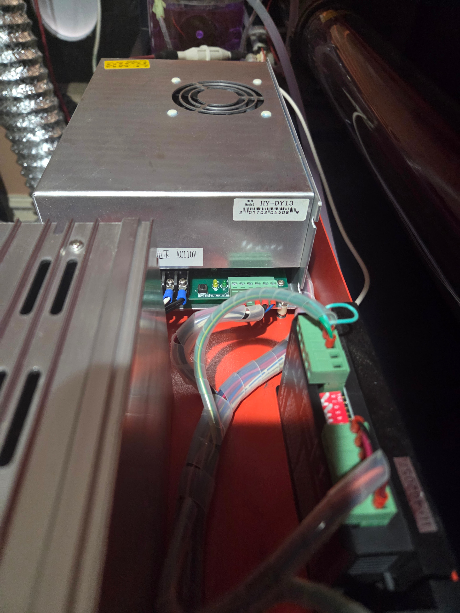

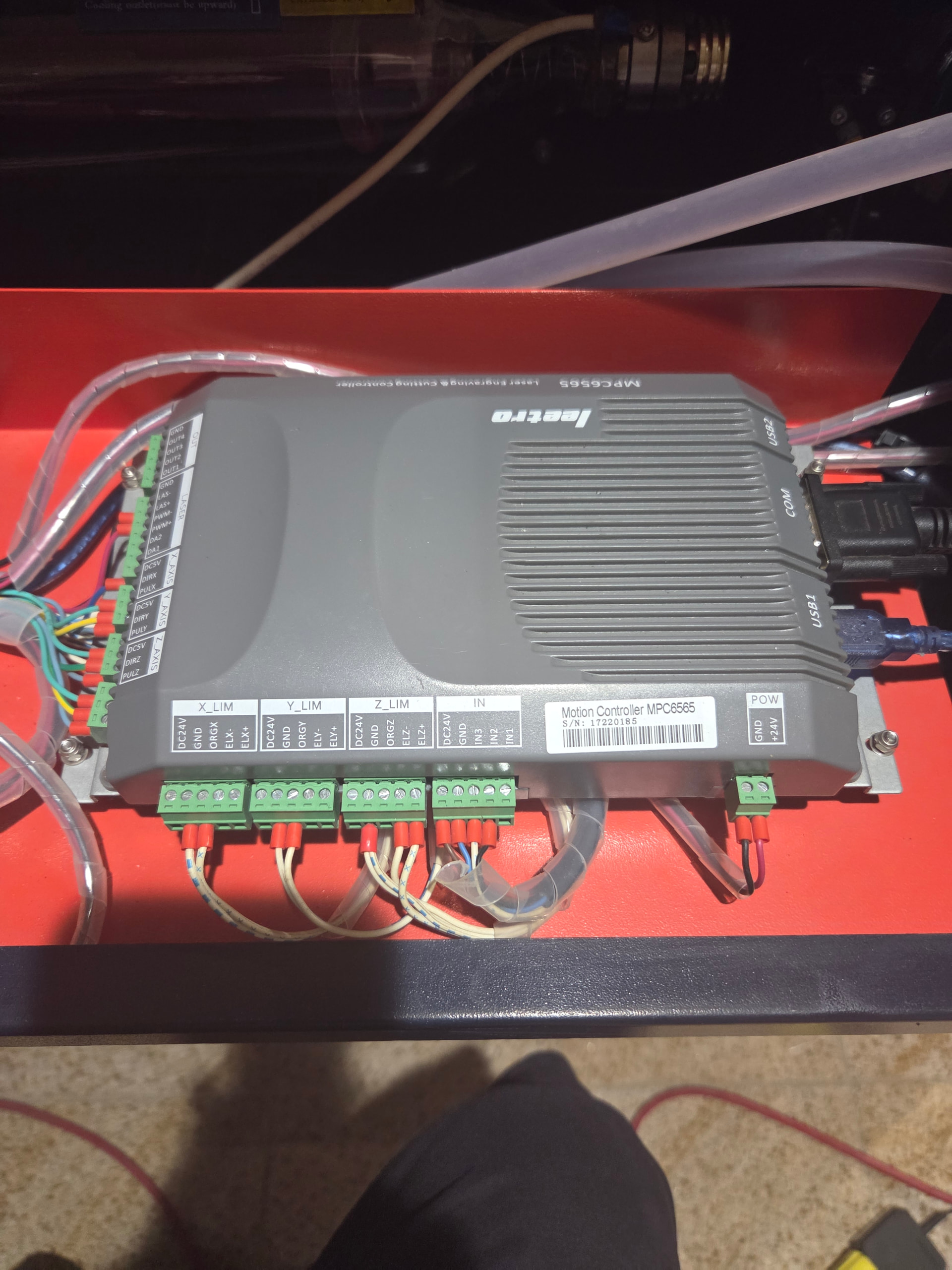

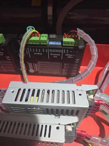

Photos of the existing power supply / controller / stepper driver terminals (with visible labels) are essential, because without those we have no clue what’s in there.
However, even with that information, we won’t know vital details like the maximum acceleration / speed values.
This is not an easy project …
Good: it looks like standard everything!
Now you draw up a big table (a spreadsheet will be your BFF) with the controller terminals, starting on the far back of the left side and working your way around the case.
For example, the LASER block seems to have three wires that likely go to the high voltage power supply. Trace them to their destination and match those labels, which might look like this:
LASER Wire
GND   Black   HV Supply G
LAS-  Red     HV Supply TL
LAS+  x
PWM-  x
PWM+  x
DA2   x
DA1   Blue    HV Supply IN
Do that for every terminal on the controller.
Then you can figure out the corresponding terminals on the Ruida controller: some will be obvious, others may take some puzzling.
After you trace all the wires, post it here so the hive mind can think it over.
