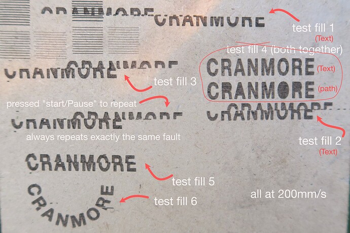

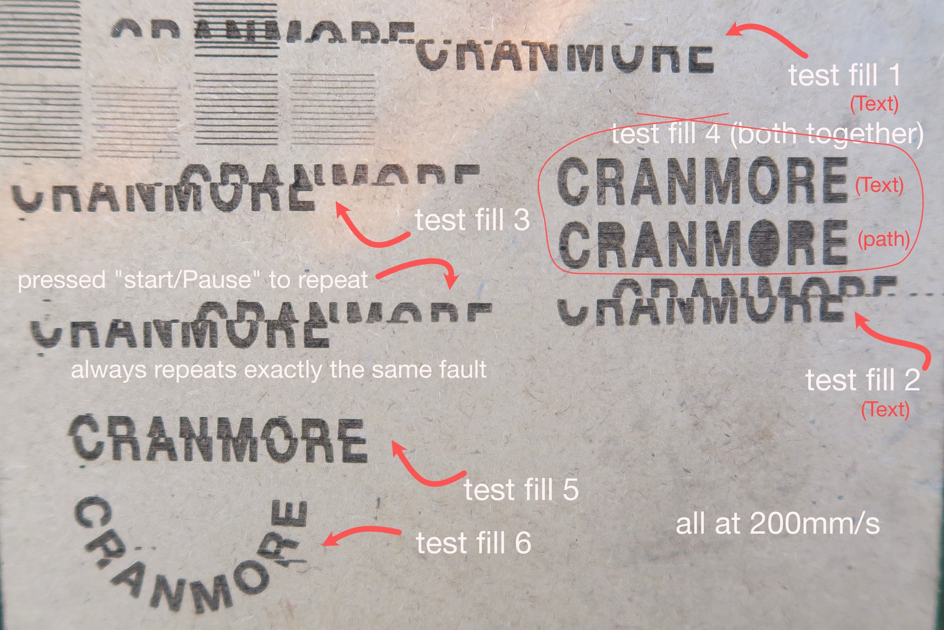

I have been very happily using the fantastic Lightburn for about five years with no issues, this week mid-job the power instantly dropped by about 50% and images being filled, especially text started to jump about on the x axis, I can burn, say, some text or filled image and it will jump at some point in a different place randomly at each send, importantly, if I press start/pause on the Ruida controller to repeat the job it repeats the fault exactly. If I turn text to path it will still glitch, but if text is put with paths as in ‘test 4’ often it is fine…
Anyone seen anything like this? Over the last few days I have started and restarted the computer and laser about fifty thousand times!

That evidence says @jkwilborn has it: something has gone wrong with data transmission to the laser. Because it’s damaged in transit, running the same stored-after-being-broken file will produce identical results.
If you’re using USB, do exactly as he says. You can try using a better cable, because its connectors may have been damaged after being plugged & unplugged a zillion times.
If you’re already using the Ethernet port, then it’s likely the router on your network has handed another device the same IP address as the laser. Fixing that can be either straightforward or impossible, depending on how your system is set up.
Let us know how the laser is connected so we can proceed …

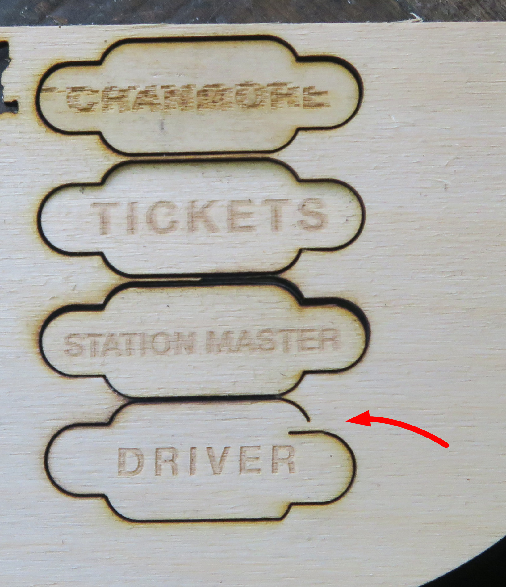

Not sure if this is another clue, but after several cuts, the final few centimeters cuts a reduced scale or curls in on itself, this happens most times…
An intermittent communications problem will eventually show up, so a relatively short job will have relatively more problems near its end.
