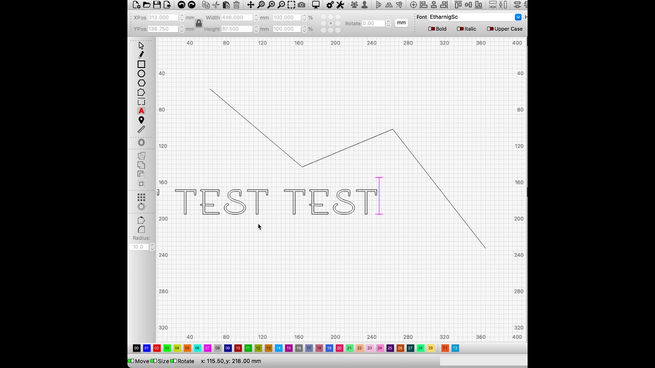

Hi, I’m new to LightBurn and to engraving.
Can anyone here tell me why can’t I use this feature on LigtBurn, “apply path to text”?
It seems to be not activated when I’m trying to click on, under “TOOLS”.
Thanks,
  1. Draw a line, or shape
  2. Write text
  3. Mark both
  4. “Apply Path to Text”
sign back if it does not work for you

Have the same issue trying to get the text to follow a curve. Tried the “blue dot” but never found one and also the “text on a path” but in the tools menu the text to path is grayed out.
Is there something in settings menu not set up correctly?
Rick
What version of LightBurn are you using?
Have you followed the video instructions from @bernd.dk? He has done a step-by-step tutorial.
If yes, then upload a screenshot of your setup and where you see it going sideways.
Was this “text” generated using the ‘Text’ tool in LightBurn. The options for bending text, or to have it follow the path of a shape, requires the text to be text primitives in LightBurn. If you have converted this text to paths already, these bending tools will be grayed. Same applies to other text controls, like H/V spacing, welding, and the like. Text is special :slight_smile:, so once converted to paths, we lose these special controls associated with text, like bending the text in a simple way.
Yes the text was generated in lightburn but the curve that I am trying to match it to was a circle from lightburn and then converted to paths so a arc could be made and then attach the text to it.
Version I don’t know at this moment but it was purchased in 4/2020. .
Will try new text and a unmodified circle and see if that works.
