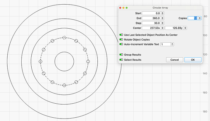

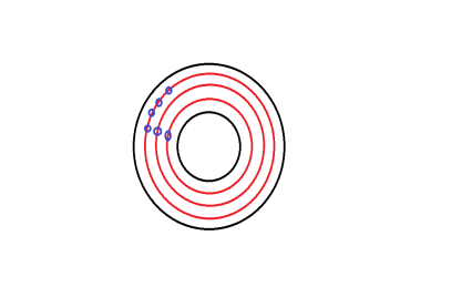

I’m trying to make a wooden poke wreath plan. This is a circular piece of wood with a hole in the middle. I need to arrange drill holes along 3 offset circles evenly
Could circular array be the right tool for the task?

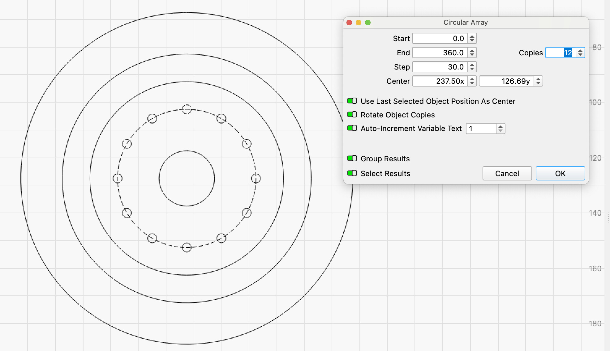

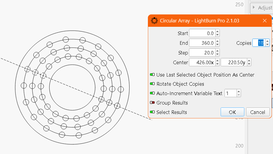

Draw the circles and and a line crossing the center, then select the 3 circles and the line and apply the Circular Array
Make sure your Center X & Y is the center of the hole in the middle.
