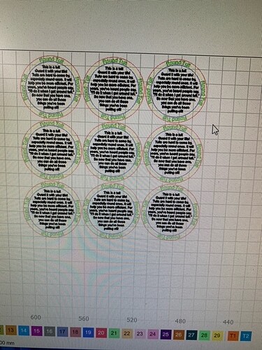

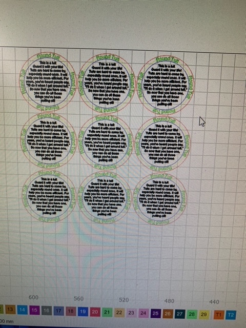

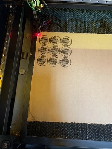

I have created an array of 1.75" discs and although the array looks good on my lightburn software, it drifts on the cutting surface. I have an OMC-Tech 60w co2 laser with Ruida controller. See Pictures…

This is likely a mechanical issue - check to make sure your belts are tight (specifically for the X axis in this case), the wheels are not snagging anywhere, all your stepper pinions are snug, and that there is no dirt or debris on the rails. Slowing down your job speed may also help, if it’s set to a relatively aggressive speed now.
