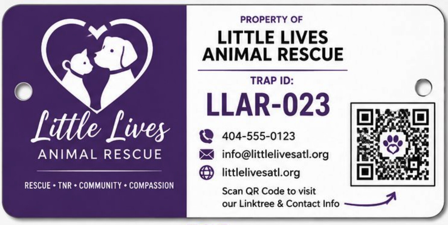

I am sound some pro bono work and rather than do a full redesign, I imported the “screenshot” file into illustrator, changed everything to vectors, then exported as an .svg. I then imported into LB. I have some artifacts or if you look close, they are little black dots in my image in LB. Didi I do something wrong in AI, or is there something I can do to take them out? I tried turning off layers, but that isn’t working. Before I just do a redraw in LB, anything I can do to clean this image up for burning? BTW, my friend generated it with AI, I guess from some tag place.
Thanks.

You may try adjusting the image to 1024 DPI then Trace Transparency with Fade Image option ON and adjust.
For the QR code maybe it´s better to create a clean one in LightBurn.
