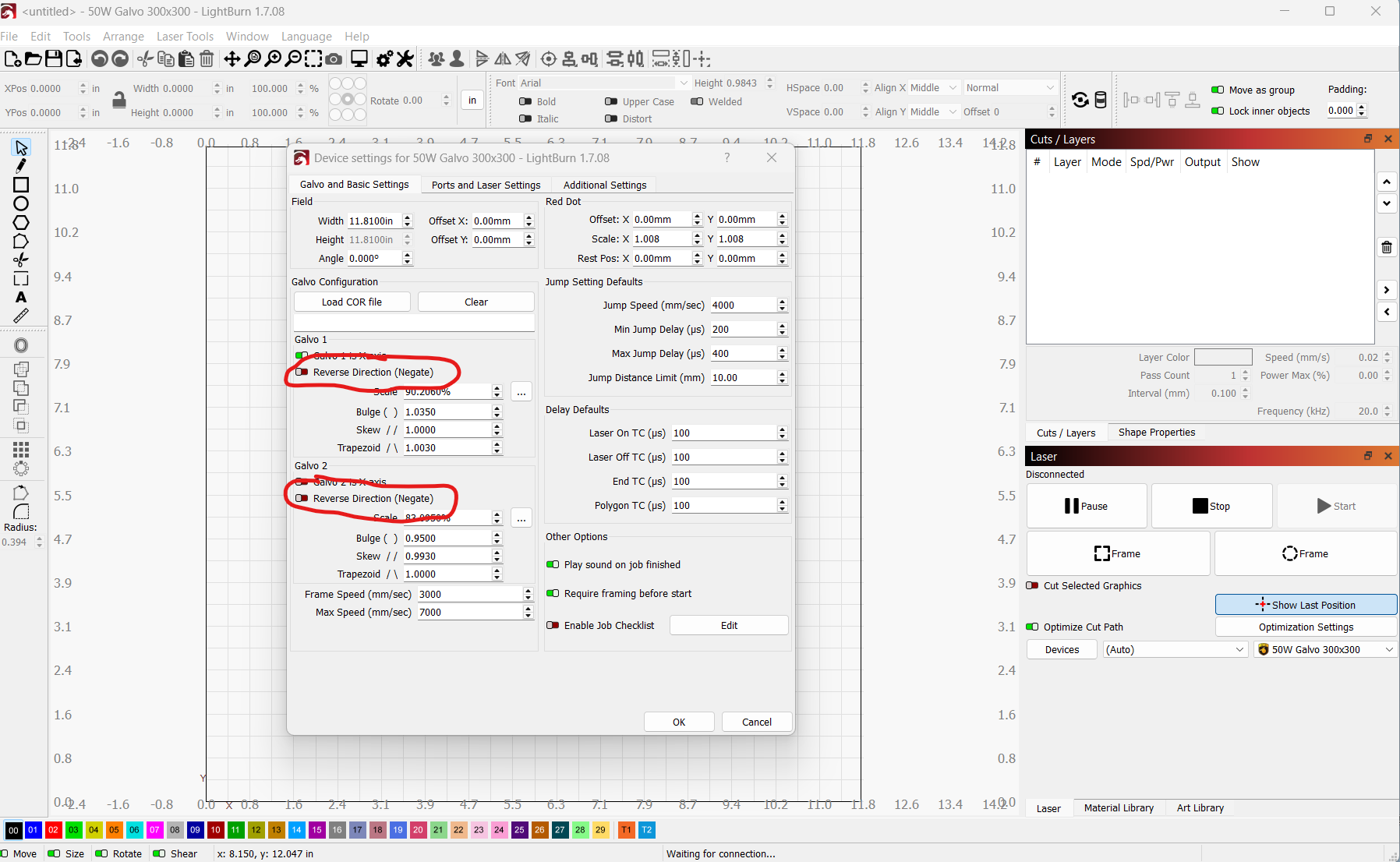

I updated Lightburn to 2.1 and now my artwork is rotated and flipped when I send it to my Monport Fiber Galvo. All of my Galvo and Basic Settings are still set correctly before the update. How do I fix this?
If I remember correctly it’s these settings. Try one at a time.
Thanks. I tried that but it didn’t make a difference.

During my setup, I utilized the 9-point calibration option, but the orientation failed to register correctly. It appears that all objects are being rotated 90 degrees to the right on the X-axis. Specifically, elements that are positioned at the top of the workspace appear on the right side of the laser bed. I attempted to engage the “Reverse Direction” on both the Y and X axes individually and together. The orientation changed, but not correctly.
To troubleshoot this, I removed Version 2.1 and reinstalled Version 2.05, which immediately restored the correct orientation. Consequently, it seems that I am currently unable to use Version 2.1 due to this calibration discrepancy.
