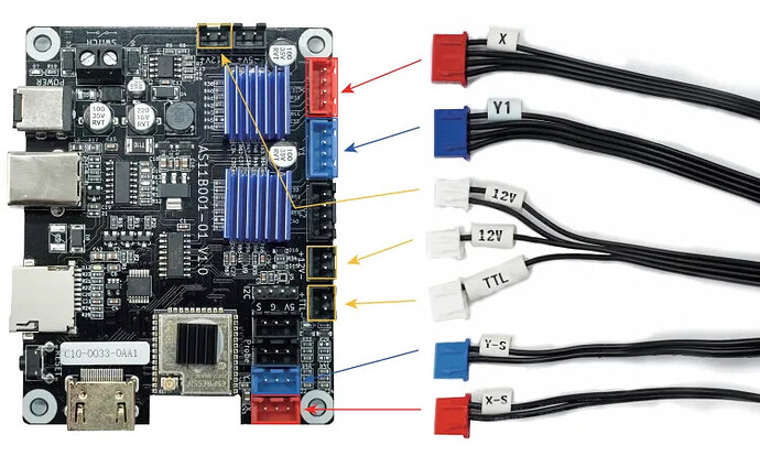

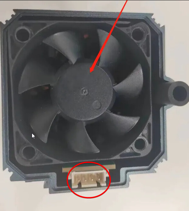

mmm as you have a volt meter, i believeyou can test if you have - at laser head - 24v and PWM signal
Unsure how your wiring is maybe you can send a picture?
That would be the control board? Not the laser head unit correct?
would be on the cable that connects to the laser head itself
You want to verify if the laser is fail to trigger OR if the motherboard/Wiring is failing to deliver the trigger signal
might be a bit technical unsure if manual has a pinout of the wiring on laser head
You need to test the cable that plugs here

you could inspect the output at the motherboard connectors, those should be labeled
If the PWM and 24v(if its 24v) exit motherboard you should then be able to use multimeter to identify which connector is which on the other end of wiring
Also test continuity to guarantee your cables are not broken
IF all is set, this means the issue is at laser head itself
bottom image of reference
TTL and a ground will give yuou something like 0 to 3.3V on multimeter if testing 20v/DC scale
3.3% would be 100% power, 0.3% should be 10%
then also test the 24v or 12v
Lastly unplug the laser cable, and test continuity at both ends, would allow you also to find the pinouts
