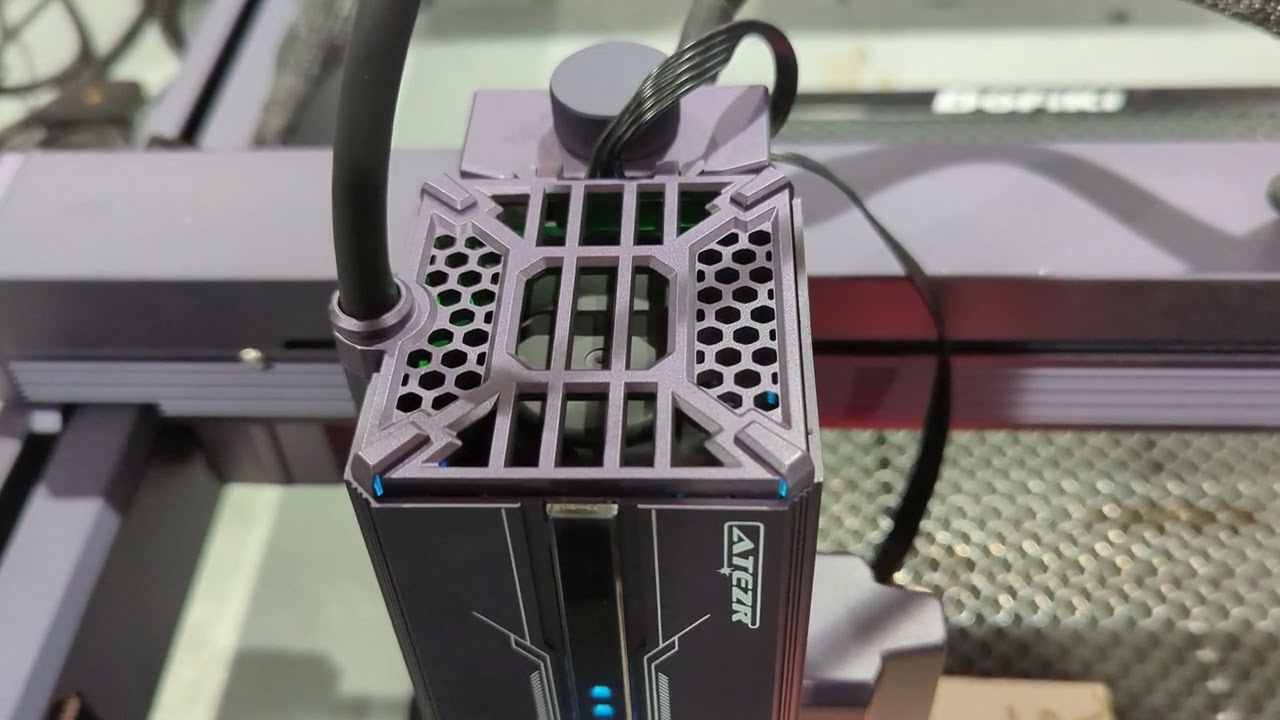

Hi. I have new L2 36w engraver and the autofocus does not work. I have wood under the micro switch so that part is correct. When I go through the onboard menu and try autofocus the Z axis motor locks up and the unit freezes. I have also tried the autofocus macro in light burn and grbl and they do the same thing. If I start the autofocus process and spin the Z axis thumb wheel, the auto focus will start and usually work…but only if I spin the wheel by hand. I have contacted Atezr and went through a week long process of useless question from them and gave up. I’m at my wits end…please help. Heres a video of what its doing https://youtu.be/0uVub9MCnvQ?feature=shared
My Z axis guide rods were way out of whack. I completely disassembled the axis and re-aligned and tightened everything, then put a tiny bit dry lube on the rods and threads. Smooth as butter now.

Mine did that. Your guide rods are probably poorly aligned. Loosen them top and bottom, run the axis all the way up by hand, snug the top screws (not tight), run axis all the way down, snug those, run up again, tighten the top ones, run down, tighten those. Apply a drop of lube (I like dry Teflon chain lube) to lead screw and guides, then run it up and down a dozen times. There’s a certain amount of “feel” to do work like this…
If you’re really concerned (or anal. Like me.) You can pull the rods and roll them on a flat plate (mirror glass is good) to check for bends, flat spots, etc. Not something that easy to fix yourself, but good for diagnostics.

I had the same problem. The laser was sitting too high in the adjusting cradle. I lowered it till it hit the material and lifted it about 5mm. Fixed.
I’m having a similar issue. I"ve disassembled and tightened the rods. How did you align them. When trying to autofocus my laser head travels down but it seems like the laser light shield is contacting before the limit switch. For now I’ve taken the shield off and it works fine, but I’d like to be able to align is so the head travels down straight and level.
For rod alignment, or spacing, I cracked the 4 screws loose, run the carriage all the way up, snugged up the top 2 screws, run the carriage all the way down, snug the bottom 2 screws, run all the way up, tighten the screws, run down, tighten the screws. Test. The carriage should move smoothly and fall under its own weight.

I too have the Atezr 36W and recently started having the issue where the top Z limit switch isn’t getting activated. I took my Z setup apart and played with alignment for several hours.
Here’s what I found:
The bolts for the vertical rods sit in self-aligning pockets. If you tighten them they snug up the bars towards the center of the unit and binding occurs. I suggest just snugging up the 4 Z rod bolts to get the best possible alignment and use loctite to keep the bolts from backing out. Or you could gently tap on the bolt threads with a hammer to mash the threads a tad so they don’t back out easily. I don’t like method 2 as much because you can’t undo the damage.
The Z stepper motor leadscrew also needs to be perfectly aligned with the two Z rods. Any minor difference in alignment between these triple trapezoids from hell and you get the dreaded binding. I have no idea how these left the factory in working order.
This Z axis design was a great idea with poor execution. A little slop in the Z rod holes and pockets would have allowed for better “alignment-ability”. Maybe 4 longer bolts and 4 washers (so the bolts can’t sit in the pockets) may be the way to go. Have not attempted that yet as I just thought of it as I was typing. The Z endstop location and proximity to the bolt holes may throw a wrench in this idea though.
