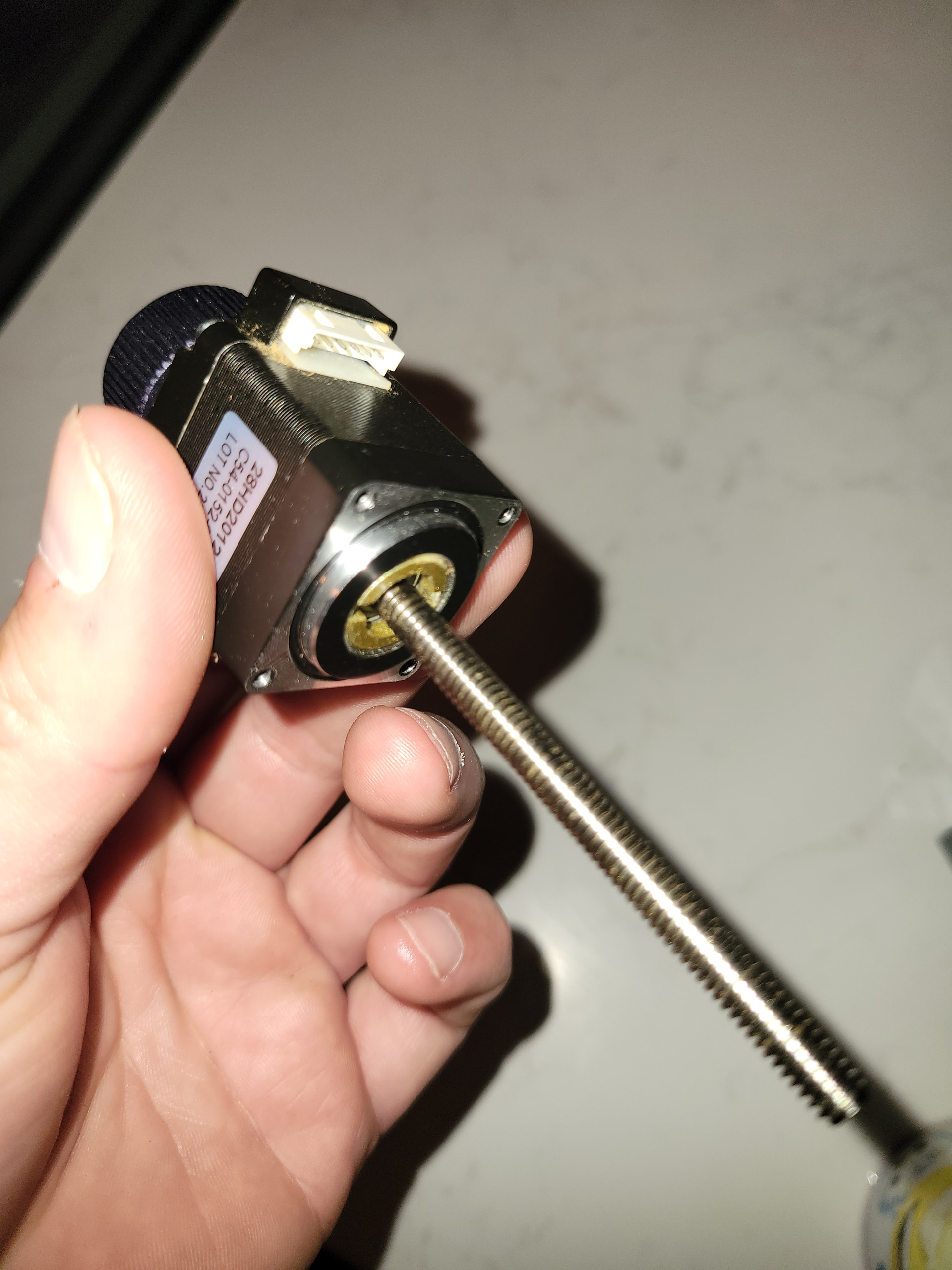

Wondering if anyone could assist me with a Z stepper motor issue? I think something must have fell on my Z axis when either in storage or when putting into or taking out of storage becuase I setup the laser today to run a project and when homing the Z would move up towards the limit switch then without warning would start to move down and stop. I would try to manually move the Z up/down and it would move in the wrong direction until I touched the knob on top of the stepper motor and then it would move in the correct direction. When moving the Z manually down with the knob on top every one rotation I could feel a skip and it would drop a few mm leading me to believe that one of the teeth inside might be damaged. This is why I think something fell on it possibly breaking or damaging one of the teeth.
I would like to replace the motor but with Atezr no longer around I’m having trouble finding the correct replacement.

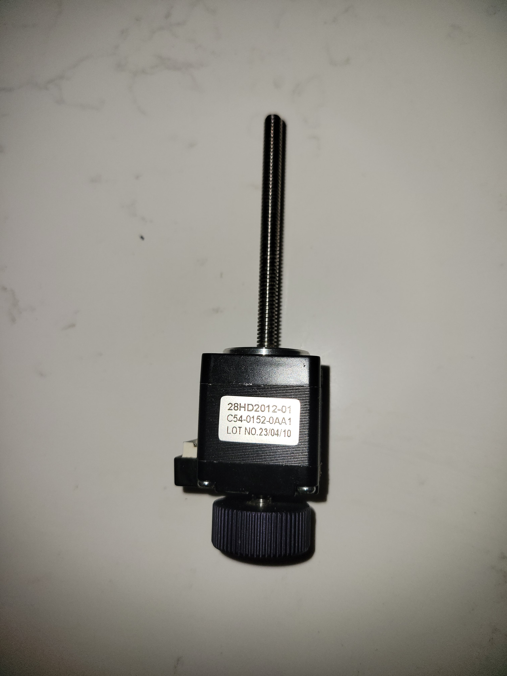

Here are the numbers on the side of the motor:
28HD2012-01
C54-0152-0AA1
LOT NO.23/04/10
Any help or guidance is greatly appreciated!

Hi Aaron. Yes, this is the exact Z motor from the machine and it’s a Atezr L2.
I have found this from iKier and it looks like the exact motor so I’m going to give it shot and see what happens. iKier Z-axis Motor for K1 PRO 24W/36W/48W/70W V2 Laser Engraver

What I was trying to ask is whether you tested the motor to see if it ran smoothly once it was disconnected. (You probably did :slight_smile: )
A motor rarely breaks, but the mechanical parts might.
Still, your initial description rather suggests an issue with a limit switch or wrong settings.
This could have been the powered motor. Does it rotate smoothly, now that it’s disconnected?

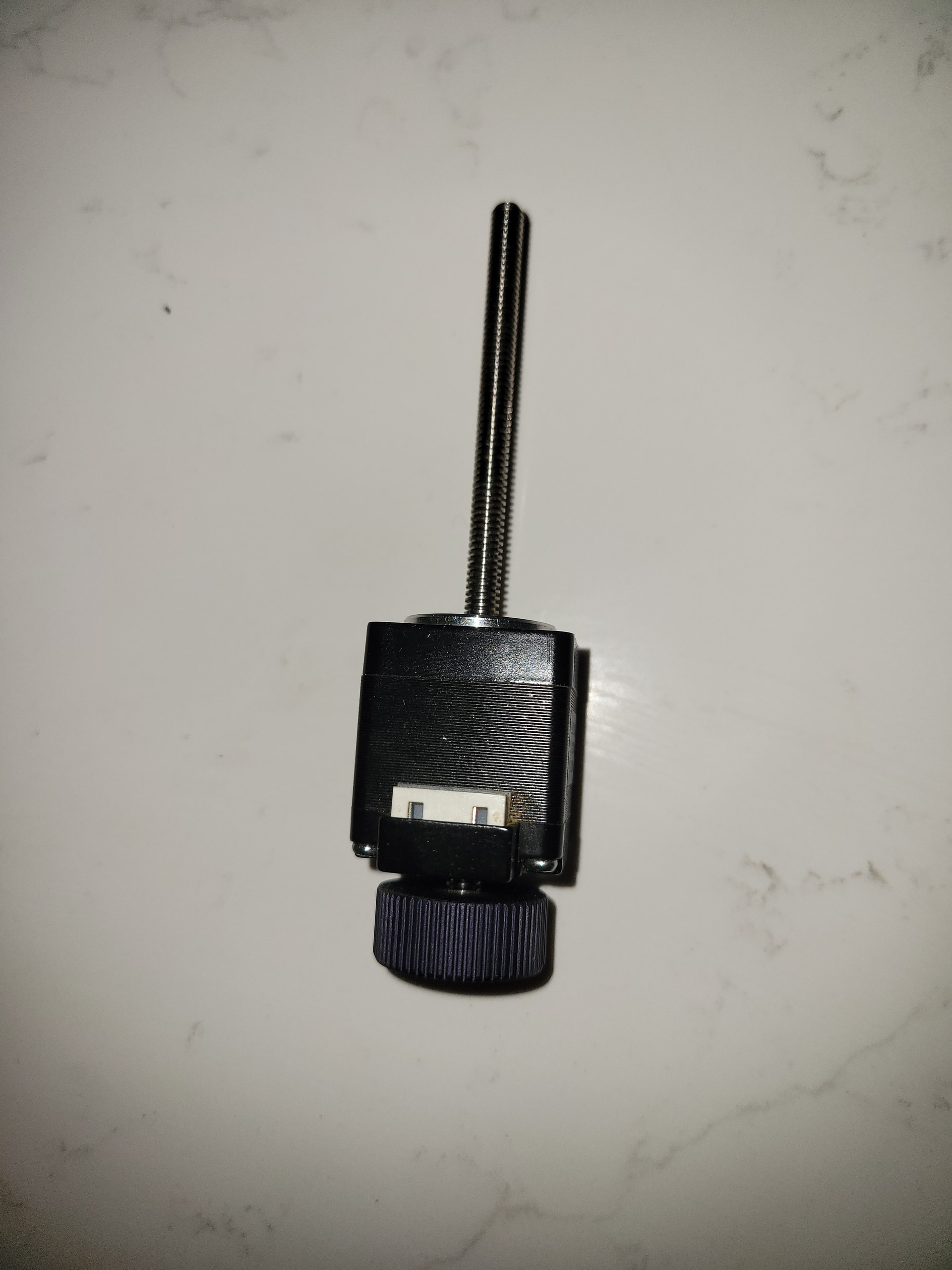

This is kind of hard to explain but as far as I could tell the limit switch was working fine because I could depress it with my finger and Lightburn would recognize it and would move on with homing the X and Y. What I did notice though when the Z was going through it’s homing process was anytime I would put pressure on the knob at the top it would either stop the Z movement, continue the Z movement (if not moving because it was stuck) or make the Z change directions. I could hear the motor working so my initial thought is something inside is damaged causing it not to catch and move the screw properly. Just my thought.
thanks for the additional information. Based on that, I’m actually less convinced the mechanics in the motor are damaged. Simply applying pressure to the knob shouldn’t normally cause the motor to reverse direction.
Since the connector is directly beside the knob, pressing there may flex a loose pin, wire, or solder joint enough to restore or break contact.

The connector appears to have six pins, suggesting the motor has center-tapped windings. If everything else checks out, we can walk you though verifying the windings are in good shape.

That “slight bump” you feel may be enough to stall the motor, particularly when it’s trying to lift the laser head.
When the load on a stepper motor exceeds its ability to turn the shaft, the rotor will fall out of sync with the rotating magnetic field produced by the driver. It can then stop while shuddering or turn weakly in either direction.
The symptoms exactly match the behavior of a stepper motor stalled due to an overload.
Many things can happen to an unused mechanical device. In particular, lubricating oils can thicken, attract dust, and gum up the moving parts. If the Z axis was just barely working before, it’s just barely not working right now.
It will be worthwhile to clean the Z axis guides / rollers / whatever to ensure they move smoothly and freely, as they should.
