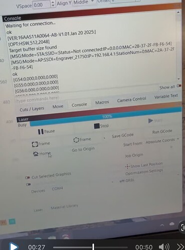

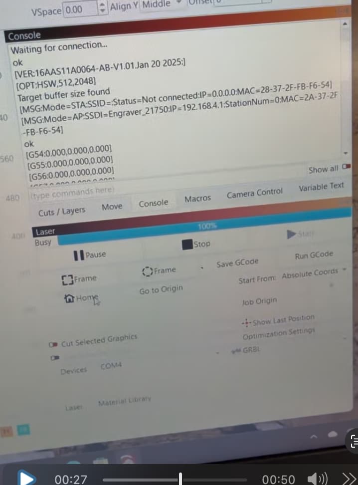

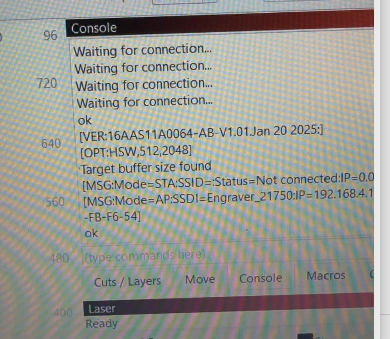

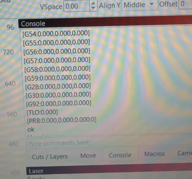

thanks for replying. Well I ordered a new windows laptop installed Lightburn,all the needed drivers, C++, and configured the device to Grbl on port 3. Still nothing. I think this new adomstack 70 max controller took a crap on me.
Bummer! …To see if this is true, try these tests first. It will also give Atomslack proof that you diagnosed the issue.
First, try using a different USB cable, preferably one that is shielded and has a ferrite knot on one end. If no luck, then…
Power up the PC, Power up the laser, connect the USB cable.
→ Does it sound the Windows USB connected tone?
Yes:
Open Lightburn. Open the Console window.
→ Does it list a bunch of stuff ending with “ok”? If it does, copy and paste that stuff here.
→ Does it mention any error messages in the window? If it does, copy all the stuff in the window here. One copy is enough.
No:
Windows Administrative Tools → Computer Management → Device Manager → Ports → USB -SERIAL CH340 (COMx), or something like it.
→ Do you see this in the window?
→ Is it listing COM3?
Basically you should not be able to harm the controller board no matter what you send it for GCode. However, I do not have the source code for your board, so I cannot be 100% sure it did not happen to yours.
Good Luck!
tr
It is connecting and talking to the laser, suggesting it is not the controller board. If you get intermittent communications breaks, replace the USB cable with a quality shielded one that has a ferrite knot on it. And limit the length to no more than 10’ too.
