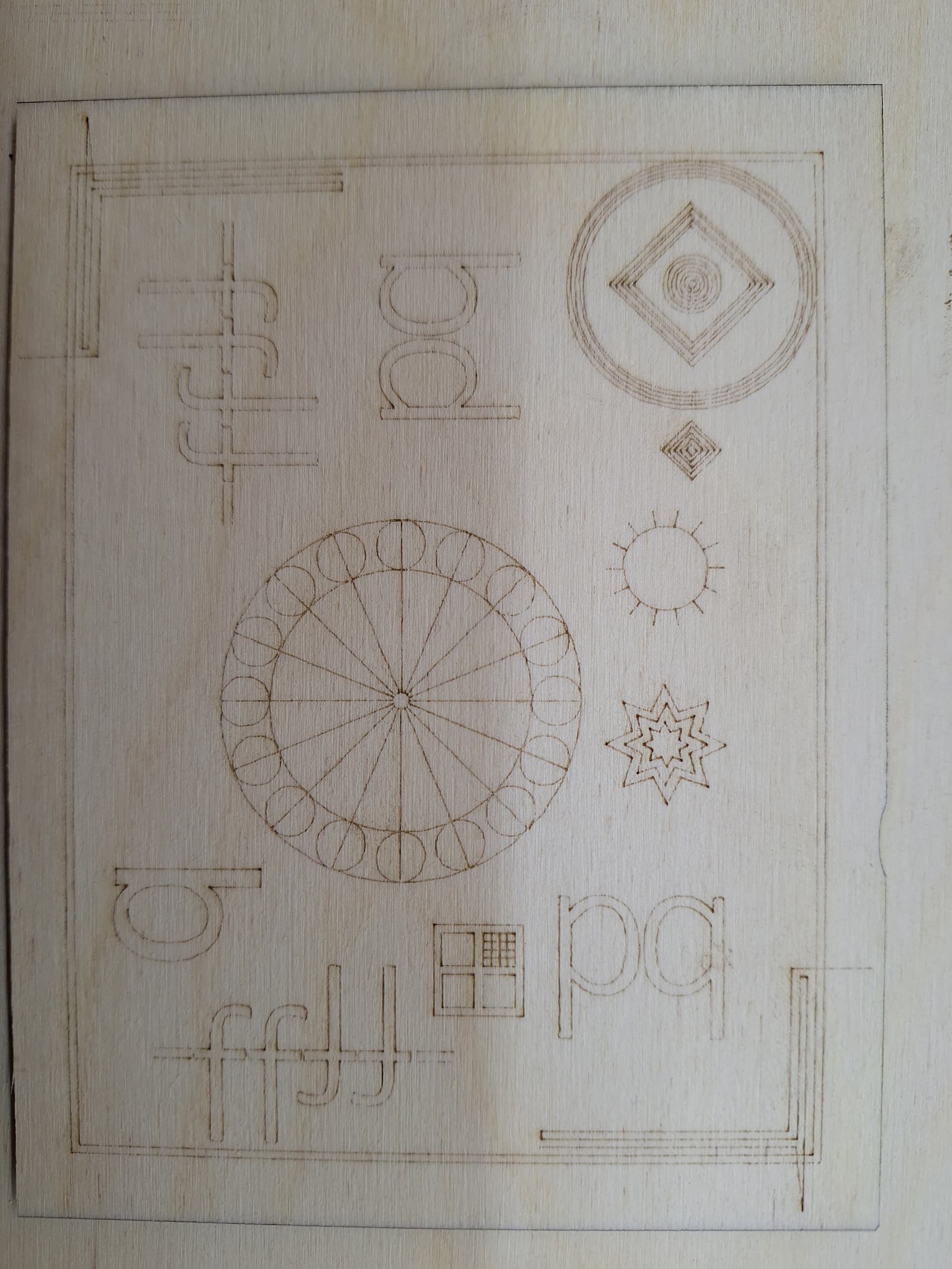

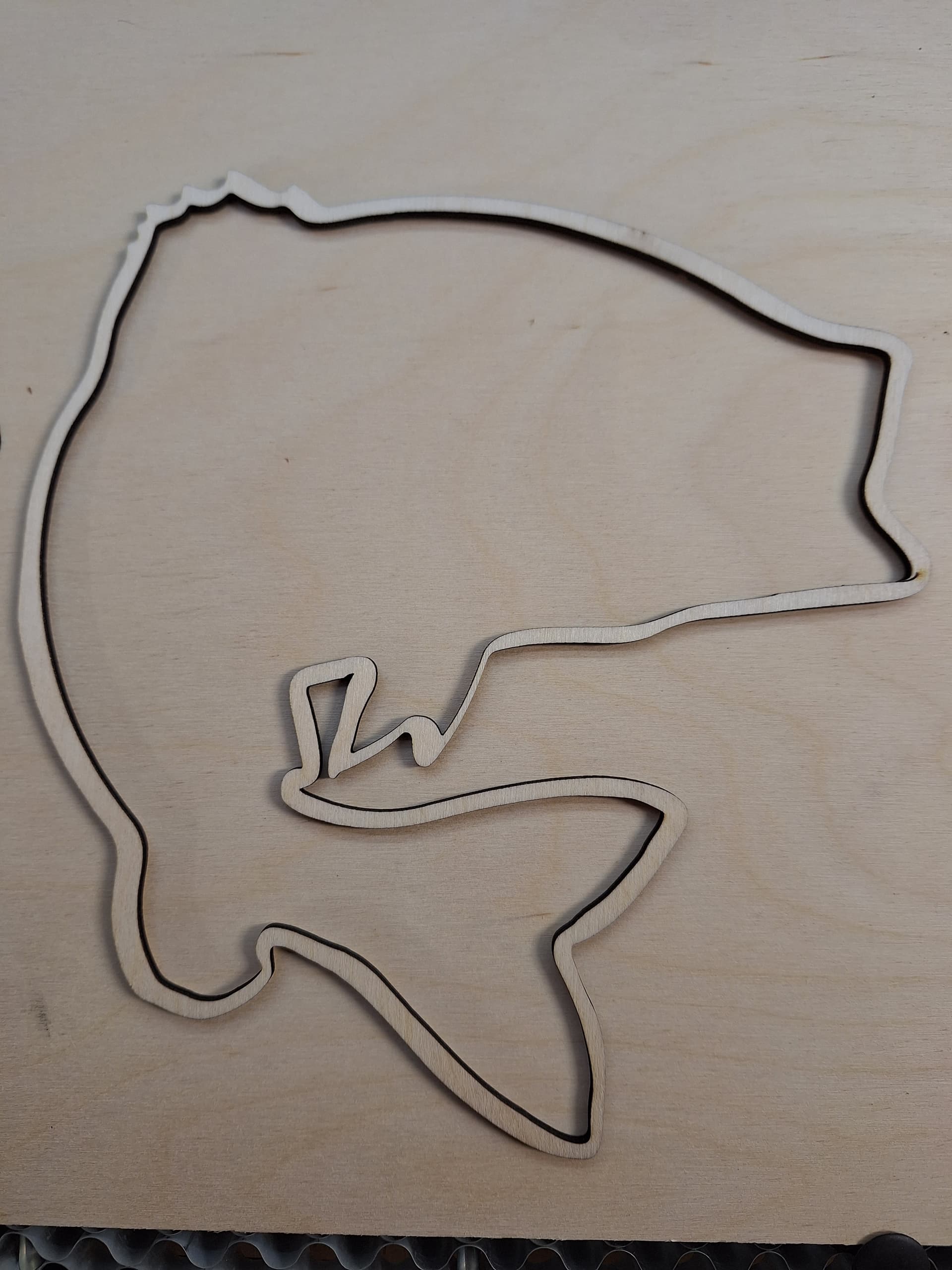

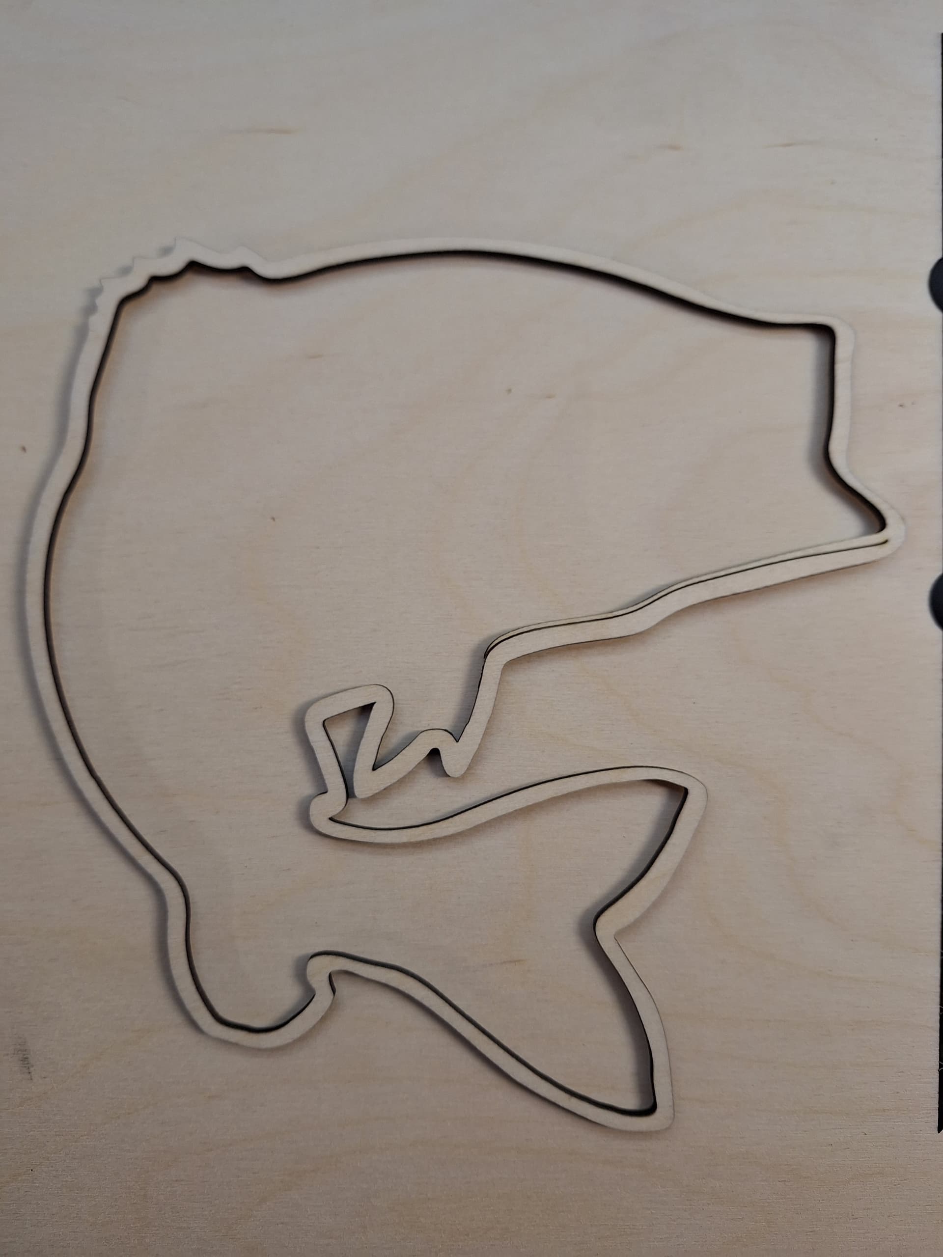

Im new here an only have had the atomstack a40 max for 3 weeks. ive tried to cut out a few mandalas but they dont line up 100%. my biggest problem is it cuts super thin in spots. i need some advice on this

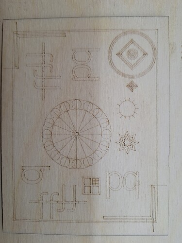

It seems you have slope in you machine. Run the job in this post
Then post here the output for us to look.
And you have here some correction measures:
Go trough the links above and check your Y, clean rollers and ways, check frame squareness and squareness between X and Y, give a good mech overhaul and lubricate slightly your X linear guide.
Edit: Forgot to ask if you setup your laser as plain GRBL and not GRBL-M3 or GRBL-LPC?
I set it up as just GRBL. I looked at it for a little bit and the gantry was off a little bit when I push it against the back, so I got that adjusted where each side hits the back at the same time. need to run a test again but hope that is the problem.
