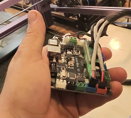

Well I emailed ATOMSTACK and I was informed that the unit can’t have limit switches nor air assist. I was able to add limit switches. And they work great. But, everti e I power off the machine it loses the grbl programming for them even after I have “written” to the controller. So looks like ATOMSTACK handicapped the controller.

Show some pictures of the board. This might help.
Losing settings means you have to set $5, $20 and so on each time again? That’s bad. You could write a macro in LB to set all values on a click, but that doesn’t cure cause. I think I would go for a mainboard change, if they didn’t change all connectors for proprietary ones.
yes, it does, every time I lose power. yeah, I think I want to go to an offline controller with Wi-Fi. I am not sure which one LOL.

If I had this problem, I would not let doing the connectors stop me. You only have to do that once, and then you are compatible with many replacement boards.
I concur, changing connectors or pinouts is no problem for me. I just don’t know which board I should go with…
That’s a great old board with a lot of freedom to tinker with. :slight_smile: It looks like a 8bit Atmega-driven board. You can flash plain grbl firmware where you have control over everything. The only thing you need to find out is the pinout, but I guess they were using the standards mostly back in those days. The board has the required output pins that you can use to drive a relay for the air assist, as well as door sensor and buttons. Of course, you can add limit switches here. Stupid support, as usual. You can even add a z axis, probe sensor and more. Check out the pinout of the MKS DLC (not DLC32), this should give you a good idea of the pin out.

My first thought also, looks like first MKS board.

thanks for the info, flashed it to grbl 1.1 and it looks good so far, it is holding the settings to the eeprom, a3 work with the m8&m9 command since the ssr can’t fit in the case I used a jst plug on the header and a pigtail on the other end to go to the ssr when it gets in. works well so far but time to do the testing.
it took a standard GRBL rewrite to 1.1 and enabled everything that i needed
