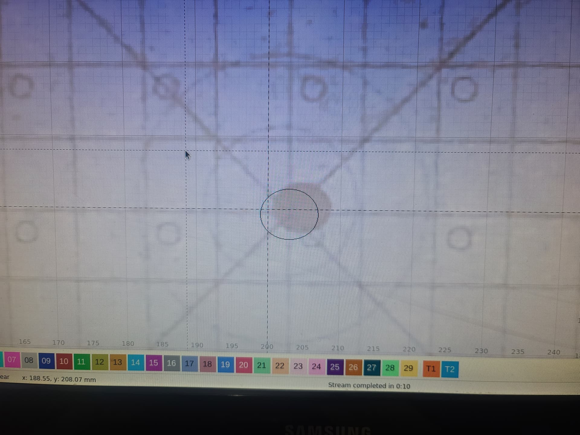

I jsut got the atomstack camera AC1 I have it working under Unbuntu linux. I have had this issue with a different camera under windows but thought it was jsut the cheap camera.
When I setup everything I take an overlay image of my work surface I then do a test to see how accurate it is. it seems to be off when it burns. it is off. how can I correct or compensate for this?
As you can see when I wanted my circle and when it actually burned it.
The other image when the camera window is active it goes full width of the screen sometimes.
I am running the recommended version of ubuntui, and 1.14.00 of light burn
I know I had a cheap webcam working to align my work and it was pretty accurate
Ideas?
Thanks
When you get to this point, there are overlay offsets to make the final correction:
It’s in the Last image on the Documentation page.
X Shift and Y shift will allow you to nudge the image to correct the location.
