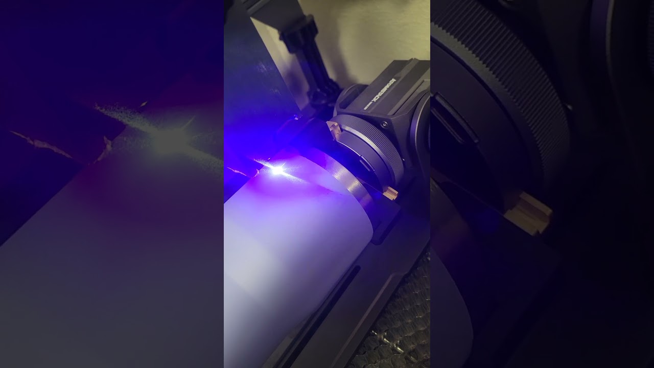

Till a few days my atomstack x7 pro was engraving good know when i try and run a tumbler the chuck stops for a second and then moves on this happens at framing and you could tell most when youn engrave and look at the image theres like a step on it where it stop. Any suggestion would help. Im new at this so please explain as if i was lost :sweat_smile:

Ill do all that and update. I do have a video that i send to atomstack. Its only framing but it shows when its stops 2 times. Just need 24hrs to get verified to post it.

Link to video
I did all that and at fast speed you cant tell but when you slow it down its noticeable.

Yesterday i took a good look at it. Im new at engraving but long time machine mechanic. With my chuck plug in i look at the belt turn, i put it upside down and the small gear was rubbing to the belt just a bit. The set screws for that are really small so hard to get a good tight, move it just a bit had it turn till it made a full turn with the belt center… I run a tumbler and it look good will see what happens
