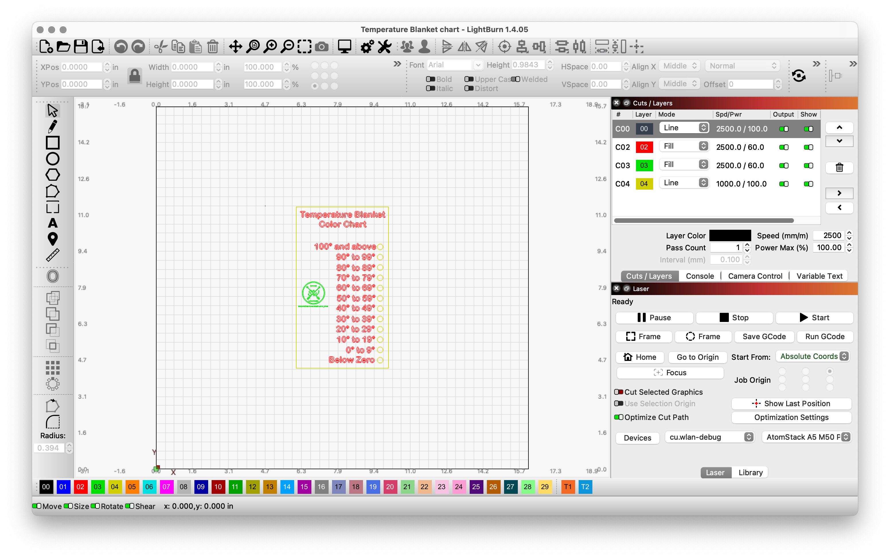

The project has 3 layers
2 engraving layers at 2500 mm/m at 60% power
final layer is a cut layer 1500 mm/m 100% power and 2 passes.

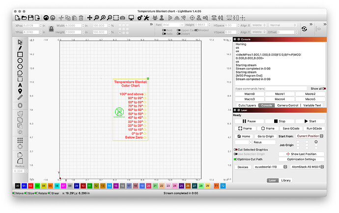

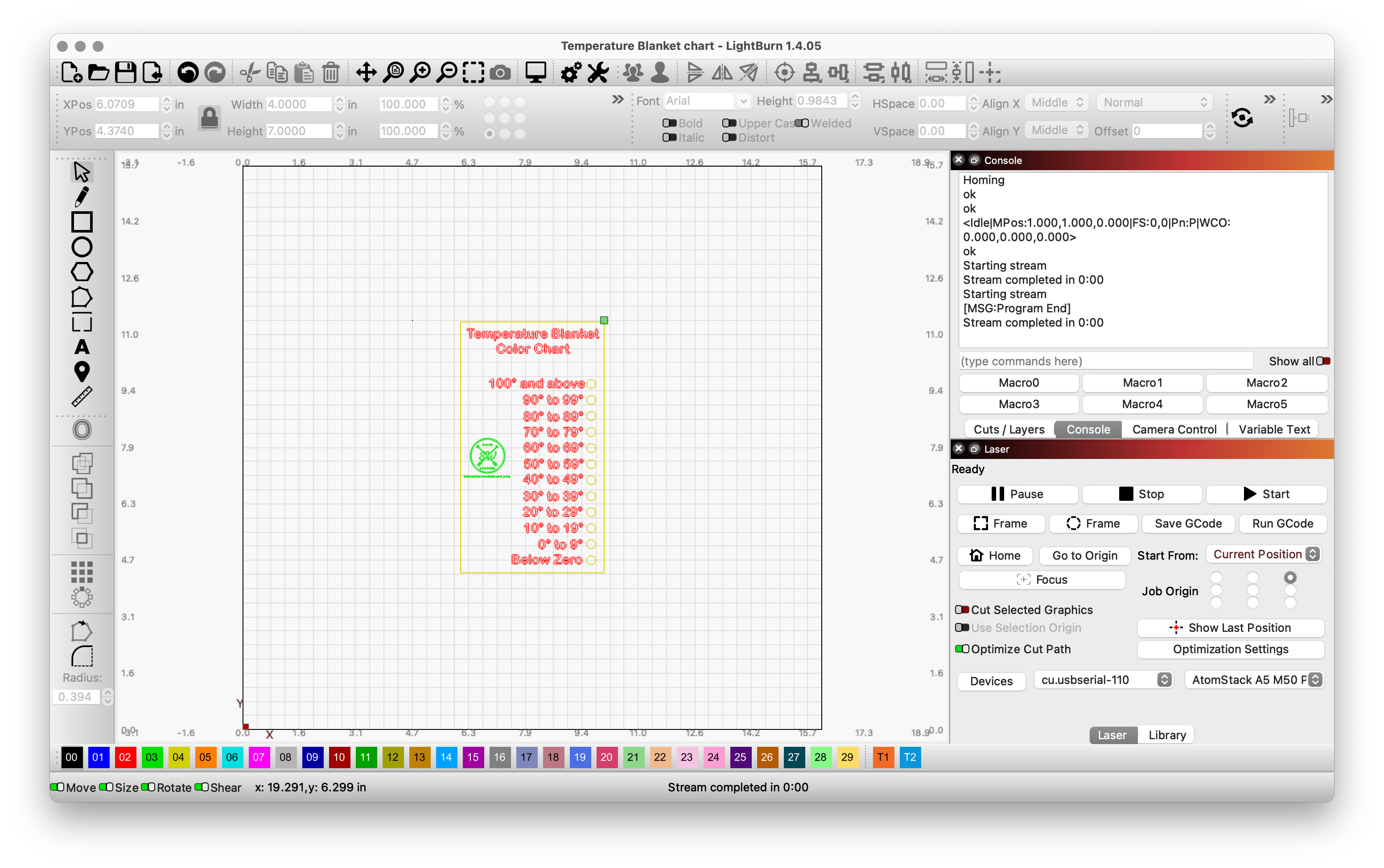

When I click ‘start’ in lightburn it doesnt run any of the layers it just immediately gives an error message.
Please post the full output of console from homing > Start > error
THat woudl be helpful
This is the layer settings
After i home the machine
After i attempt to run the design

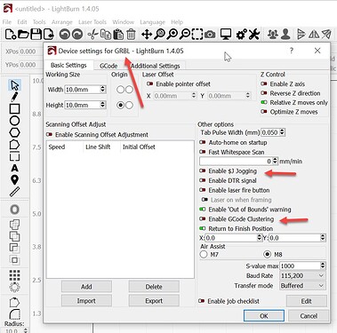

can you take a screenshot of EDIT → Device settings?

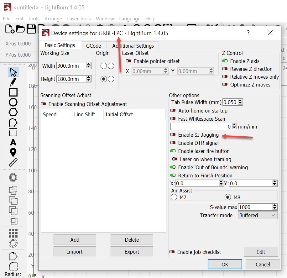

“…invalid Gcode command…” is sometimes caused by Enable Gcode Clustering in the Device Settings window. GRBL does not support the compact form of Gcode commands.
And that’s the clue.
With the Device Settings window capture shown, 'Enable GCode Clustering isn’t an option so this eliminates GRBL the device type in LightBurn 1.4.05
‘Enable $J Jogging’ is also absent from the Device settings window - so this eliminates GRBL and GRBL-LPC.
I believe we’re looking at a Device Settings window for GRBL-M3.
Changing it to plain old GRBL will be a step toward your Atomstack A5 M50 Pro.
