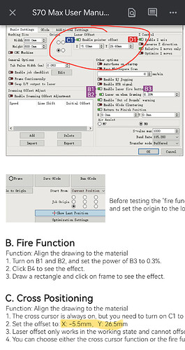

No, I meant something different. It was not criticism about your process. I wanted to say that if the laser has a pointer integrated, the manufacturer should provide the offset values in the manual. So that you don’t have to examine them.
Here is an example from the Sculpfun S70 manual:
Was this not provided for your laser? Or did you mount a self-built pointer? Then it’s a different story :grinning_face:
The Cross Hair was part of the machine when i bought it. There was nothing in the manual for the Atomstack that mentioned anything about how to set Laser Offset
That’s a pity that Atomstack is not able to provide this in the documentation. It’s an important setting.
