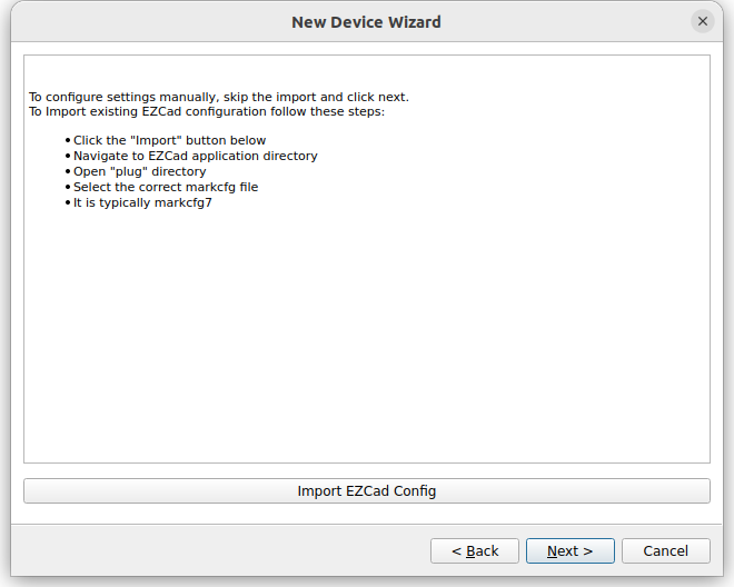

It would be nice if somehow LightBurn could preset properly that parameter when an Atomstack M4 is added.
On my MOPA, these settings are imported from the markcfg7 file. Contains lens correction and i/o settings, at least for the foot switch.
Is there an importation query at the start of creating a device? Have no idea if this is different from a jcz or bsl card.
It also doesn’t mean it’s setup correctly from the factory.
Yes I imported the BslCAD.cfg that came with the machine.
And on their software (SeaApp) it works fine.
