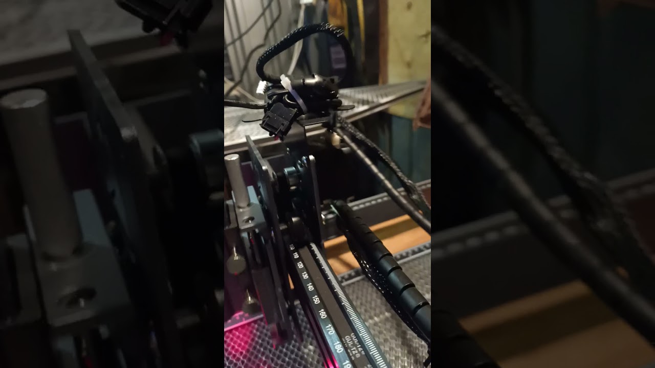

Hello all, My Atomstack fiber MR20 motherboard/ control board come faulty, I have been in chats with aliexpress, atomstack.net and atomstack.com and i’m getting no help on this issue as they will not send me the firmware for this unit. I have tried many other firmware on this system but I can not get power to the motors on the firmware, I have also tried the list below with no luck.

Thanks everyone for you help and input, It turns out the board is faulty here are photos and videos.
The video’s of it not working, on the e85 bed the “Y axis” is not going it jitters sometimes but will not run, also the “X axis” is running rough, due to the faulty control unit.
