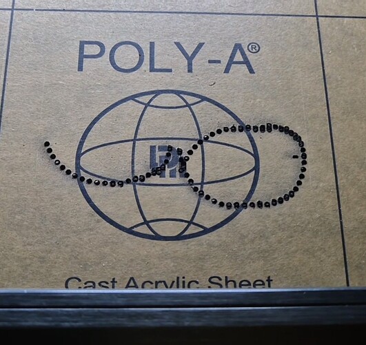

Can anybody please help me to understand why the output on my Atomstack X20 Pro, does not match the input from Lightburn
Input
Output
Gcode

How does it look in the preview window?
What program was this created in?
Appears to have duplicates, but I can’t get them to delete all the duplicates.
Pass count says one but it is making 8 passes.
Someone smarter than me will have to step in.
It looks good in the preview window.
I don’t know what software was used to create the file, but I received it as an SVG
Pass count is set by me in Lightburn (to 8)
Let’s start with a known-good test pattern to isolate any mechanical problems:
Scale it to fit the platform and run it as fast as it will go in Line mode with optimizations turned off and power set to mark a sheet of cardboard.
Upload good photos of the result so we can look over your shoulder.
