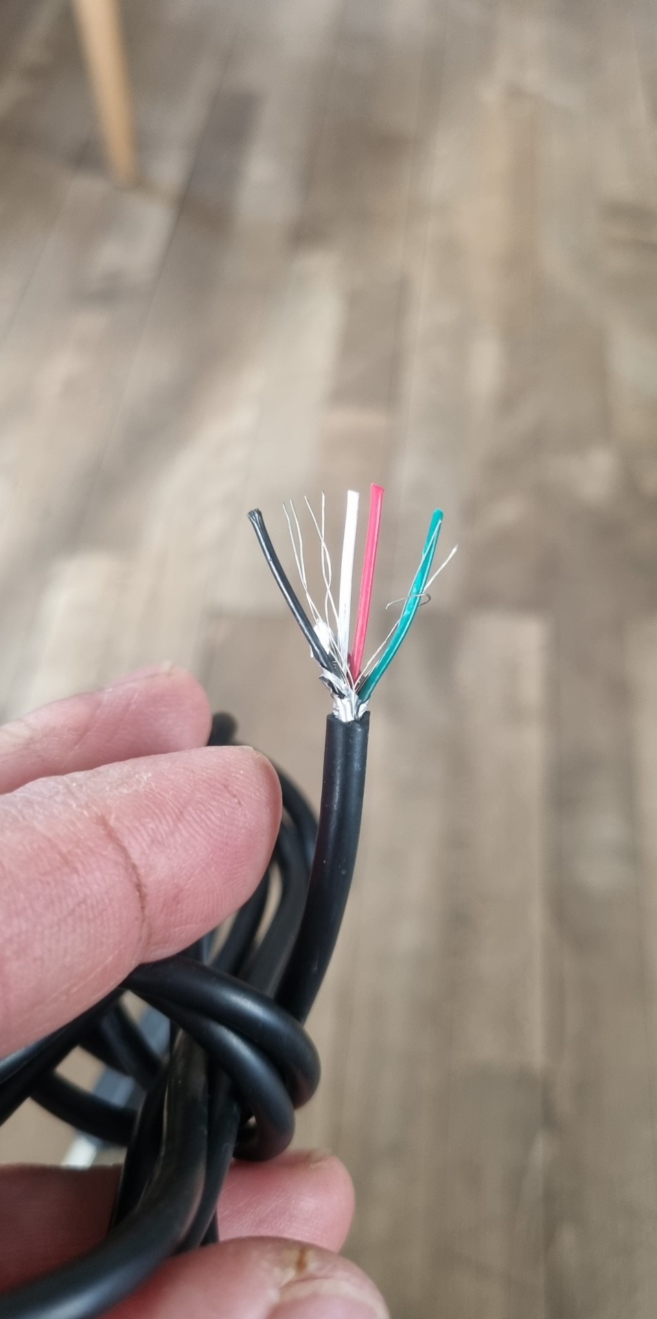

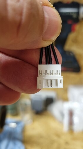

Atomstack R1 with Gweike G2. Order of wire connectiion?
I want to use my Atomstack R1 set with my Gweike G2 once I get it, but have only been able to find very little info on how the rotary-cable has to be connected to the USB-cable.
A cable from a keyboard has white, black, red and green wires.
Anybody have a picture of the correct order in which to connect them to the Atomstack connector?

What I try to do is connect these two. I just need the correct order of the colors
I can’t tell you, but you might be able to sumise what is what.
If you have a working cable, check to see what wires go to which of the two motor coils.
That same pair or coils go to the driver. All you have to go with is two pairs of wires going to two coils or a pair of wires/coil.

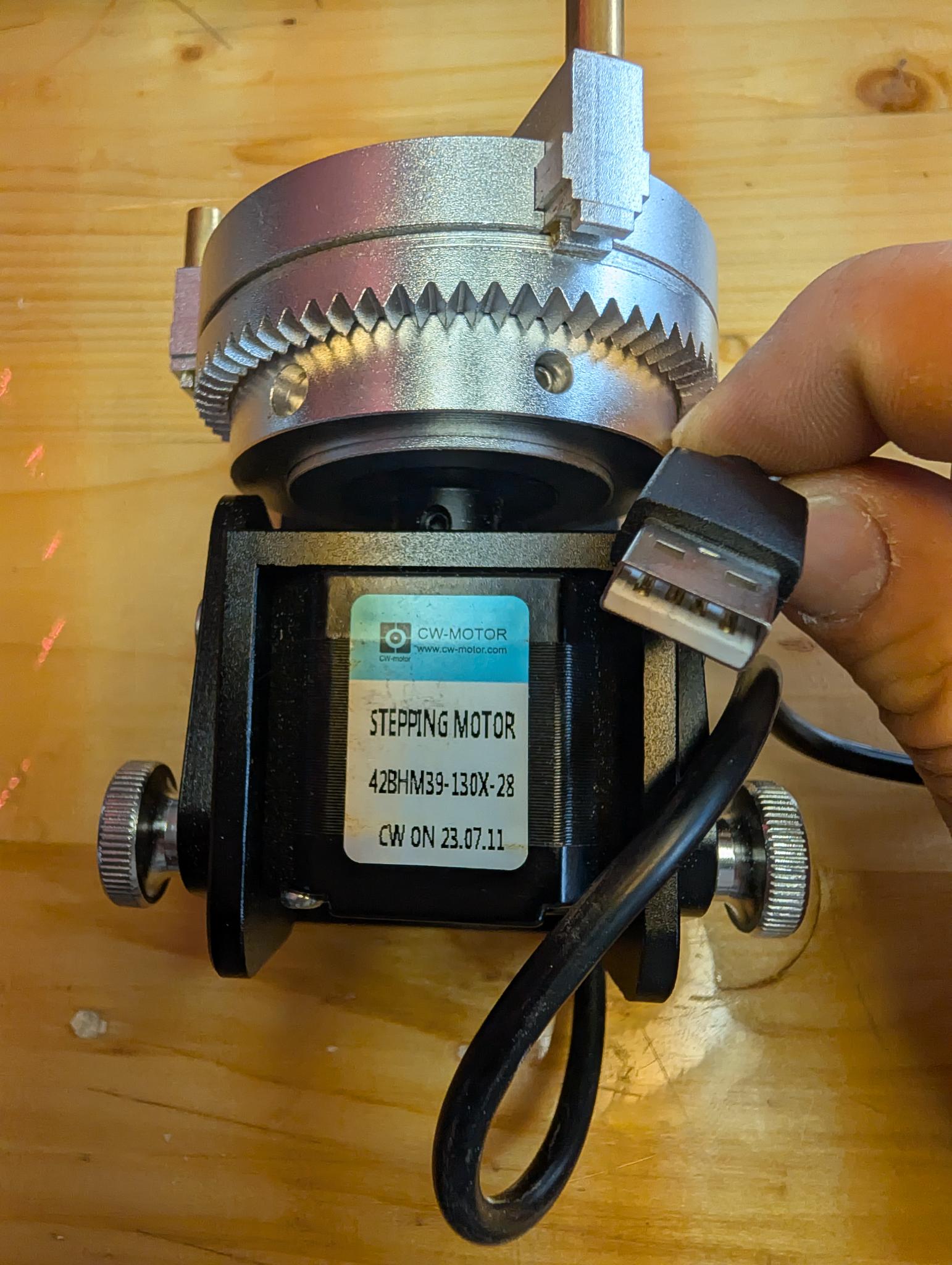

This is the Gweike Chuck that came with the G2 Pro. They made a rather interesting choice for the used connector:
On the USB-A port, I measured the motor windings at 3.2 Ohms going from pin 1-2 and 2-3.

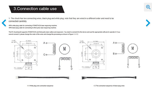

Here’s a screenshot of the Atomstack Manual about the motor windings.
If the motor windings measure the same resistance as the Gweike Chuck, I don’t see a problem. - Please be careful!
These settings work for me with the Gweike Chuck.
The Atomstack has a reduction gear, so you’ll need more “Steps per Rotation”.
What does this use for a connector?
You can see it in the image of the manual I sent. Per posted an image earlier. That’s some kind of Molex connector.

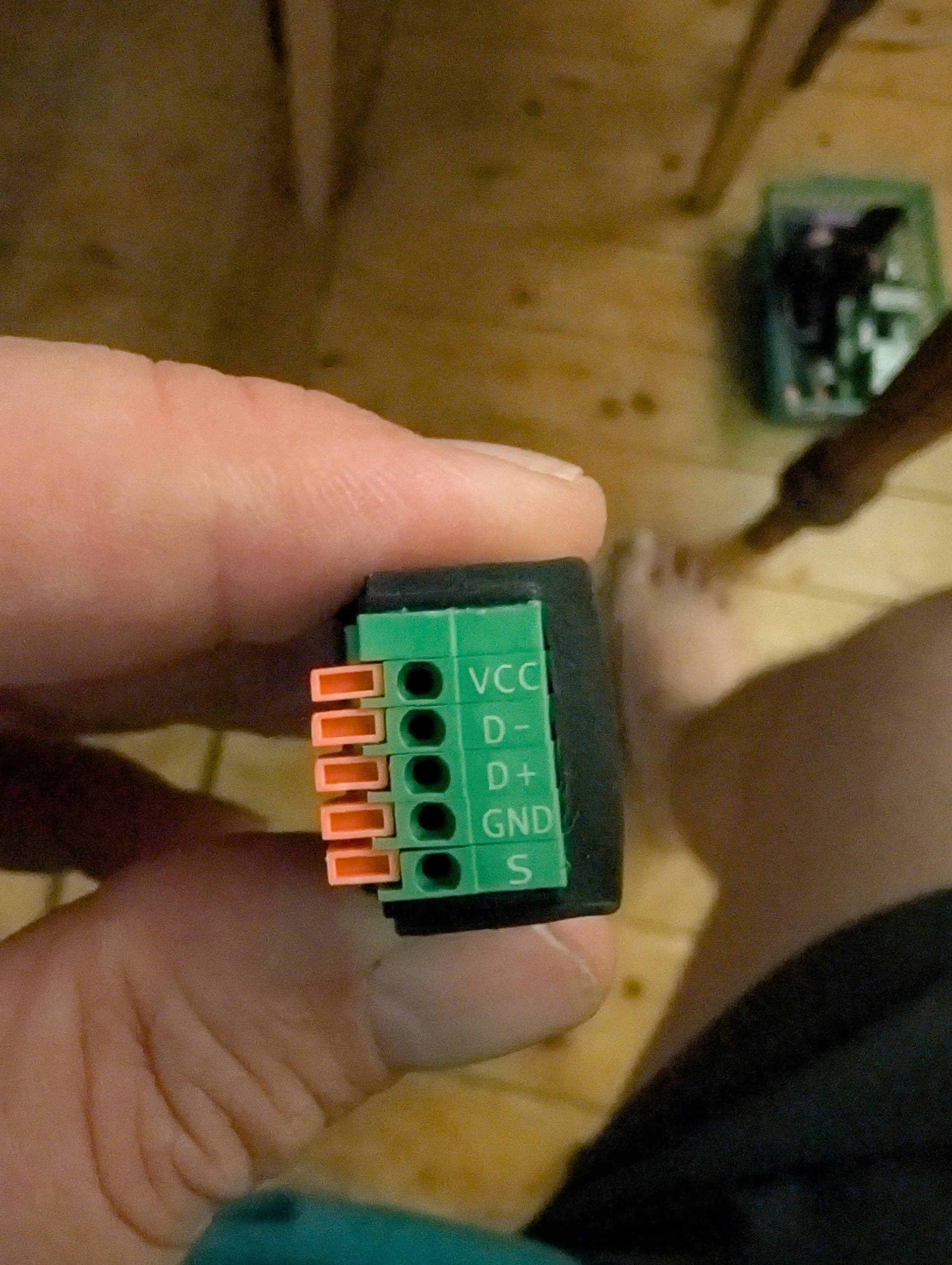

Considering it’s a two phase motor there are only a couple ways to wire it up. I cut up a usb extension and use the connector to make a crossover type, from one connector type to the other.
Ive got it to work.
6450 steps for each rotation seems to be it.
I used the black cable that came with the R1, cut the original connector off, untwisted the twisted wires and screwed a USB A connector on. Now it works as an extension cord for the original white cable that is in the R1.

I got it working by the judicious use of an ohm meter and the wiring diagram in the R1 Pro user manual :slight_smile:
It’s always nice, if you have the manual, to post it for others. If you have it, then they don’t have to chase it down.
You can drop a pdf here if you add the .txt extension to it. I doubt it’s over 4mb.
The other option is a screenshot of the pertinent information from the manual. :black_cat:
It’s already here in this post, courtesy of the OP :slight_smile:

I used a USB breakout cable that I connected to the wires of the black Atomstack cable after cutting off the connector.

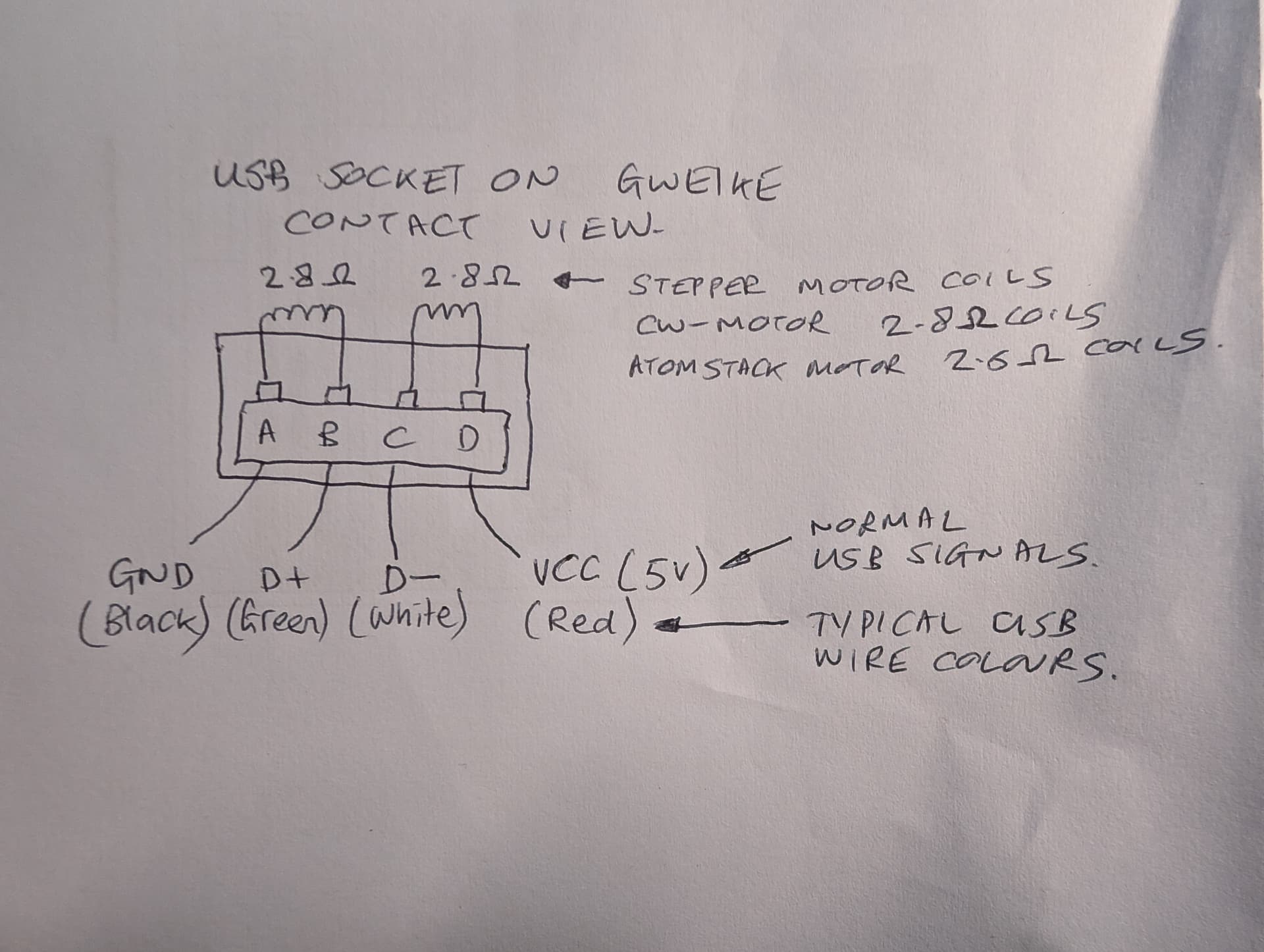

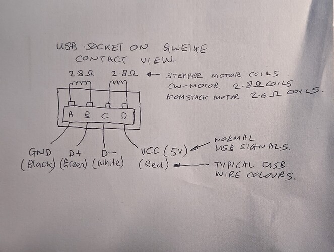

Here’s a diagram of the USB rotary output on the G2.
The Atomstack motor has the same impedance as the Gweike. The TMC2208 V1.0 driver inside the G2 case is driving the Atomstack rotary quite happily.
