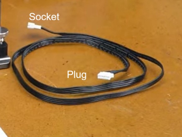

Can you post an image of both ends of the white plug wire? Also include an image of the rotary power connector. The manuals have poor images.

I’ll be near the product later, but I found a YouTube video where they show it: https://www.youtube.com/watch?v=GYs_GYCX6ow. It shows the cables at the 1-minute mark.
That white cable is an extender cable. It has a plug (which goes to the rotary motor) and a socket (where you plug in the cable that goes to the Yaxis motor). You unplug the Yaxis cable from the Yaxis motor and plug it into the socket end of the white extender cable.
Once you get it hooked up, do the Lightburn Rotary Setup as described in the rotary manual.

My Y axis servo is on the front of the machine under the carriage but yours may be in a different place. As mentioned above you don’t connect the R1 Rotary to a USB port but to the Y axis servo motor.

Thank you very much for your help, based on the instructions we were able to connect the machine to the accessory.
