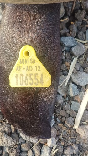

I have attached one sample yellow color and I don’t know if I can mark such thing using my x30 pro machine?
Aluminum…no. A diode laser can remove some coatings to expose the underlying metal, but it won’t reliably mark metals.
The workaround to the above is to use a marking spray such as Cermark or Brilliance. but I’m not sure I’d trust the durability for livestock tagging.
Cold Galvanized Spray works well for metal. Spay on, let dry, engrave, then scrub off with steel wool pad. A lot less expensive than Cermark or Brilliance. Iv also used on ceramic tile

I guess these are not diode laser.
No, those are CO2. You should be able to do the rubber with diode.
