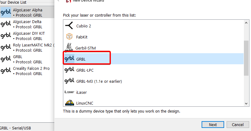

my problem is that when I cut wood my laser power burns at the start of the cut and at the end because I have no minimum power and even if I lower my percentage I would have to make several passes and that extends the cutting time. And where can I know the information of my laser on the support controller like grbl or a Ruida or trocen or marlin etc.
Any chance you set your machine automaticly in “find my laser” and you have GRBL M3 setup instead of GRBL
The edge burning is typical of M3 mode, lacking power control on the decelerations
Go to Edit _> device settings
Take screenshot please?
if I understand correctly I don’t need lightburn dsp for my laser model the few more functions are mainly used for C02 machines
Correct, make just sure you selected GRBL (Top of the list) as your controller and not GRBL M3

so to confirm
Double click your profile > make sure is GRBL top , not m3 or LPC
then EDIT > Device settigns
make sure these match
