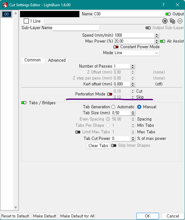

Could you check if the perforation mode is turn on…
Nope, perforation mode is off.

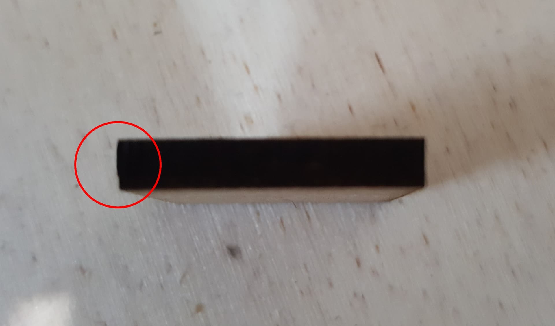

On one side, the laser cuts through and then the beam seems to start angling outwards, the deeper it cuts. I will attach pictures as I am probably not making sense. I don’t know how clear it will be,
but if you look carefully, you can see what I mean.
The issue is only on the one same side, always.
I’m using 3mm mdf which is nothing for a diode machine this powerful, so should not be having these kind of issues.

Both sides have this anomaly which almost appears to be the normal expanding of the beam… I wouldn’t think it would occur over such a short distance. You can change the focus down and see if you find a better focus point.
If my dof (depth of focus)is less than than 1/2 the material cut width, I always focus to the center, sometimes I do it anyway.
I’d try changing the focus point and see if it’s better or worse.
Thinking about it a little more - I agree with JW it has to be the laser module - not the controller. possibly one of the diodes is defective or something is out of alignment [mirrors]. Try what he just recommend and if that does not remedy the issue - call support and/or file a warranty claim.

I have manually focused and used the autofocus, same issue. It is only occurring on one side also, which is confusing to me.
I must be using the wrong drug … doesn’t look square to me…
Lol, not perfect but better than the other side.
It is straight enough around the rest of it that the 3mm thin square can stand on its own. On the side with the weird cut, I can’t get it to stand at all.
But all around, it has a slight slope, yes.
