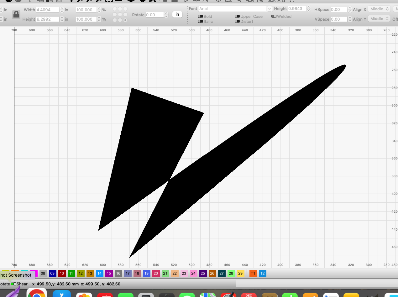

Attempting to close shapes results in very distorted object

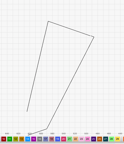

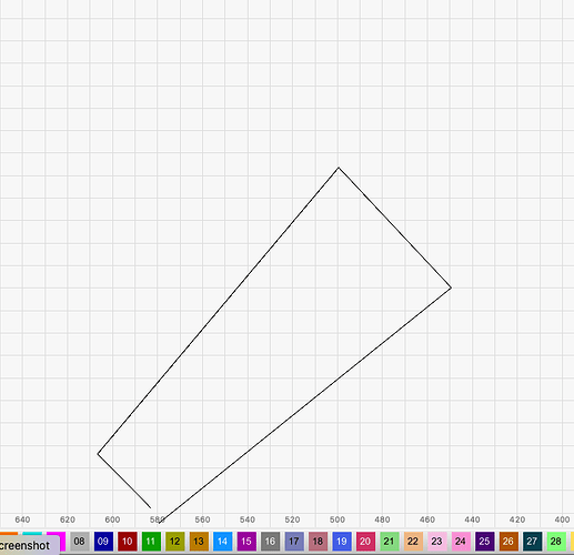

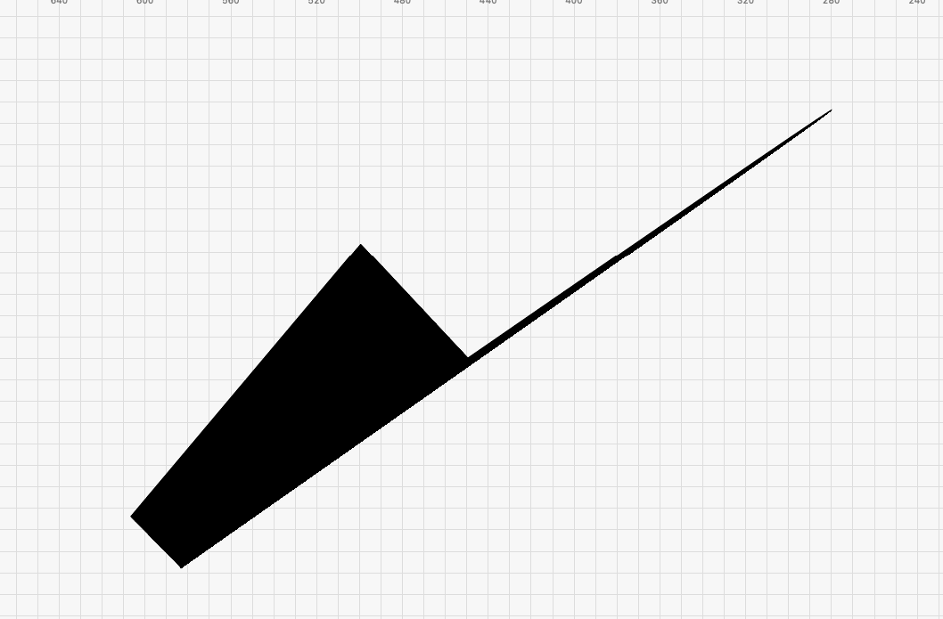

I’m sure this is just some type of box that is checked or a value that is out of whack. When I try to make a shape, 4 sided in this instance and try to close the shape with the last line, it throws the shape completely out of whack as if I were using an elipse command or something. I will post the before picture outline as I’m about to drop the last point on top of the first one and the second picture is the result.

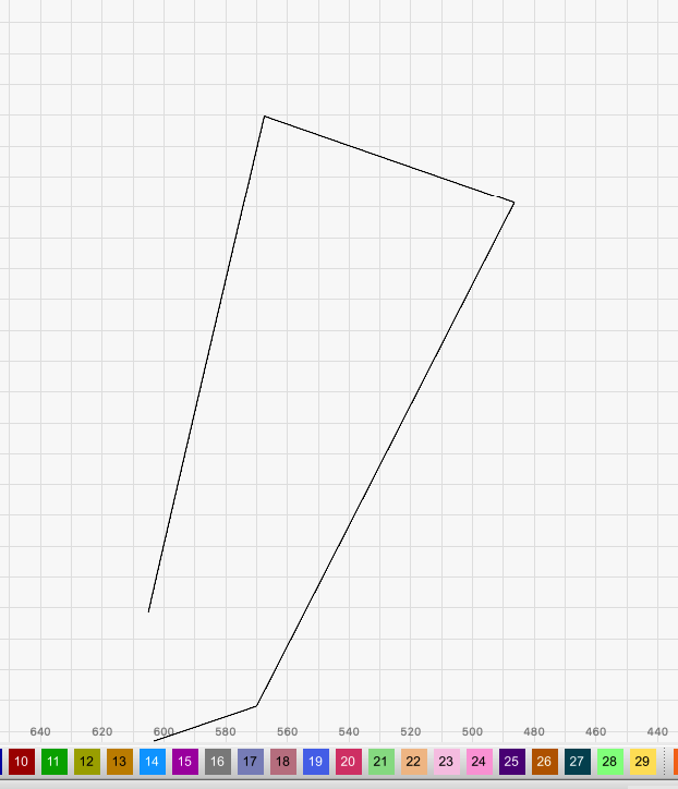

Here’s an additional set
it looks like at least one of the lines is defined as a curve.

If that doesn’t work, can you upload a .lbrn file in a state immediately prior to closing the shape?
I was very careful not to switch to a curve when using the line tool, it does it automatically.
Sorry, what is mean by this?
Get it to where there are 4 sides but not yet closed.
What version of LightBurn are you using?
Like this?
Or try and save with three lines while the 4th one is ready to be connected?
Just as you have it is perfect.

I’m looking for straight edge shapes. I just want to understand why this is happening. It’s never happened before.

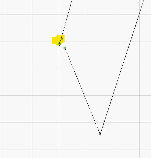

If you look at the shape in Node Edits tool you can see that the line is actually a curve.
I assume this is the starting node. Make sure you’re not dragging the first node when starting the line.
In that case “L” in node edit is your friend.
I don’t understand how. No matter what I do then it does this. My clicks are momentary. I can do this all day long and it’s the same result. This is a glitch, but I feel like it isn’t happening for anyone else… which doesn’t make sense.

Confirm that the first line is being created as a curve even in 1.4.05.
I definitely single clicked, moved to set its endpoint, then continued to do the three remaining lines without closing the final line to beginning point.
Backed out, went into edit node mode and could see the first line was created as a curve.
Curve as first line.lbrn2 (6.0 KB)

If that were the case of double clicking, wouldn’t we be seeing a second node somewhere near the beginning node? I just did it again and got the same result. Look at this file and zoom into the circle area where the unclosed four line object is at.
Select Edit Node mode and you’ll definitely see the vector adjusting extension present at the first node.

I’ve tried this multiple ways across multiple input devices without issue. Even installed 1.4.05 to confirm and don’t have an issue there either.
What are you using for input? Do you have another input device you could try?
Not that I’m aware of. At least not within LightBurn. There may be something at the OS level that affects click timing or sticky clicking. Do you possibility have any accessibility features enabled?

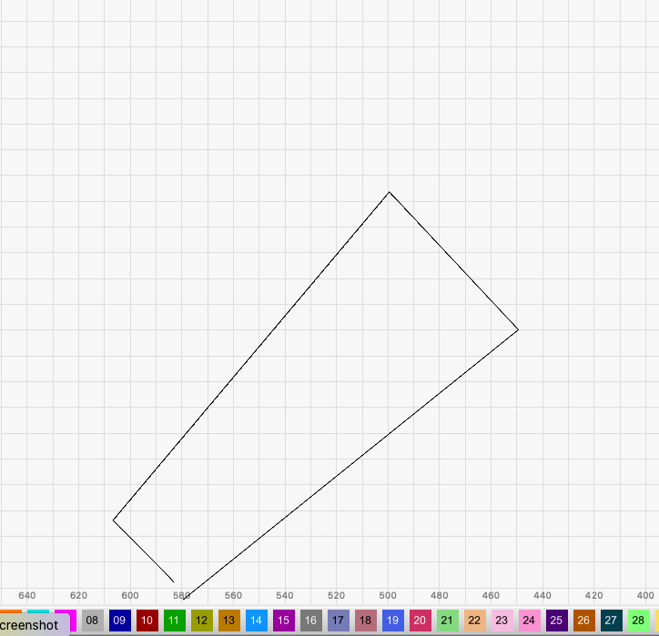

This one is interesting as not only the first line but also the second line are curves. This suggests either a hardware issue or process issue. Are you making very sure to not move while clicking?
Never thought to do that, but I think I can rule it out because it always does it on the very last click only.

In more testing, if I move very rapidly point to point I can get this to occur but I’m fairly certain that I’m slightly moving during the click. More deliberate movement and clicking eliminates that in my case.
So you are seeing what I am seeing then. It’s not just me, this is a Lightburn glitch.
Are you running galvo version by chance? If so and the other guys are not, that is the issue right there…correct?
