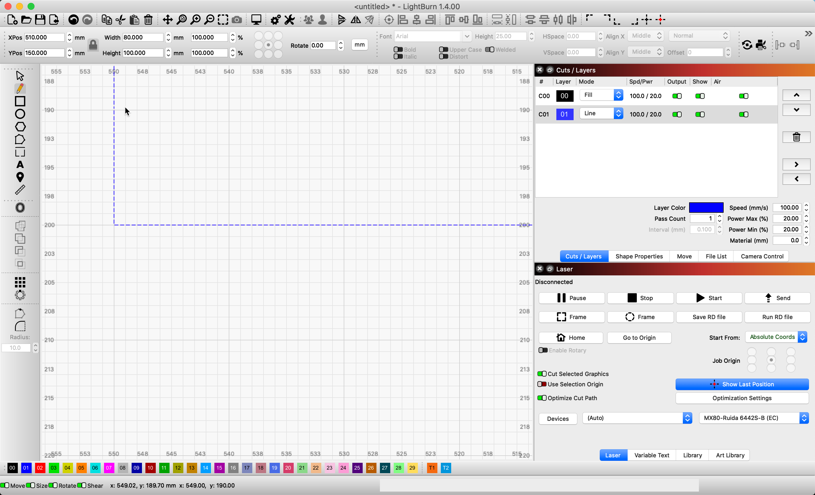

i have this situation for example and i want to connect the lines…
Here, I share a few options available to accomplish this.
(click images to view larger version)

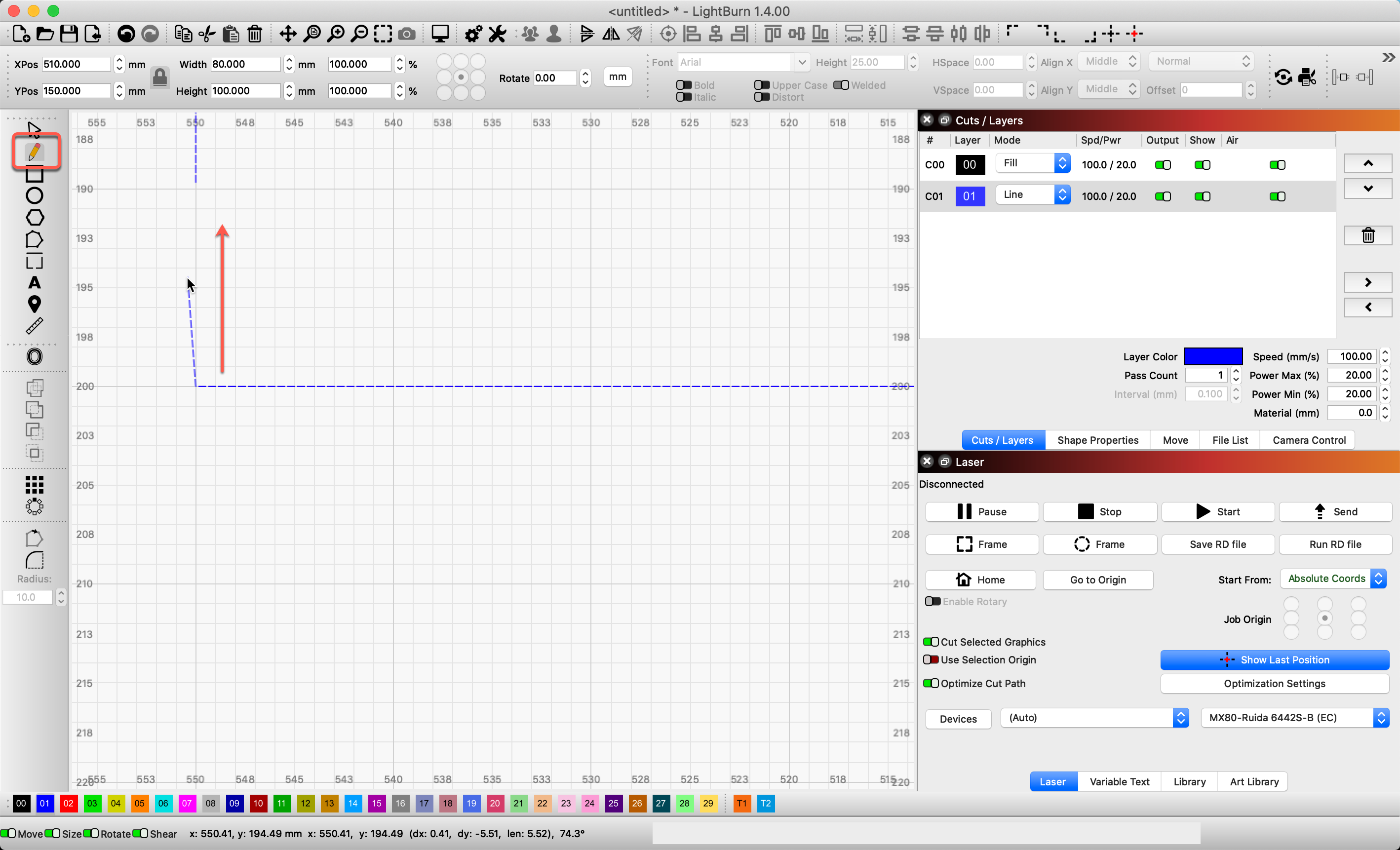

Draw connecting segment using ‘Pen / Draw Lines’ tool

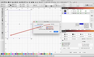

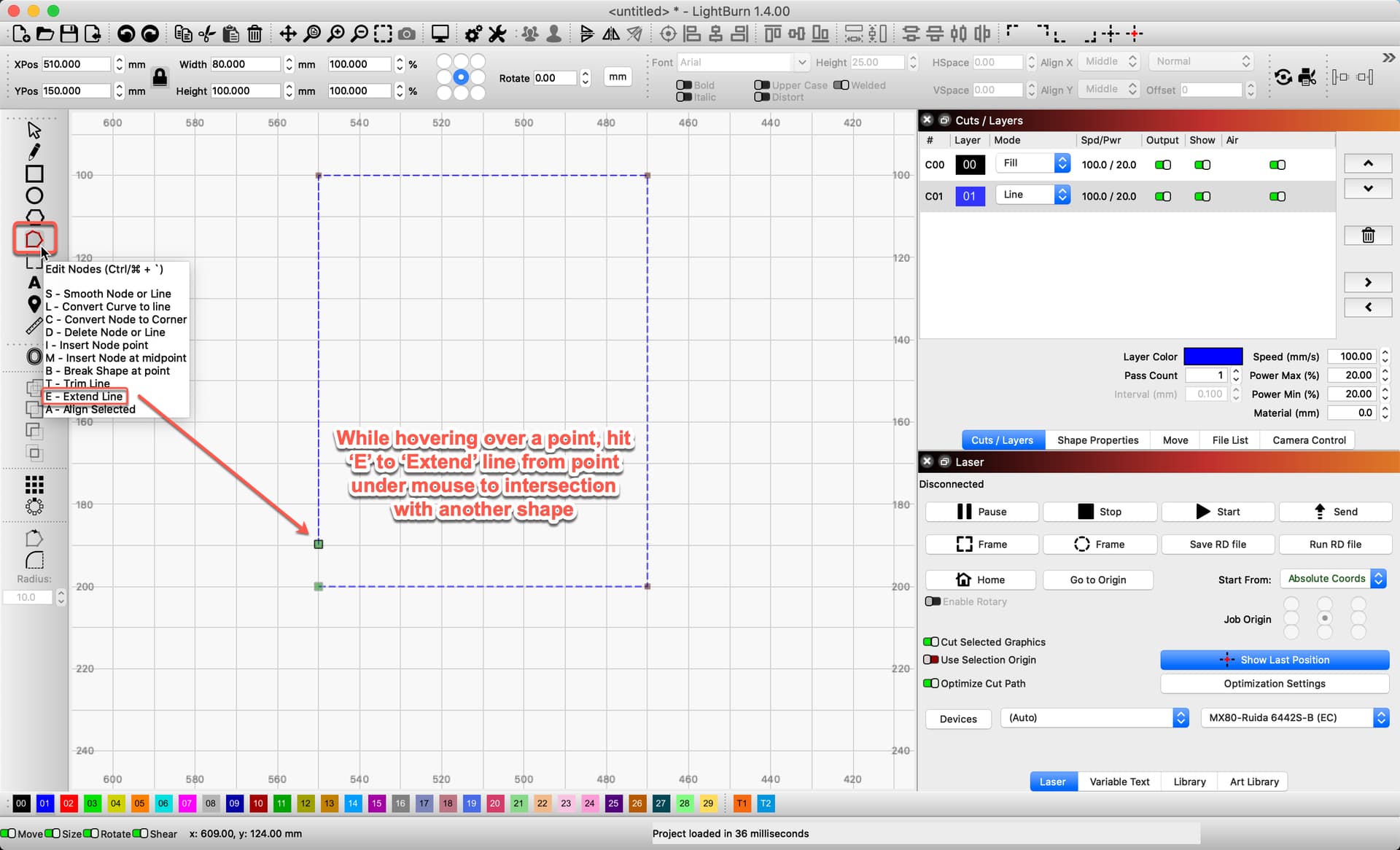

- -‘Node Edit’ tool ‘Extend’

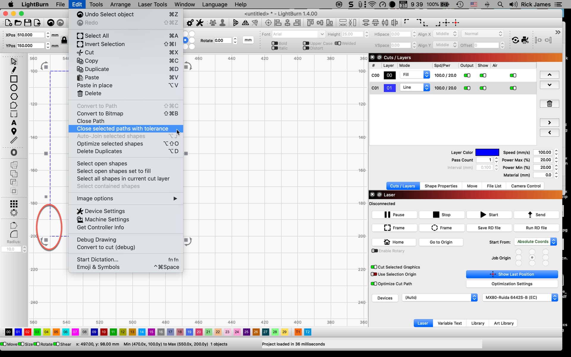

‘Close selected paths with tolerance’
